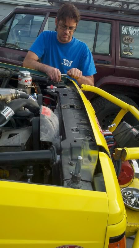

Not much energy to write, but James and I tore back into the car today. Starting to clean up a lot of the OEM wiring we left in place racing to the starting line last year. Today we deleted anything that goes through the OEM steering column so we can replace it with a race column.. a little slow doing wiring while James has a broken hand, so we're picking it up again the week after next with intent to delete the factory fuse block completely.

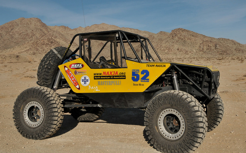

There have been three Team Naxja rigs.
The original 52, Goatmans unlimited class buggy.
KOH 2008, 7th place

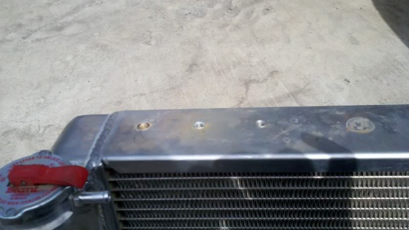

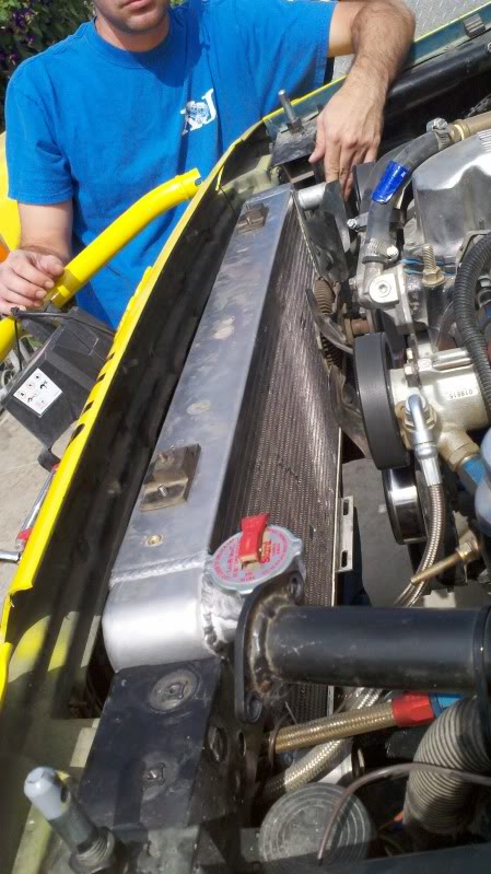

There seems to be a lot of questions about fitting the 'big' Griffon radiator. I'm skipping right into the meat of this.

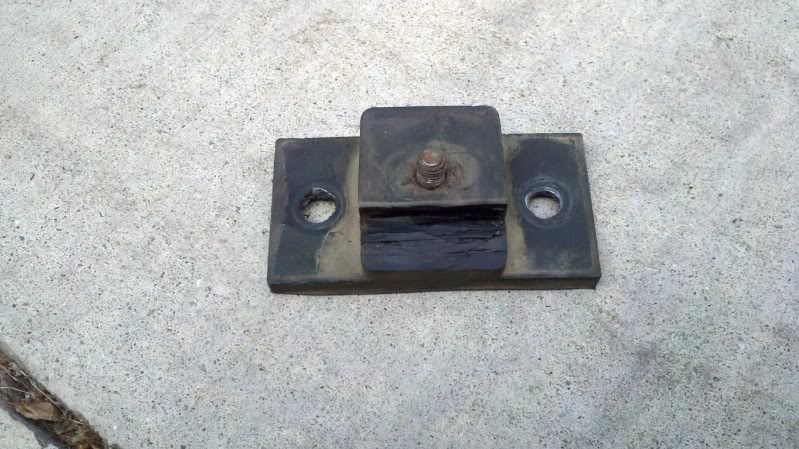

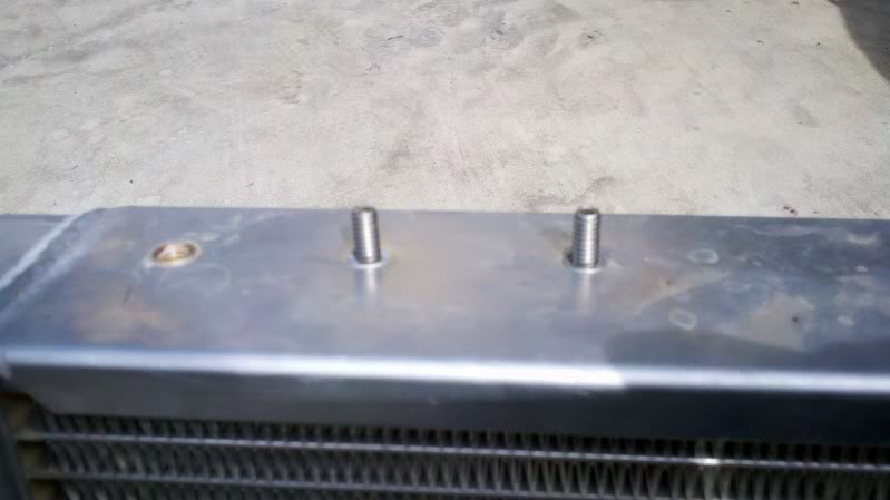

The radiator has a studs that screw into the stop to mount the factory mount pads. There are two locations to mount it in, one fits the XJ, I'm assuming the other is for another vehicle.

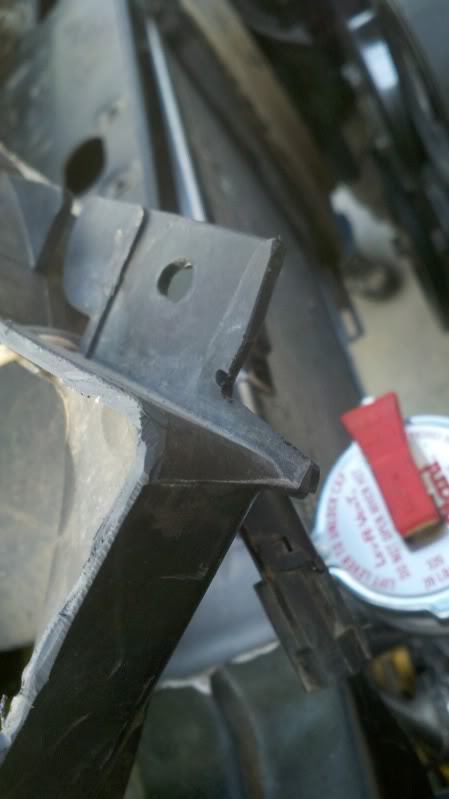

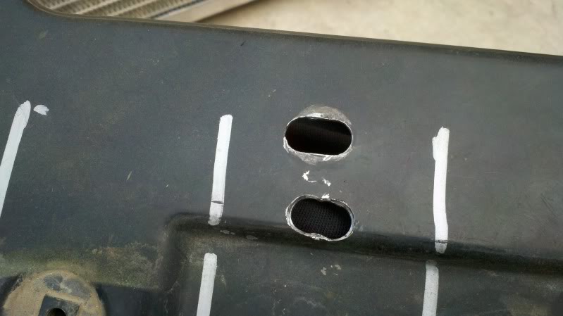

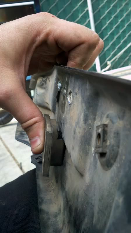

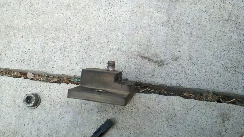

From the factory mount hole on the crossmember, we moved the top of the radiator forward just about 1" - to the very edge of the lip.
Then cut the mounting pads to fit the notch in the core support.

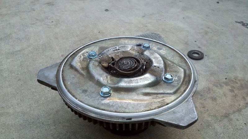

We had fears that our fan clutch was bad, so I bought a new one. The new one turned out to be a lot thicker than the one we had and didnt fit with our mounting..
Not my photo, but this shows the difference:
A little research and LungHD's site showed me his Fan Clutch Eliminator kit...

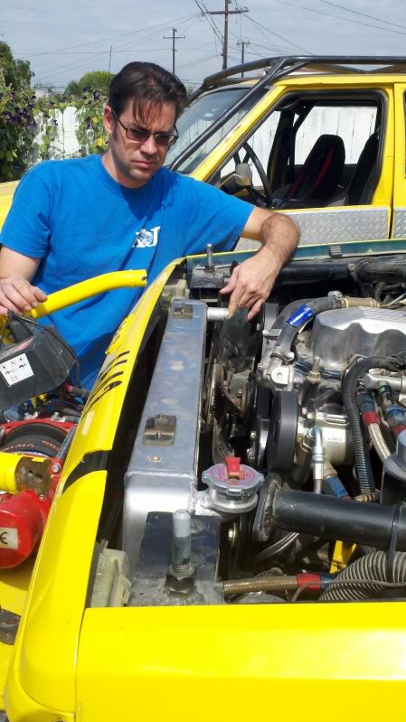

Test fit the core support:

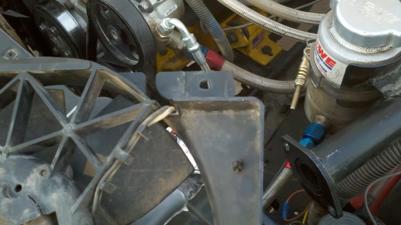

The radiator is thicker, so I had to notch the electric fan a little to make it fit right, but I am pleased with the results.

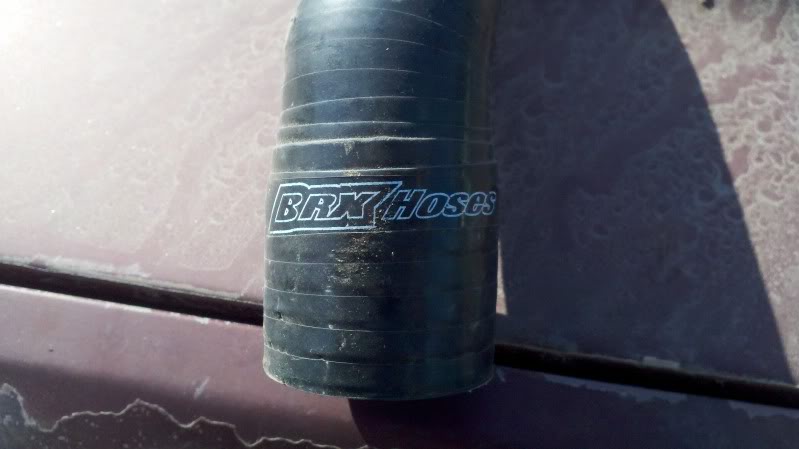

Re-assembled the system. Install new BRX silicon radiator hoses wrapped in silicon tape.

I'll get post install photos later. You wouldnt know the install is not factory. it was time consuming - a little more than a day (mostly because of the fan clutch), but it WAS NOT DIFFICULT - just a lot of attention to detail.
