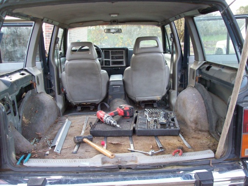

I'd love to know how to do this when you get around to it. If anyone else has fotos, let's see 'em. That might solve my shoulder harness a bit further down the road. First up is this tether point for me though.
I've had the trim out before, and I do remember the holes being there now that I see your fotos. I guess I might see if I can find an XJ @ a junkyard around here. Last few times I went looking for one they were MIA. Used to be a ton though...At least that way maybe I can pull an old one and see the other holes you were talking about.

Here are those pictures I promised you.
