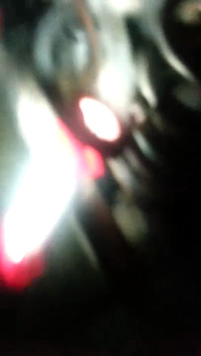

Who knows their stuff about lockrights?
This sucker refuses to unlock. Breaks pins as soon as you drive 5 feet with the wheels turned in either direction. I'm thinking the holes for the pins are no longer round enough to work properly.
Yes, it's installed correctly. Lock Right says there should be no more than .020" between the spacer and the center pin. I'm measuring .025". Ya think .005" would make that big of a difference?
Here's a short video showing the slop in the pins. That's gotta be the issue...
I hate these damn things.
Did you install the original side gear shims?
Yes. According to Lock Rights installation book there should be between .005 and .020" between the spacer and the center pin on either side with no more than .008" difference. It measures .025" on both sides but the center pin seems to have a small amount of play in the carrier. (Maybe .003")
That would lower the measurement I took down to around .022 on either side.
That air gap looks too big to me but its hard to tell without touching the diff.
Lock Right doesn't specify any particular measurement between the two inside plates. But, you're right, it looks like too much gap in the middle.
This locker was in this Jeep when we acquired it. The locker was working fine. We took the Jeep out and broke the pins playing on a hill climb. Pulled the pins and replaced with new pins. Once the new pins were in he took it for a drive around the yard in 2wd. Broke the pins in 2wd on flat ground while turning... We've replaced the pins again and this is where it sits now in the video.
With it installed just like it is now the locker WILL NOT unlock. It will not ratchet, click, slip, whatever you want to call it. This sucker is locked in place. When you turn the tire the pins seem to move too much in the holes and put the locker in a bind and not let it slip. (At least that appears to be the issue to me)
Done rambling now.

Have you checked the springs? If the springs are binding up they wont disengage/engage. Also you shouldnt be breaking the pins just driving around it locked or not. There shouldnt be a load on the pins, or atleast very much load. Sounds to me like its stuck halfway engaged and disengaged. To me sounds like the springs might be the issue. hope this helps a little bit.
The springs are brand new as well. It's fully engaged all the time and won't disengage.
