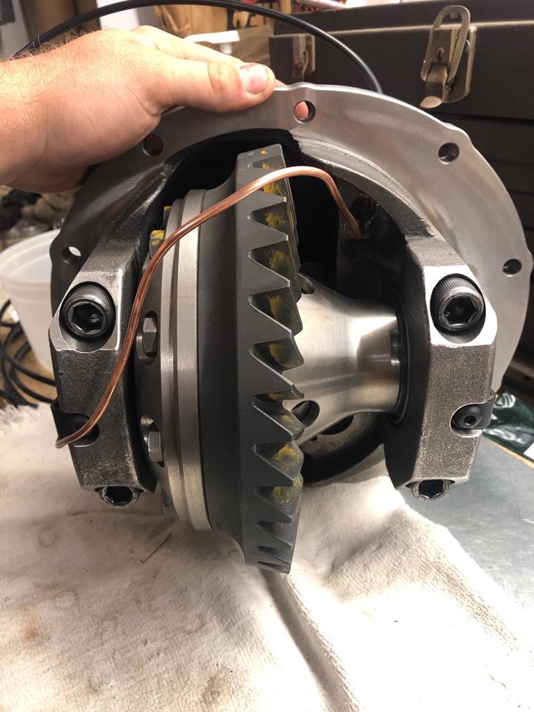

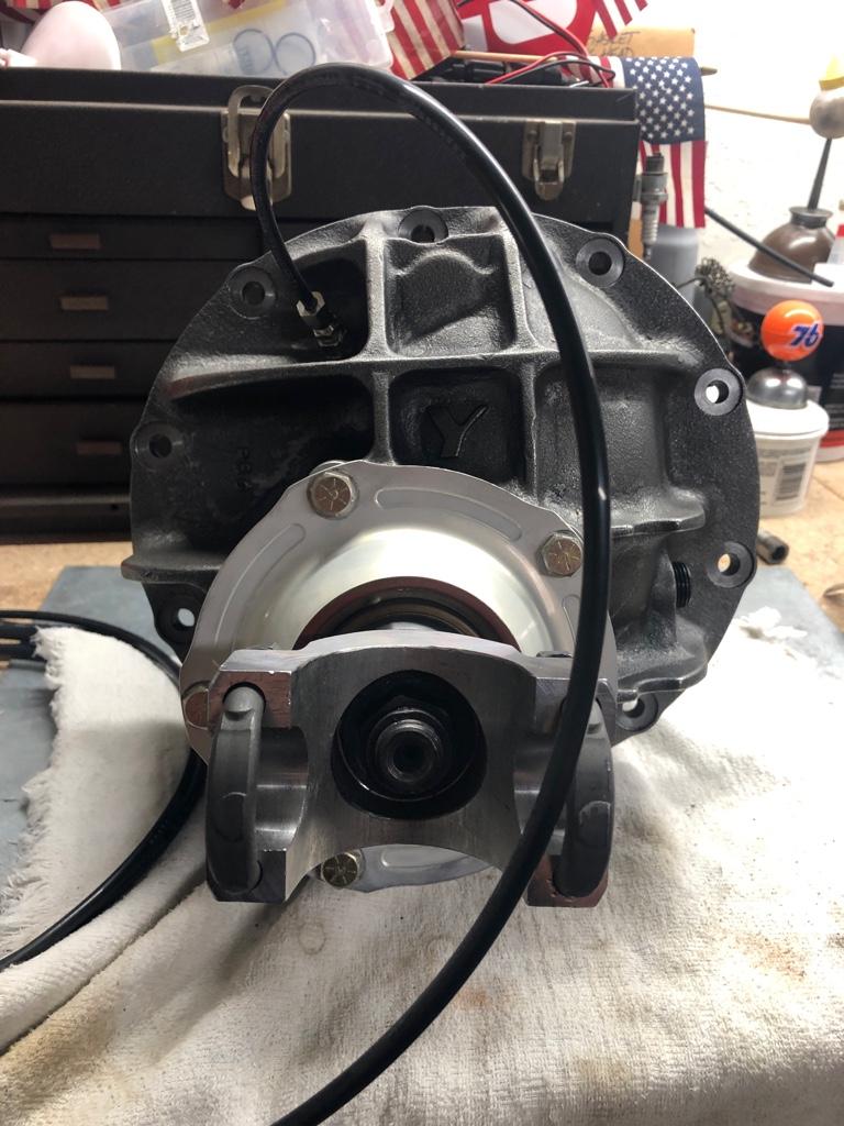

I met up with some friends this weekend and picked up the 3rd member on the Reno Run this last weekend. My buddy did a killer job getting the Yukon 3rd, ARB, and 5.13 gears set up.
It’s gonna be hotter than a hoochie cooch for most of this week so hopefully I’ll find time to get the diff in the housing.

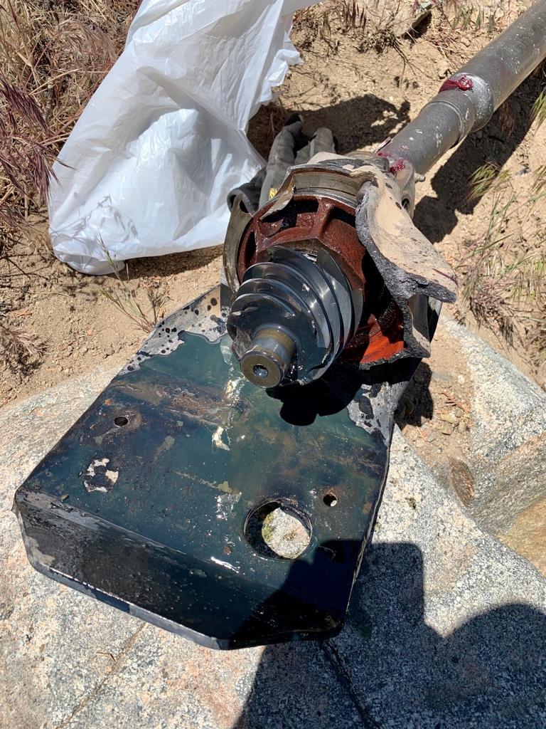

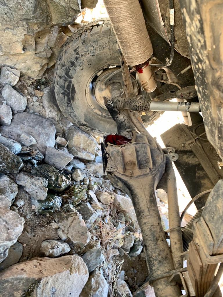

Hope it last longer than this one did on its first time out.
Ouch! Did he come down on a rock?
Gordo who was this? I saw photos of this over the weekend.

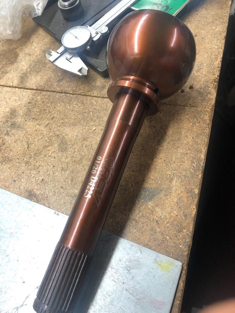

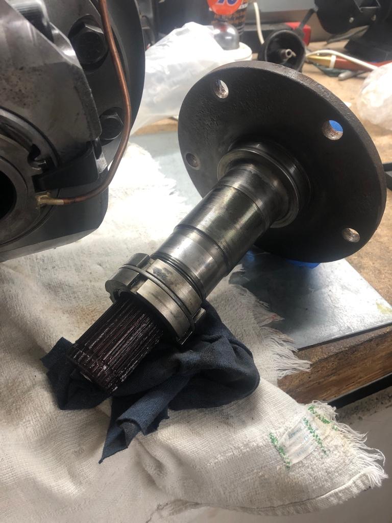

Haven’t had anything really going on over the last few week until yesterday. Front shafts for the 44 showed up but the locker is still back ordered. I was relieved when I found out the 30spline stub shafts fit through the spindles. Sick.

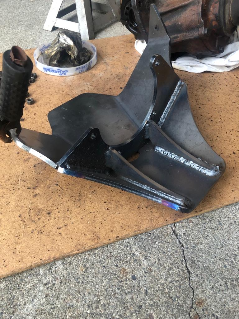

I got started on a diy skid plate kit for the 9”, pretty stoked on how it came out. Also drilled and welded a fill bung. Now that the skid plate is done I’ll work on a drain bung.
