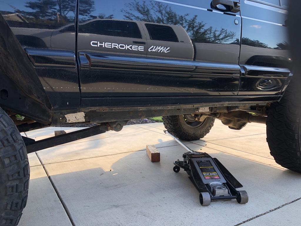

Looking back, I would like to get one more on each side. I thought I’d only have enough material for two on each side but I might have enough for another.
I know i am heavy handed on my rockers so im shooting for four a side. But not everyone drives as bad as i do. Haha.

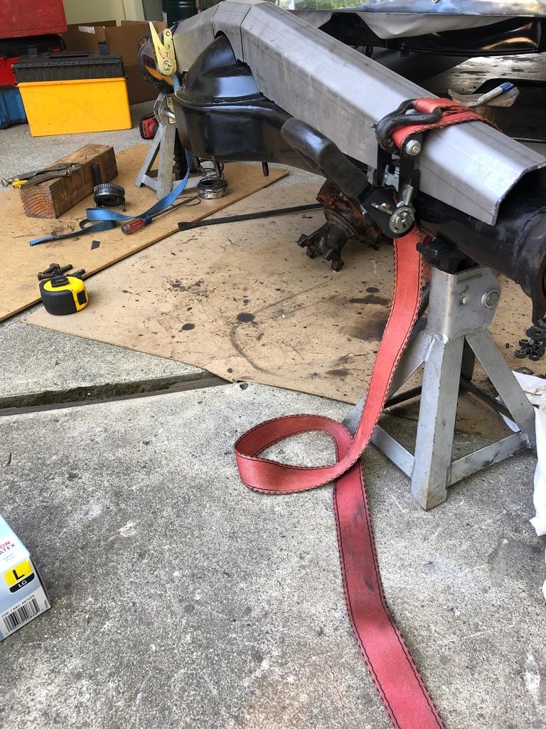

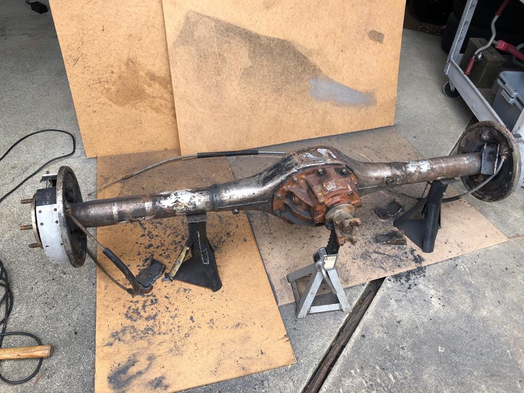

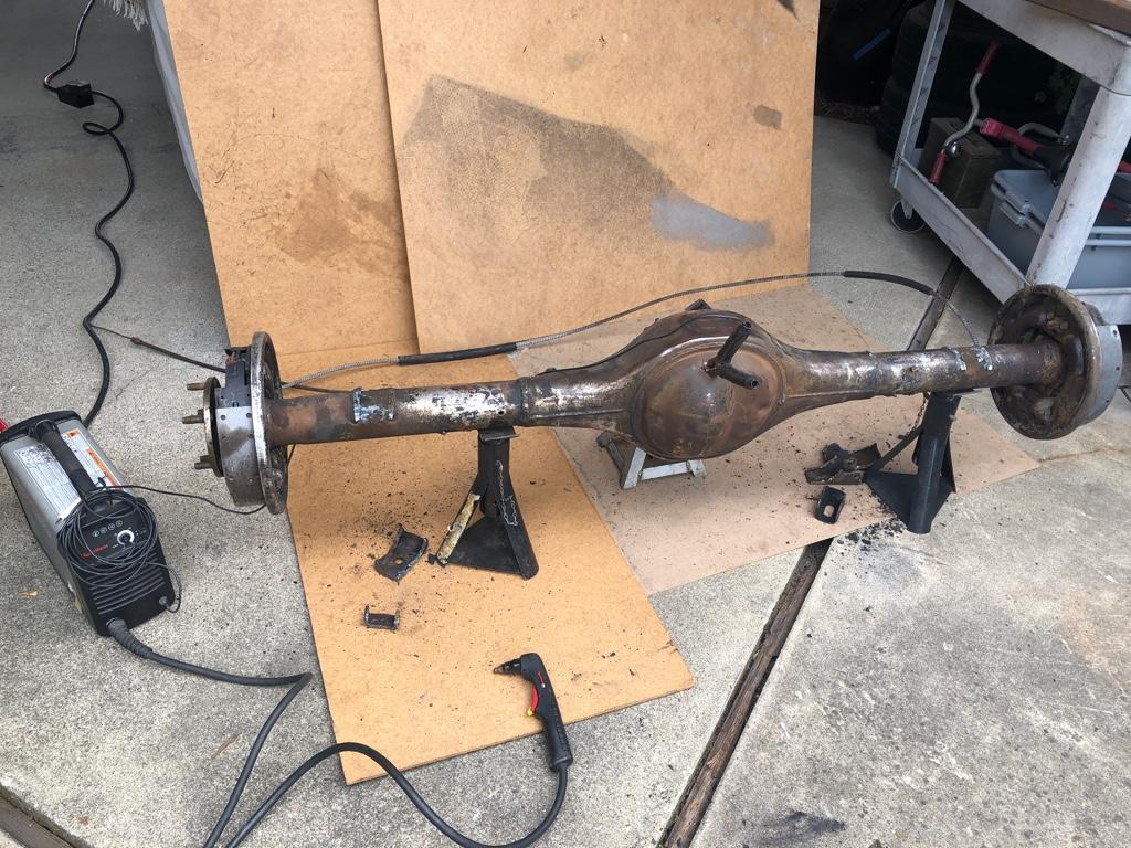

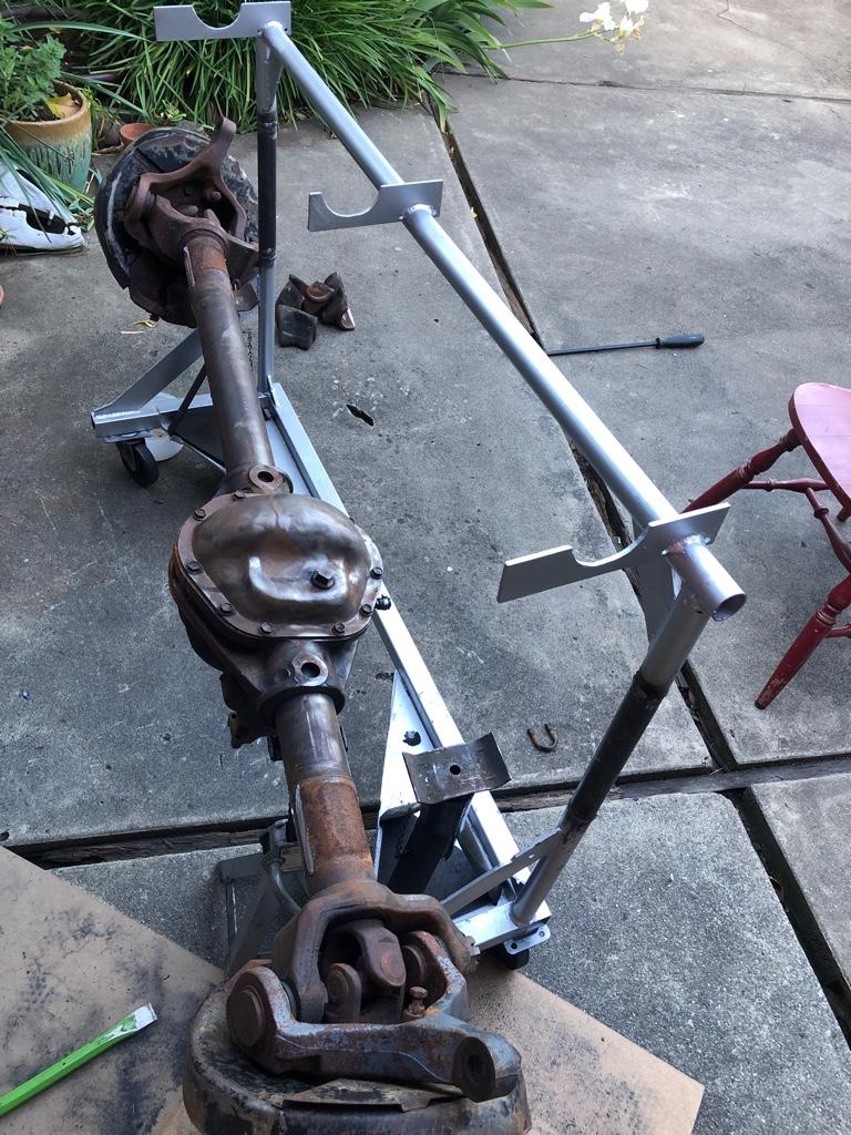

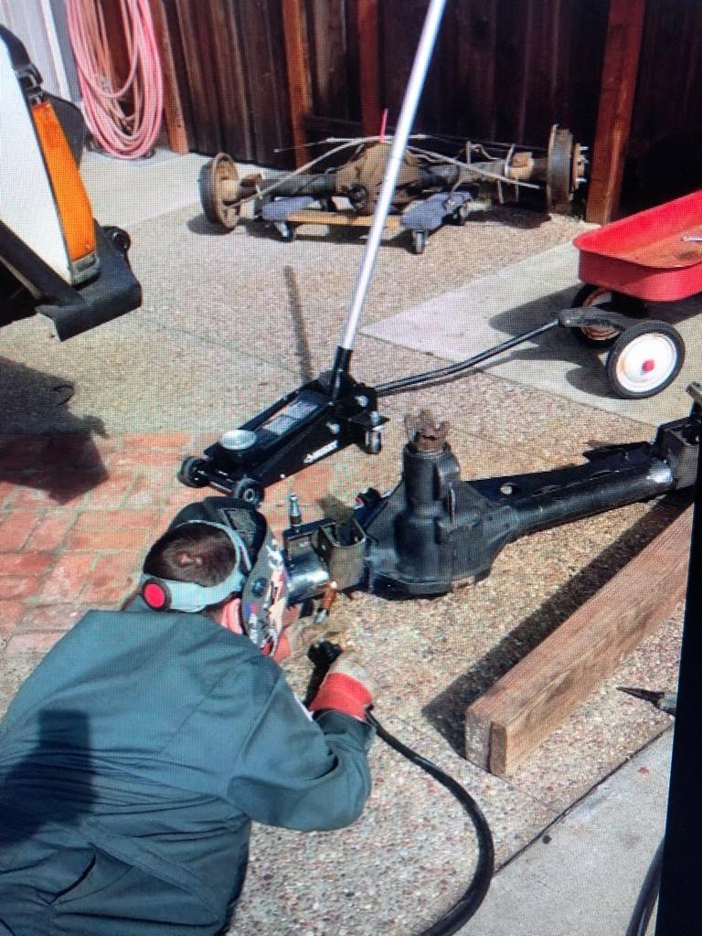

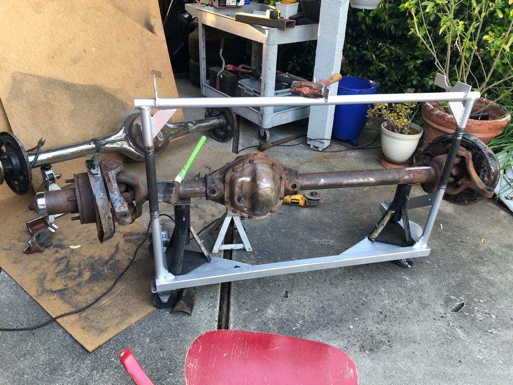

Live update: got the rear in the backyard and the top rack of the stand isn’t quite tall enough for both housings to fit. Busted out the plasma and death wheel to get the 9” nakey nakey
As for the stand, I’ll have to chop it and make the top rack higher. Oh well
take some square tube and flat plate and build a small stand for the lower axle mount vs raising the upper mount.

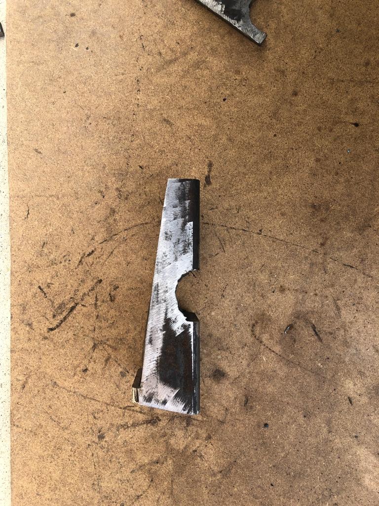

I think I see what you mean Casey. In the mean time, the wedges are off 44. Still got some grinding to do

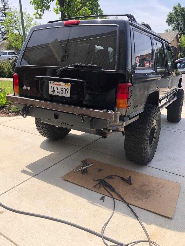

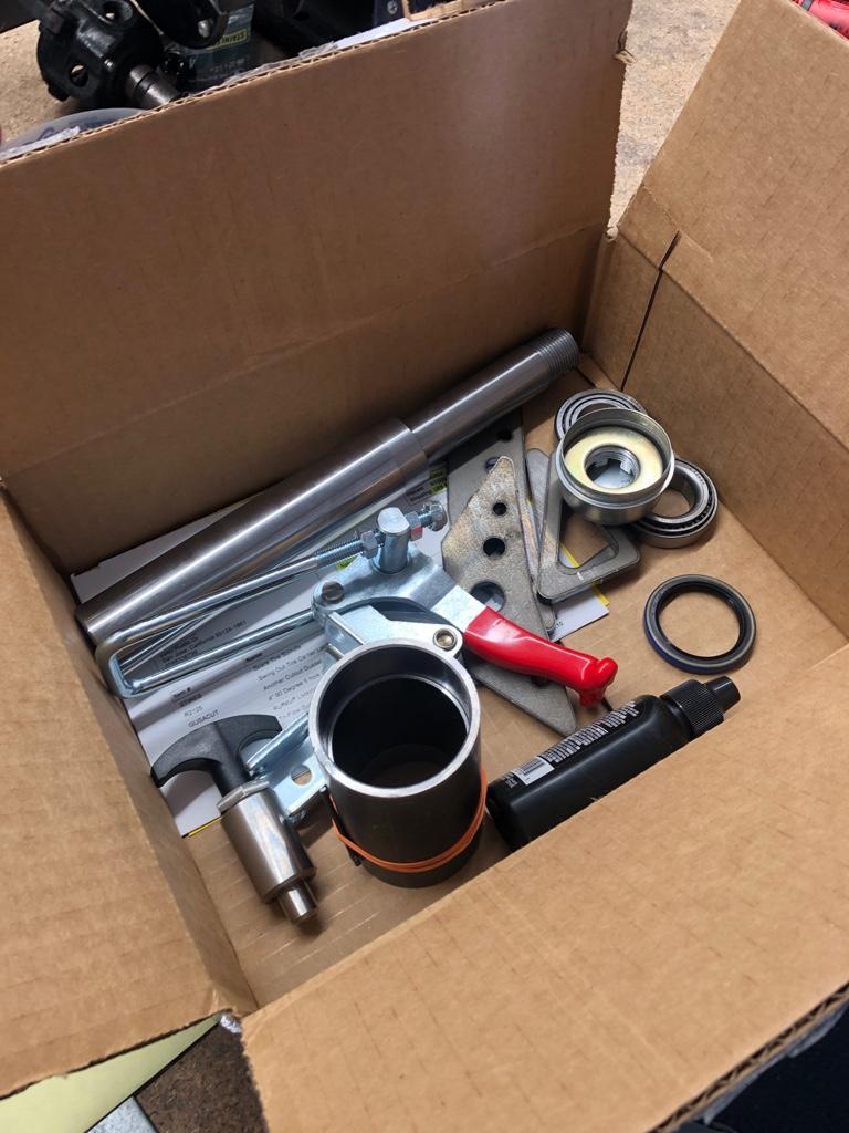

In the mean time, a package arrived from ruffstuff full of tire carrier swing out parts so I’ve been working on that for the past three days or so.
I picked up 13’ of 3/16” wall 2x3 rectangle tube from a local-ish metal supply. I’ve been wanting to hit sims in San Jose but they’re closed to the public with the covid-19 scare.

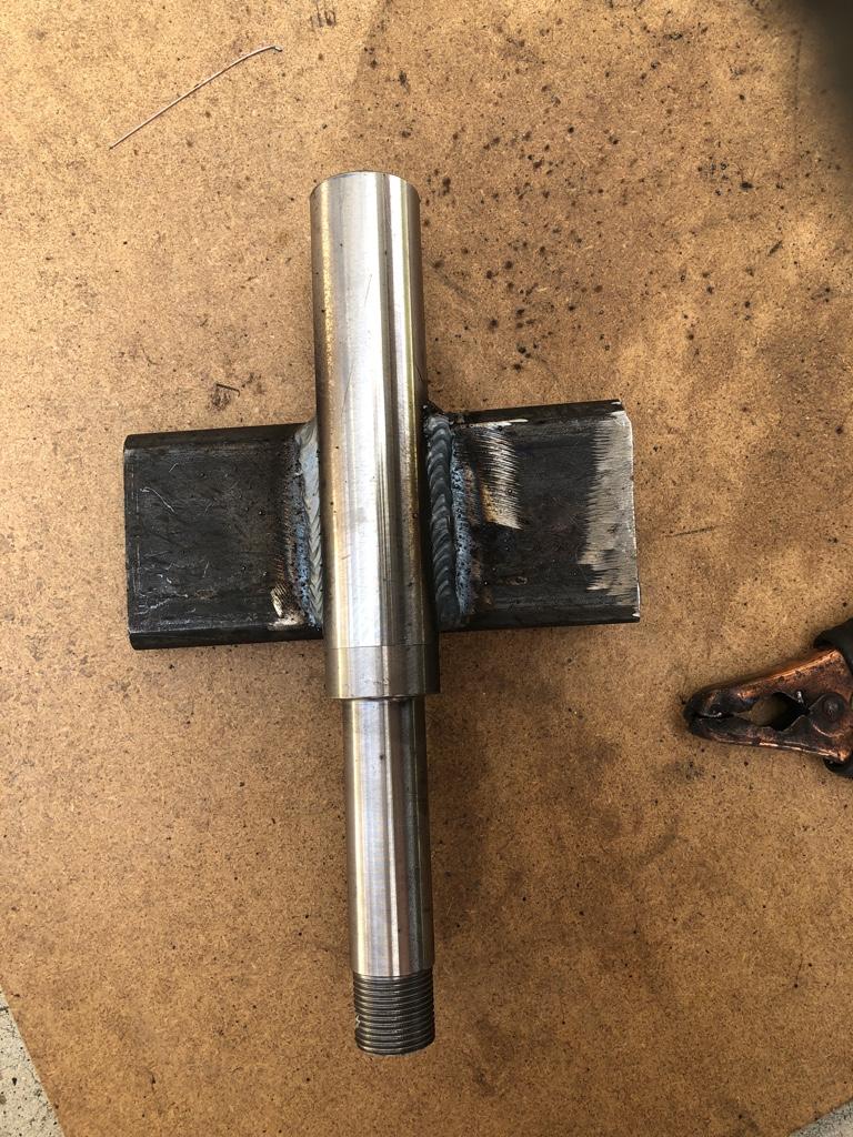

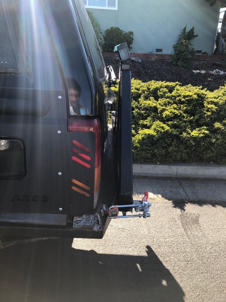

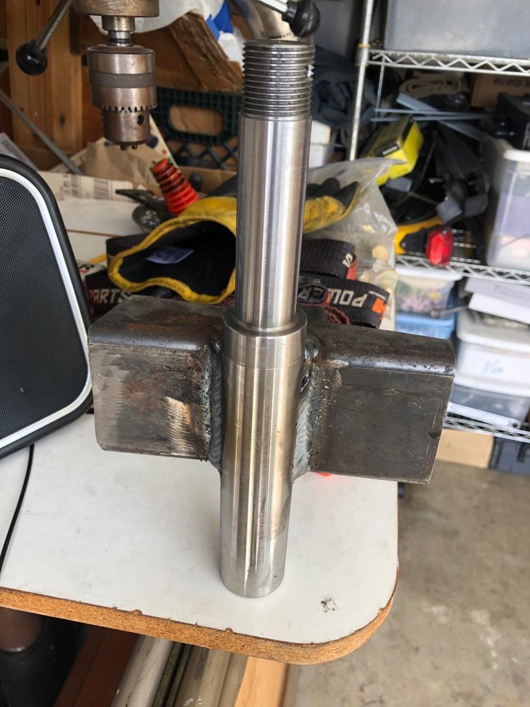

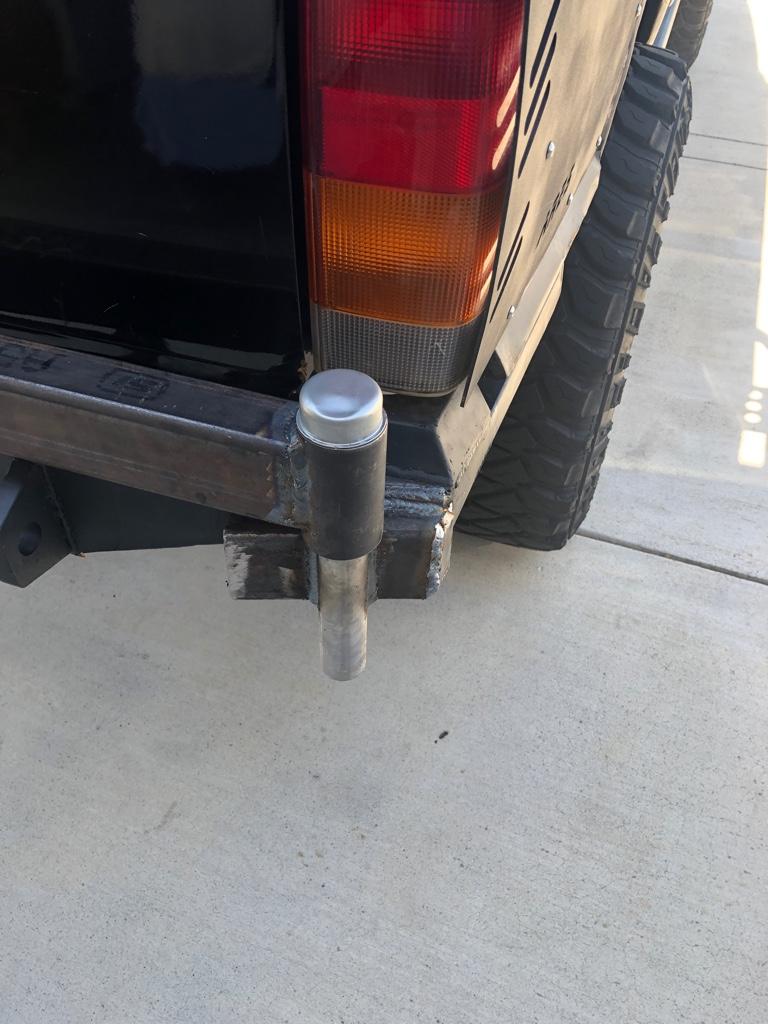

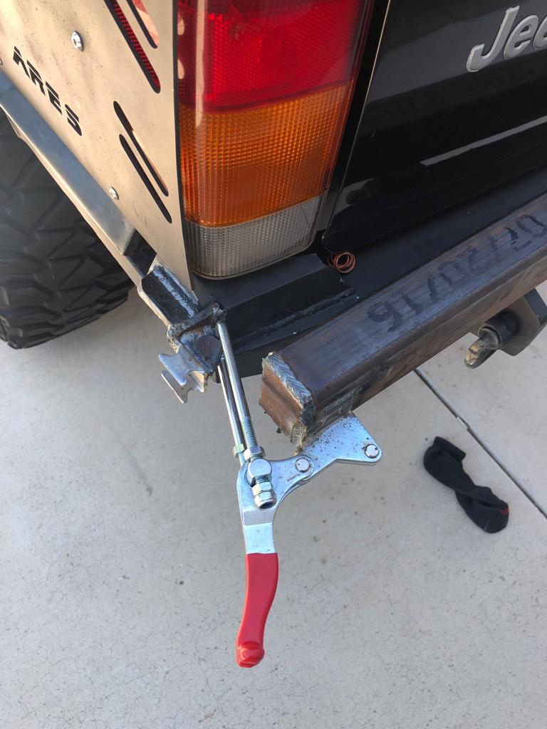

My bumper doesn’t leave much room to support a spindle so I added some plate and will need some bracing behind the bumper. Here’s what I did.

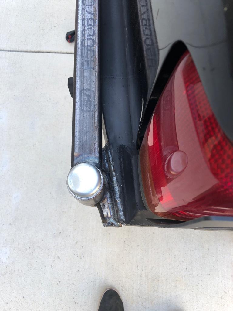

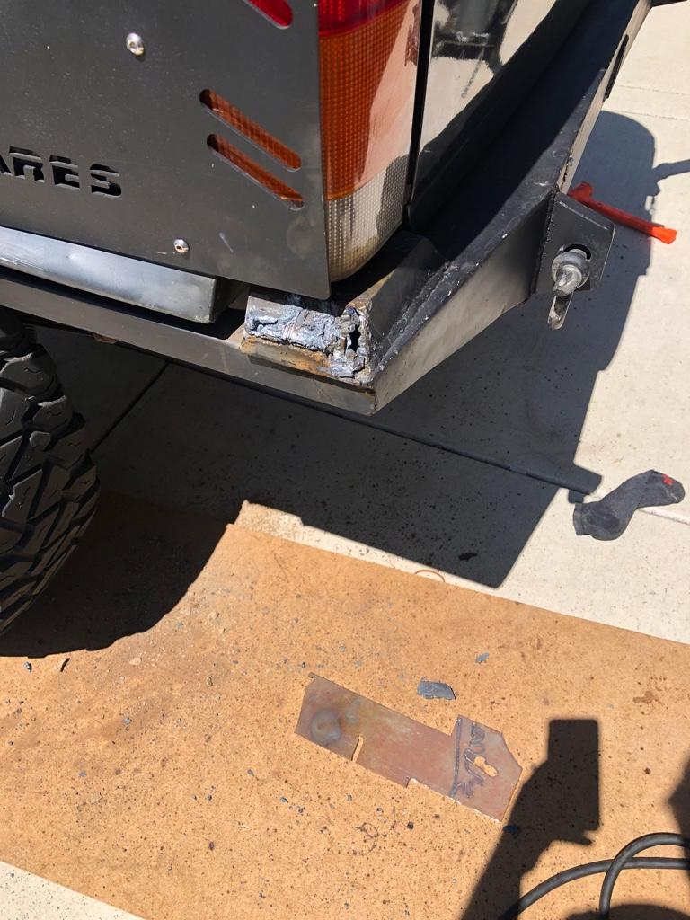

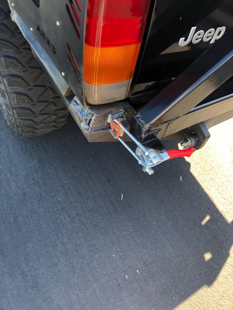

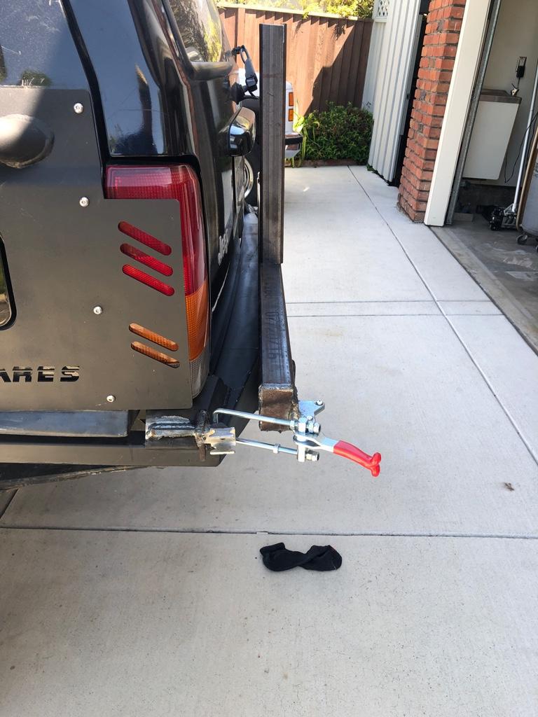

After welding on the latch, with gussets, I decided I didn’t like its location. It hangs out and is liable to get smashed on the trail leaving my bumper vulnerable. Called it a day at that point in preparation for the battle of getting that off.
Couldn’t get int there with a cut off wheel so the plasma cutter was the only option. It got ugly and will require further grinding. I cut the lower rectangle tube and mounted the latch right below the driver tail light.

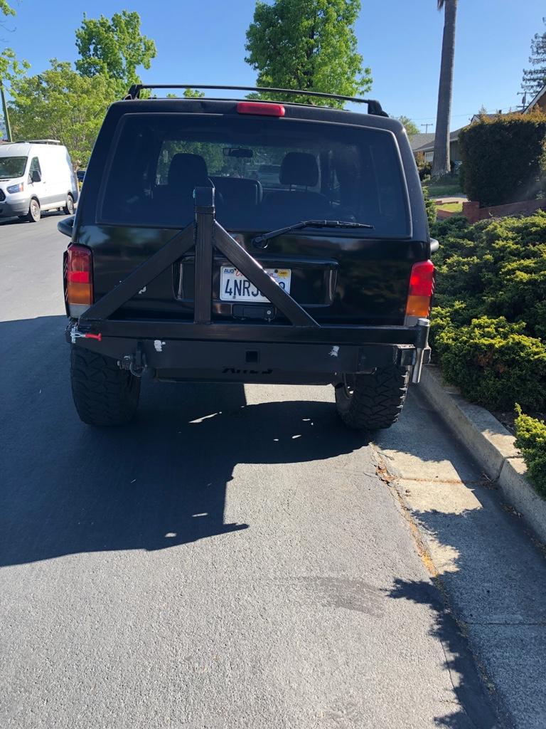

Here’s how it turned out. Still need to add something to mount a wheel. I went with an angled mount where the wheel will be roughly parallel to the rear glass. This way the tire doesn’t hang as low and I get some visibility out of the rear view mirror.
Thanks, if you plan on offsetting the tire I’d recommend placing the spindle on the side of the tire do the weight of the tire isn’t putting such a large torque on the spindle (perpendicular the the axis about which the spindle rotates).

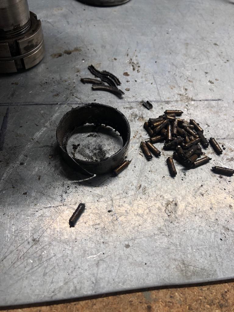

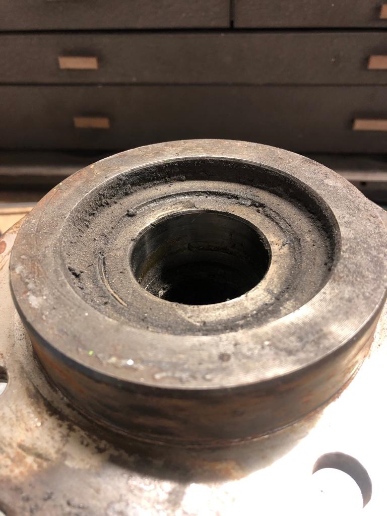

Worked a half day today so I attempted to remove an old spindle bearing. Ended up getting a dremel out and carefully cut through the race. My punches broke the edges of the race clean off. There’s got to be an easier way than this surely.
That doesn’t look like too much fun. I’m about to do the same and I’m not looking forward to it either.

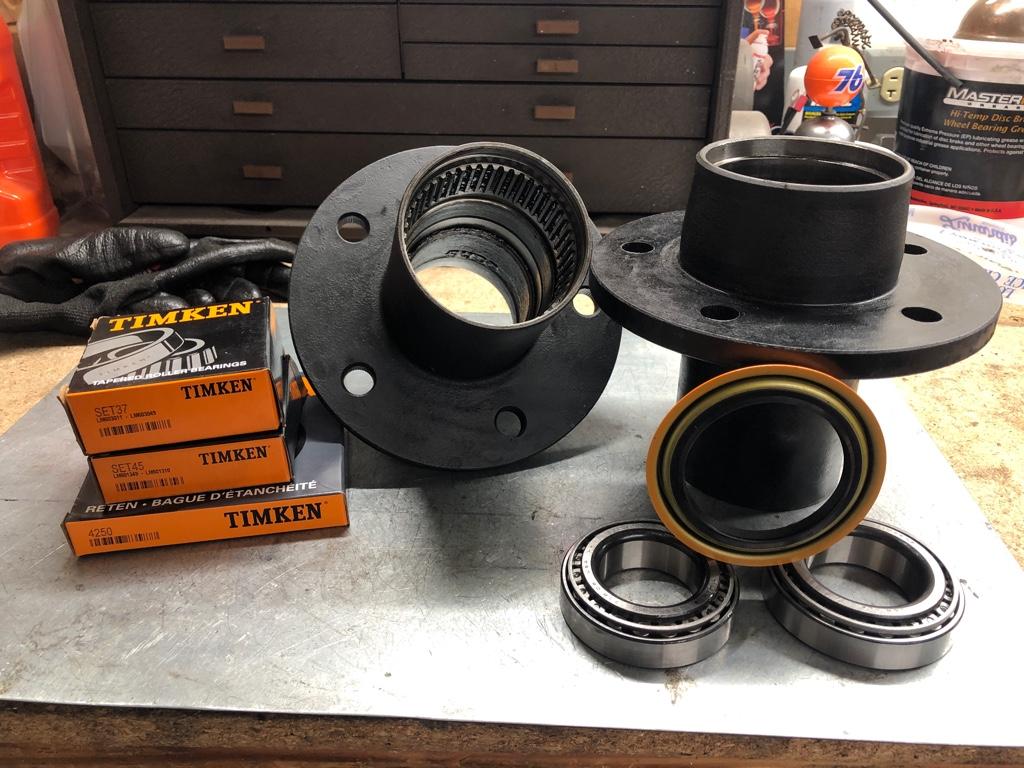

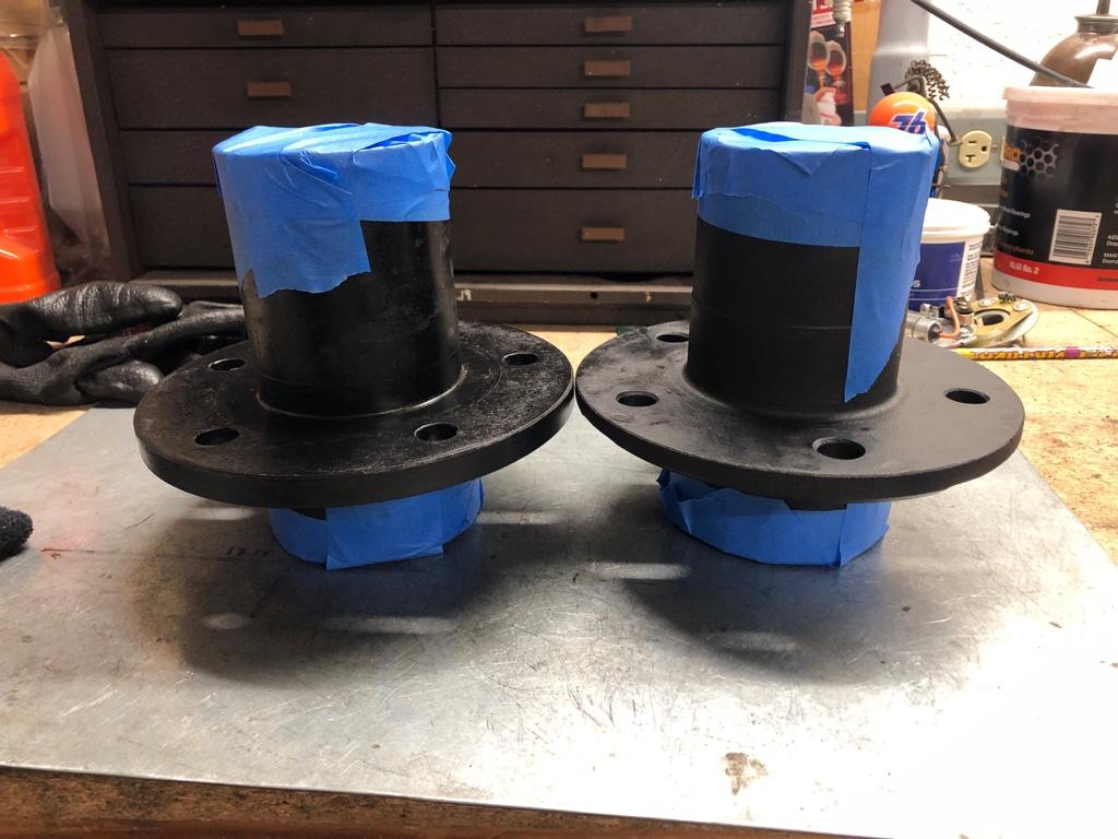

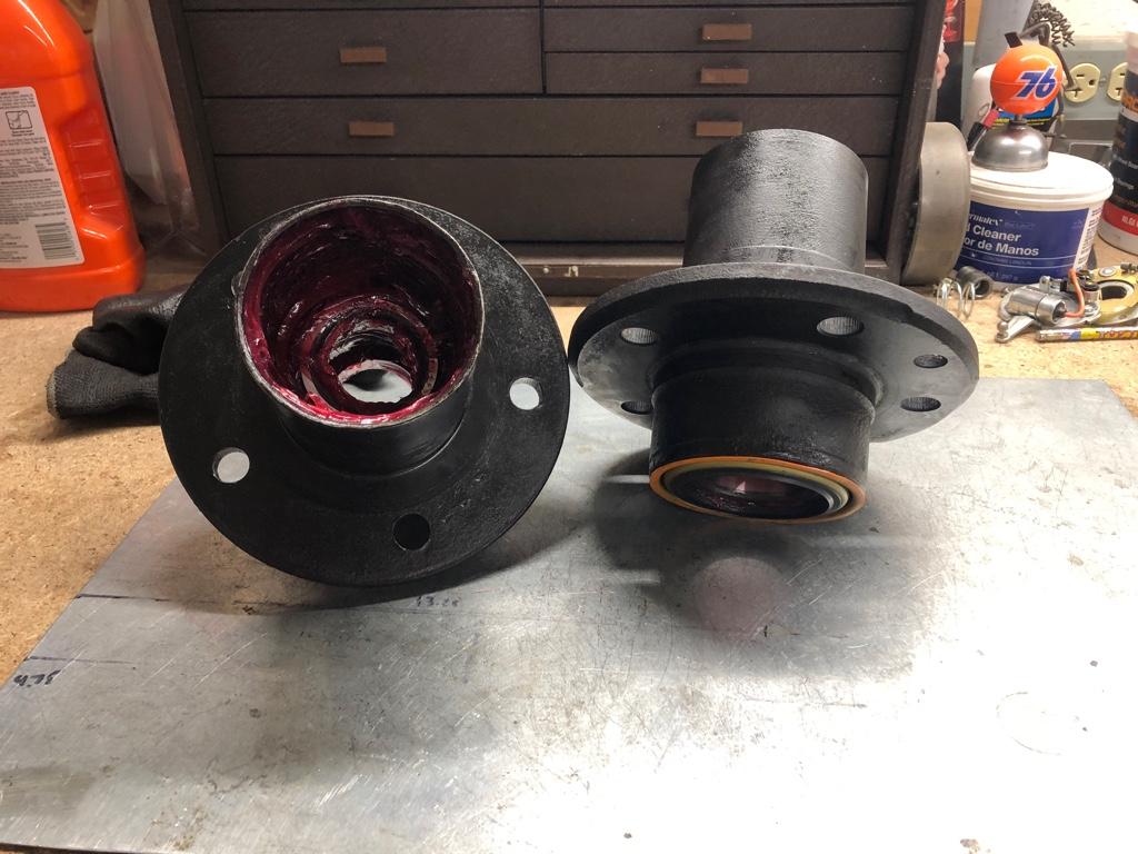

Got lots of parts in the mail today. I got around to packing the wheel bearings + races and installing the seals. These will sit for a little while so I taped them shut to prevent to protect the bearings/grease.

9” truss came as well, it’s got a decent gap right at the center section that I’m not loving. I’ll be putting u bolt eliminators on first and trimming the truss to fit (basically right before the rear gets swapped under the Jeep).

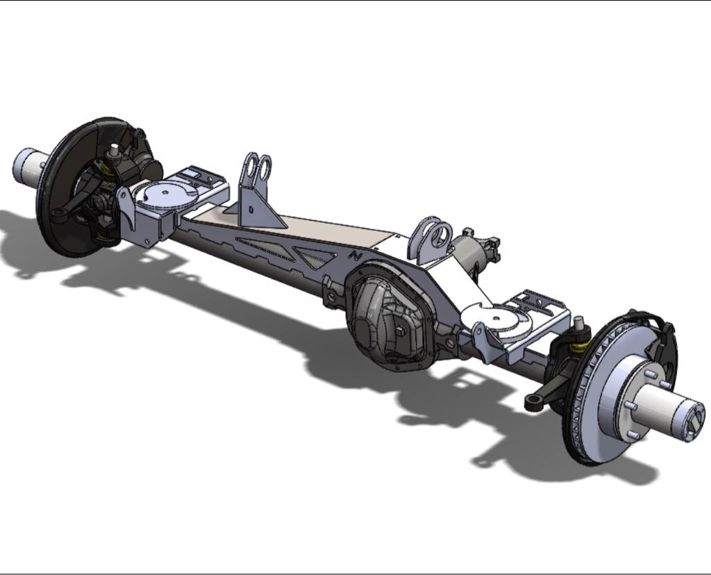

Going to pull the trigger on the front truss soon as well. I’m looking at TNT and New Venture Motorsports. I have experience with the TNT product but I think the new venture has a few more features... Machined coil correction plates and double shear shock mounting that also give the bottom eye of the shock some protection.
New venture
TNT (w/ 87matchief)
The NV truss comes in a tad loess expensive than the TNT as well.
