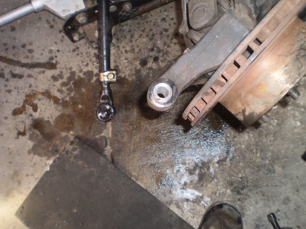

http://i690.photobucket.com/albums/vv267/blondejoncherokee/P1010929.jpg
before welding top and bottom. picked up a harbor freight drill bit kit with everything fro 9/16 to 1". went right through it. kept it tight and hammered it in. welded all around top and bottom.
tie rod sits much higher. the flatter steering angles (due to the RE 4.5" coils dropping it 3" lower that the RE 5.5" coils with the winch and bumper), i really like how it handles with the really flat steering now. was so much steeper before.

AGR 4 bolt box and 4 bolt JCR inner plate didnt hurt anything.
oh yah . pull your rotors before you weld up the inserts. haha. got slag all over the driver rotor. had 3 or 4 spares so i sanded the hell out of one of them and its all good, but that was retarded of me. also had to clean all the slag real good with fine files inside the new insert. if youre a better welder than my welding for 6 months skillz youll be fine.
oh yah, i had some spare cross drilled rotors , so it looks funny to have one cross drilled and one regular.
oh yah , said screw the WJ steering.
got centric premium pads and calipers shipped from rockauto for like 60 bucks. and got (3)the goferit OTK inserts for 50$. in 110$ instead of 800$+ and the breaks are fantastic and the tie rod is plenty high.
