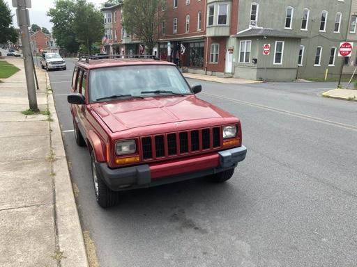

Migrating this over, this is my 99 XJ sport build. Primarily being built for daily driven duties, beefing up to tow a travel trailer.
Purchased this XJ for $900 in July with 187xxx miles. Rust free 3 owner well maintained. Came to me with a blown heater core, blown speakers/door wires broken, headliner sagging, and a missing driver door check strap bar.

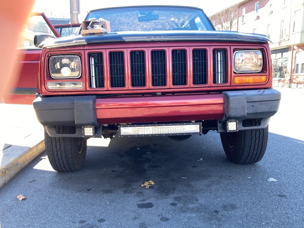

First day home vs
After christmas new tires mounted

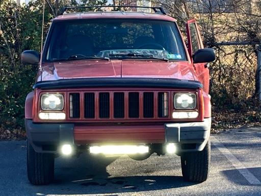

Front led conversion
Priced out the rest of the parts to rebuild/swap ZJ disc brakes to the rear axle. Powerstop rotors/calipers/hoses/parking brake shoes, new axle shafts, new axle seals, new u joints, speed bleeders, KJ e brake lines. $850 plus shipping from the Rock.
By the time i’m done, i’ll have my own collectors series magnet thru them 🤣 $3500+ in parts in 4 months should about cover it
Expecting about the same $ to do the front WJ swap. Knuckles i can get used locally for about $60/pair. The rest i will buy new (and the front hoses will be left over from the ZJ powerstop kit)
This weekend will see new control arms installed along with crown HD front springs with upgraded hardware (grade 8 cad plated bolts and retainers), roughstuff “the cure” center link boot (and a new jam nut on that tie rod end since its half stripped/too big) and hopefully the trans temp gauge and autometer pillar pod mount.

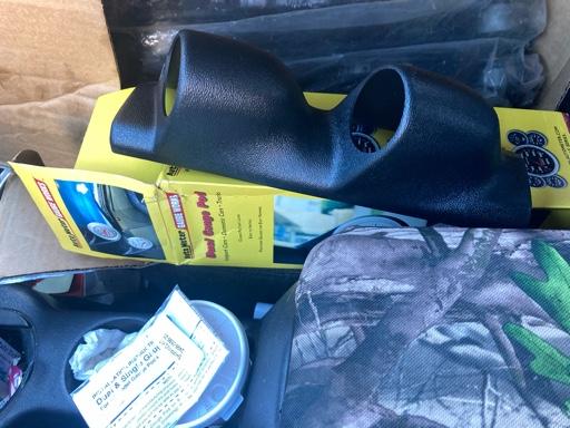

Autometer 15210 dual gauge pod. Not a perfect fit for 99, pillars are rounded at the windshield. I’ll heat gun it to get that edge to lay flat against the pillar. Digital Trans temp gauge in one hole. Havent decided on the second gauge, probsbly a digital dual circuit psi gauge for the airbags and shocks with one sending unit on the 10gal res tank and the other ???

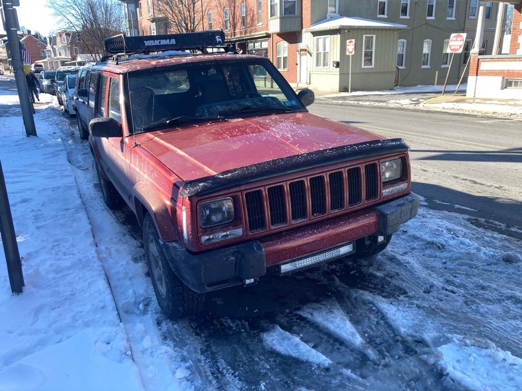

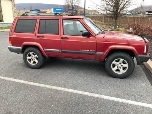

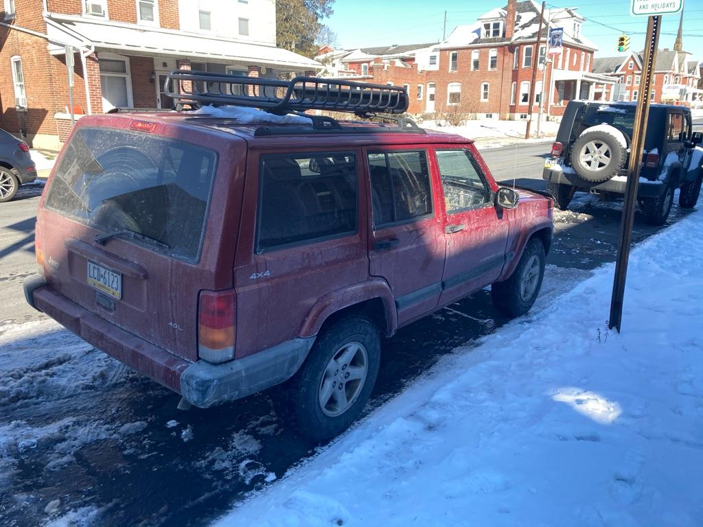

Current pics, with roof basket. Id like to get the AWS vent shades for the windows and an old Lund XJ windshield visor eventually
Thanks. Project is stalled at the moment, been too cold to work and i’ve been laid up in bed sick.
First “major” snow and ice came thru for the season last night. The Nokian Rotiiva’s did wonderful without 4wd, outrageously well with.
