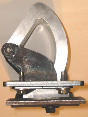

http://www.streetdreamsbyross.com/hinges_suicide.php
Here's a site among many that sell suicide hinges. These are supposed to be designed strong enough to put one in the middle of the door and be able to support the entire door from that one hinge. Could be a viable option for XJ's to mount it on the rear doors right above the wheel well.
There's a closeup of the hinges from there rear door install document. Looks like it's on a pretty sizable hinge pin.
There's a closer pic of the other hinges and it looks like a pin in it on the far left, possibly welded in.
