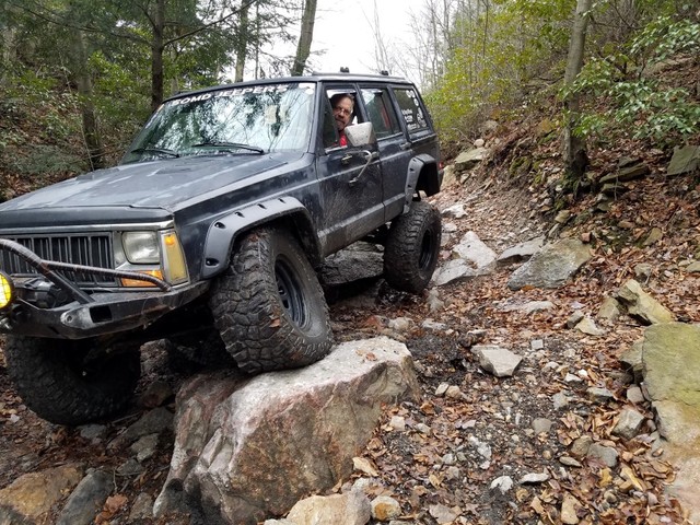

Finished wrenching last Friday, drove to Rausch for the NAXJA NAC meetup on Saturday. The Jeep performed really well the whole day, no problems at all except when I tried to take a stupid line on yellow jacket; changed the line and walked right up it.
After the drive up and back and the day of wheeling, the front and rear are both sitting right at 6" using the dirty lift measures. I assume they are going to settle more, want to end up around 5.5" on both.

Made one last trip to Rausch Creek and AOAA on the 29th and 30th. Ran some trails that were new to me at both. This is on the back side of Shoot the Moon--rear wheel off the ground so still need to work on that.

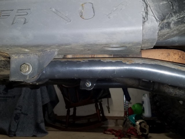

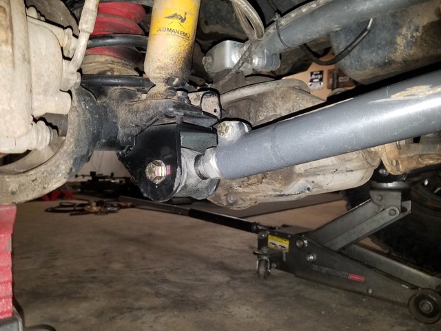

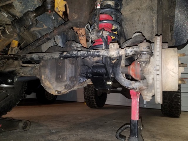

Working on the front D44 and doing some repairs. I installed the Clayton sway bar links while I was doing the lift, but had forgotten to get an insert for the TRE flip, so I got a Synergy and installed it last weekend. Replaced the stock LCA mounts with Clayton pieces (including skids) today.
While I was monkeying with that stuff I also clearanced the stock coil buckets / shock mounts for the Synergy adjuster clamp bolt, which let me flip the longarms into a high-clearance position.
There's not a lot of uptravel available to the Synergy arms on the SFR brackets. Will have to test and see how it goes. May have to flip them back.

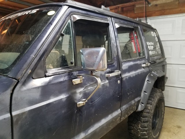

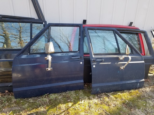

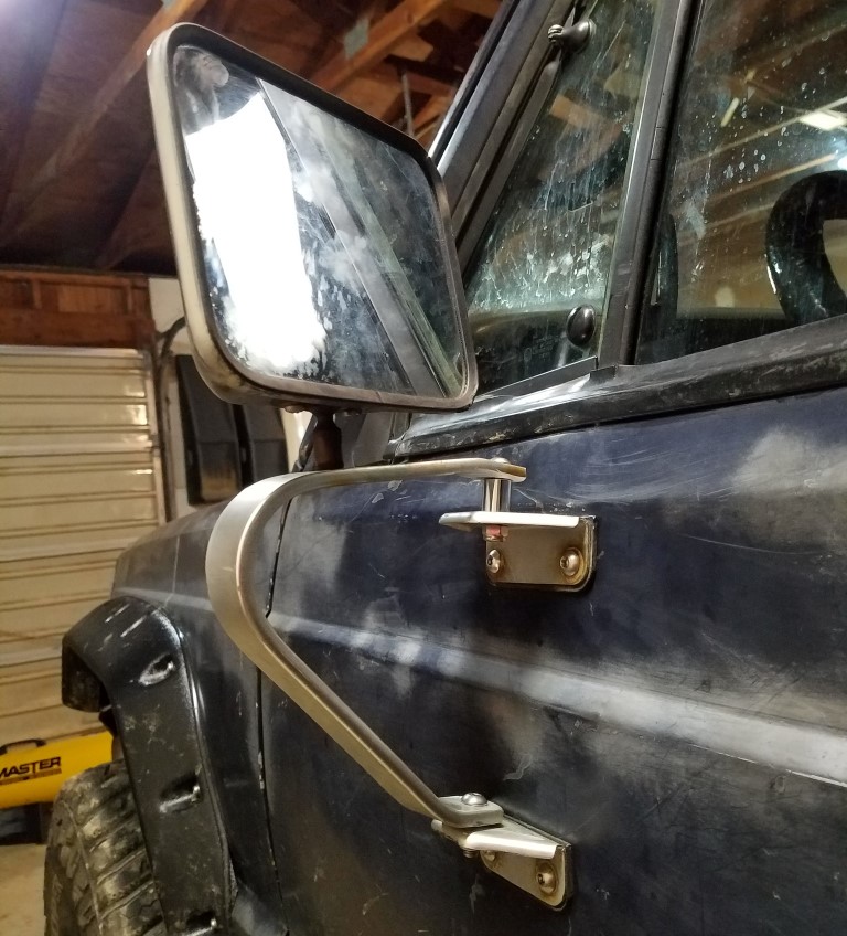

Last year I picked up a couple of doors from an '86 with the optional tow mirrors. I am always smashing the stock style mirrors on trees, so I am hoping that these will fold flat against the door instead of being shaved off. These were only offered up until 1990 (more commonly found on MJs than XJs), so kind of hard to find.

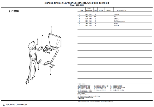

There is an internal support bracket that keeps the mirror from vibrating, you can see it in the parts catalog below. However I didn't realize they were there until after I had drilled holes in my existing door skin, and I am pretty sure they won't line up now.

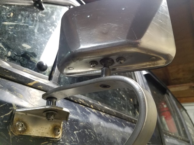

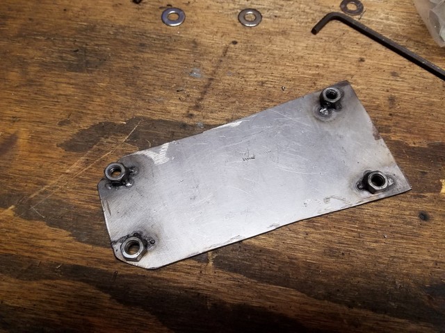

Instead I made some small plates from 1/16th sheet
Stainless hardware on the outside. Goes good with all the other polished metal bits. Check out the dummy plate that covers the stock mirror triangle.

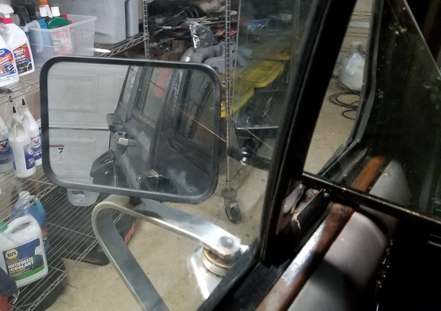

View from the inside, large mirrors to see everything behind me! The wing window clears easily
Unfortunately the mechanical joints on these things are rusty as hell and are seized up pretty hard. I was able to wiggle them loose with PB Blaster and some heat but one of them is flopping around now and I'm not able to tighten it (seized hardware). So I only have one that works right now. I believe these were licensed from Ford, so I am going to try to find replacements with the same hole pattern. Otherwise I will have to scrounge partouts.
pretty easy hardware job on the mirrors, need a longer top screw but otherwise all setup from the local Ace Hardware
Still have one mirror flopping around on the ball stud, screws are frozen and can't adjust. I'll mess with it some more later, maybe replace the glass

I smacked the crap out of the mirrors and they just folded flat against the door with no damage to anything. Need to work on the uppers still.

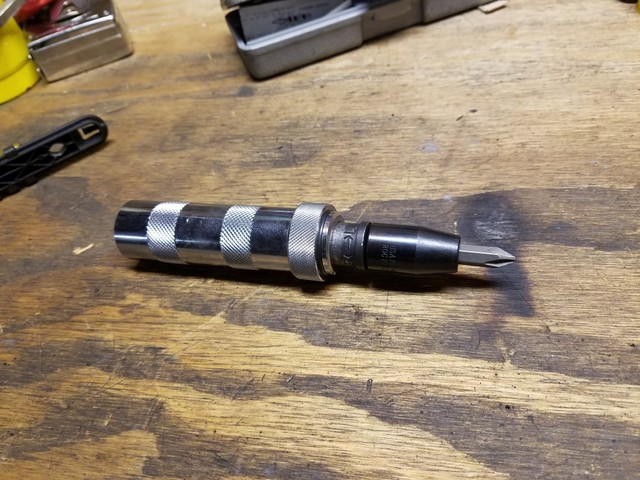

I found a Ford forum that had some diagrams and instructions on rebuilding the mirrors. I was planning to heat the glass and adhesive but there is plastic trim around the glass that I was concerned would melt. Instead I used my old impact driver to free up the two screws that hold the tension plate over the ball, once I got the screws unstuck I was able to clean it all up easily without fully disassembling.
I've had the driver for over a decade but this was the first time I've ever successfully used it on a job
