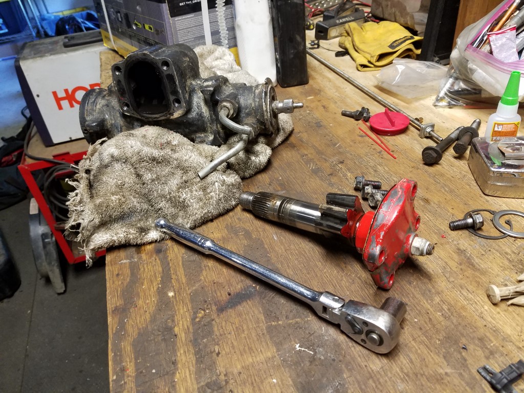

The only real problem was the sector shaft seal blew out on Saturday morning but I was able to deal with it by looping the power steering pump lines and driving out on manual steering. Thanks to Rock2pus for pulling a spare gear box from a donor at the park office even though I didn't get a chance to swap it.

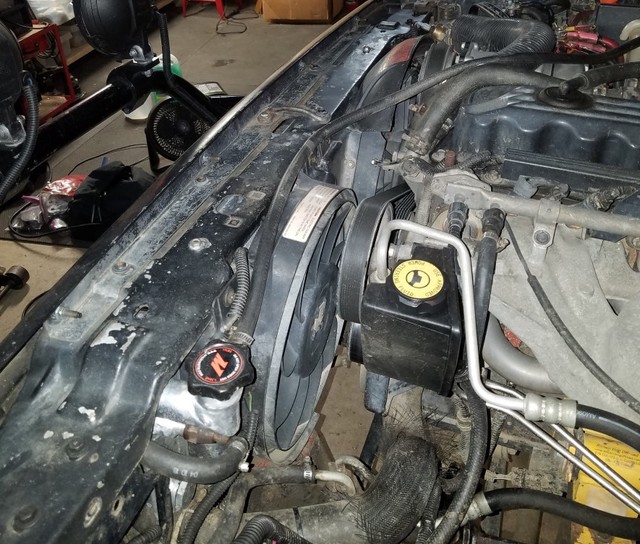

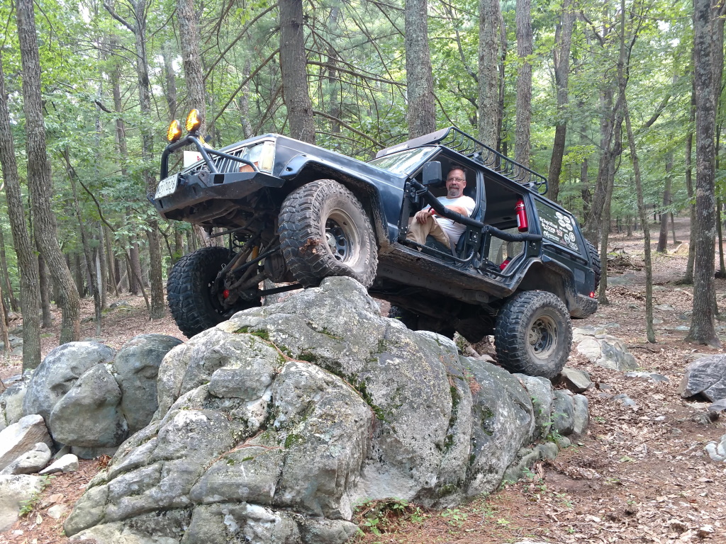

Replaced the seals yesterday and seems to be holding. I found a couple more problems today while putting it all back together. First, the driver side UCA bolt was absent / gone, no idea where it went (edit--still visible in the pic above). And the fan wires fell out of the connector while I was reinstalling the fans over the gear box, so I got the chance to rewire the connector as well.
