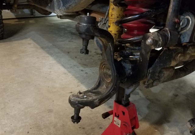

So ... the RCVs do not fit when the TF ball joints are installed in that direction. Instead the castings for the grease fittings poke into the RCV plastic boot and prevent it from turning with the axle shaft. I checked the Quadratec product listing text for the Teraflex ball joints again and it still shows that they work with RCVs. But I checked the Teraflex product page on their own site and no mention of RCVs. Googling showed that all the reseller sites said the same thing, will work with RCVs except Amazon shows will NOT work with RCVs. So at this point they appear to be changing tune.Replaced the Alloy ball joints with new Teraflex adjustables. The lowers were completely shot. These are greasable and you can cinch the lower up if it gets sloppy. Yet to verify that the RCVs will fit but should.
Further Googling showed that the JK version of the ball-joints say to install inboard (like mine) unless you have RCVs and then to install outboard. So I popped them out and reinstalled. The RCV boot still drags but only scrapes instead of being immobilized. The front zerks are reachable when the wheel is turned, but the rears are blocked by th knuckle, so I used some small little set screws to block the rear passages. But it looks like these ball joints are not going to be compatible with the RCVs in the long-term.
