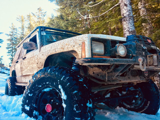

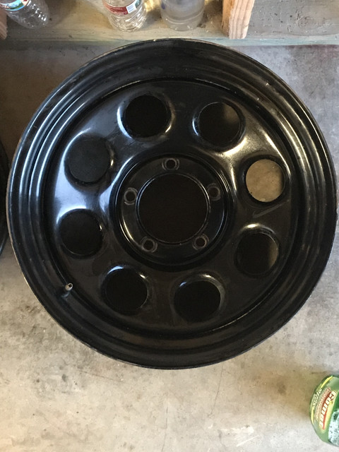

i got a set of 17" wheels for the jeep with a very large back spacing.
see fitment.
with KM2s and full width axles this leaves me with a front axle width of 79 1/8" bulge to bulge.

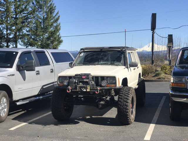

here is a photo with the new wheels and tires along with a hybird cage and cut-out sliders from Those Guys Rod and Customs
Dustin "Torx" loves that i no longer have a roof top light bar.

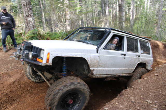

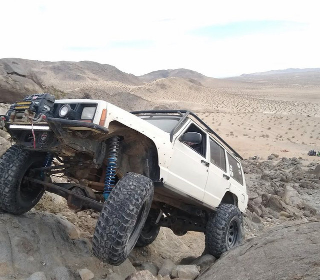

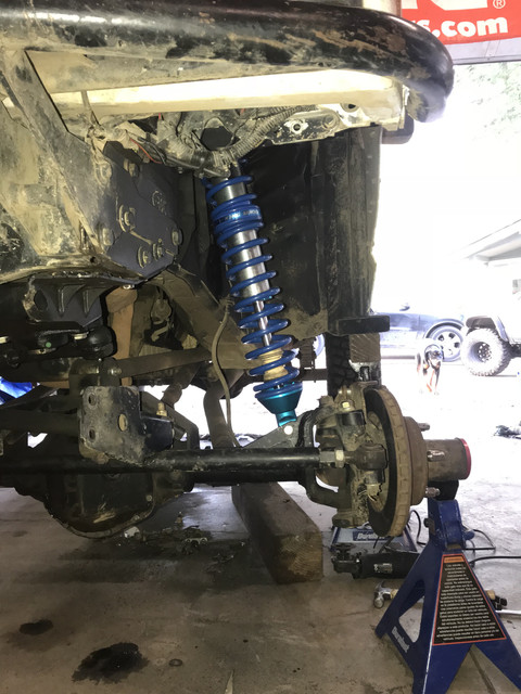

next was dealing with my floppy front suspension
Before while compressed.
After some 14" 2.5 king coil-overs with remote reservoir.

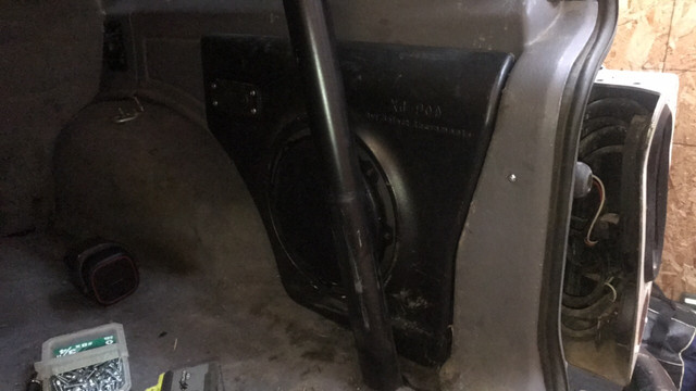

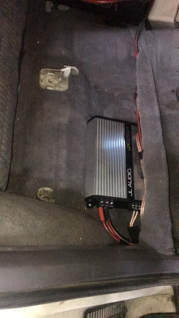

installed some bass because i enjoy having all the creature comforts such as full interior and AC.

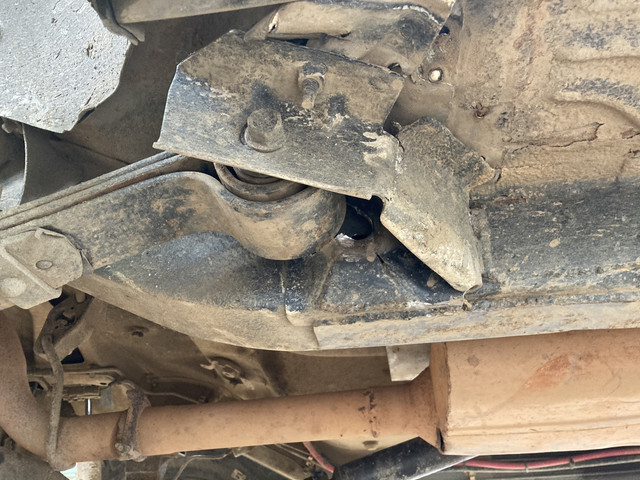

hit a stump pretty hard at the 2021 Oregon Trophy Challenge, ripping out the upper leaf spring mount off the body.
along with this damage i had to replace all my bushing on the leafs, centering pins sheered off, 5/8 ubolts bent, cracked the weld on my axle tube to the housing (no broken welds on the truss).
got that fixed up with parts from Ironman 4X4.
with some modifying of parts to make them work for me.
please do not look at my welds to hard, my new house only has a carport and it was windy :wierd:
Extra holes are due to needing more space above due to having an M-wrap on mt leaf springs.
1/4" plate to attach the 3/16 frame stiffeners and sliders to the leaf hanger.

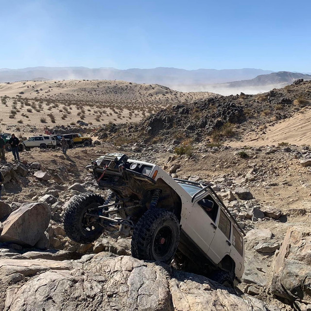

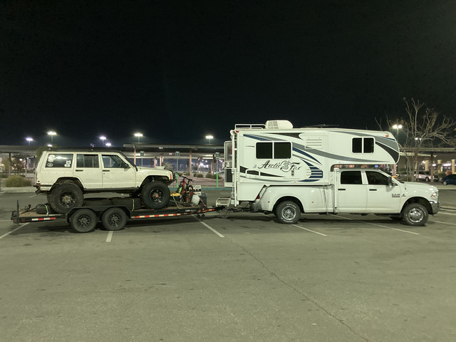

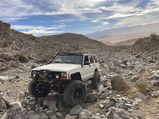

Took the jeep to KOH 2022, Dustin (Torx) invited me to join him in the 4506 car as a co-dog for the rocks.
we took his truck, camper, and trailer.

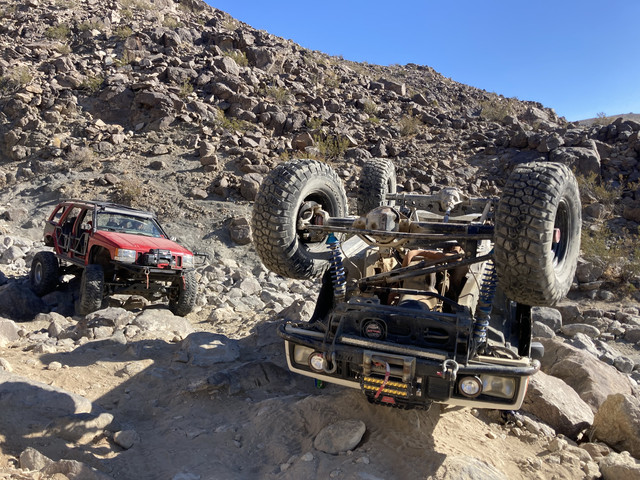

we took the jeeps out for some pre-running.
At this point Dustin was spotting Scott (NW-ZJ-Scott) and left me unsupervised.....
i currently have forgiven Dustin for this because he cralwed in to my jeep to hit the seatbelt button for me while i held myself up.
Direct Quote From Dustin " Don't fall on me"

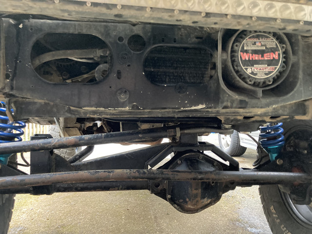

First time looking over your build thread. Plan on stealing some ideas from you, like the pusher fans and power steering cooler. Did you ever decided to put an aftermarket trans cooler in? Love your build.
First off... Thank you.
i did install an aftermarket trans cooler.
Hayden 1401 cooler
It's installed behind the front crossmember (where the factory one is)
I do not run my trans fluid in to the factory ports in the radiator, this is because when i had my black jeep the factory style radiator (maybe a year old) broke internally and mixed coolant and transmission fluid.
This made a mess, ended my wheeling on our big yearly trip, and killed the transmission.
