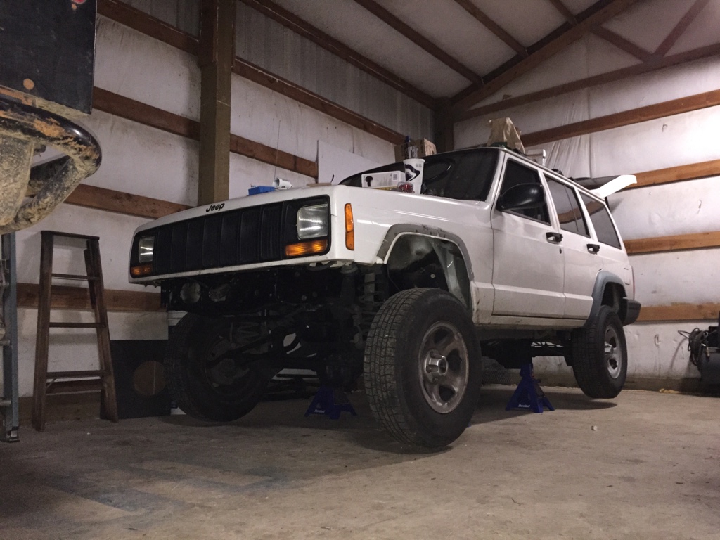

Last weekend I worked in the Frame stiffeners
Here I painted the inside
I only did the front, so I can get my bumper on, I will end up doing the middle when I put the long arm on.
The reason behind that is if you put the midsection on before cutting off the lower control arm mounts you have to cut the frame stiffener down, and I don't want to cut it down just to have to piece it back together.

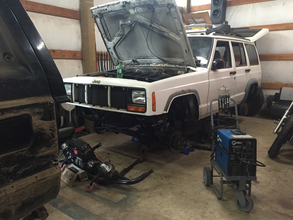

Got her moved in to Scott's shop, black jeep will go in this week then she gets ripped apart.
