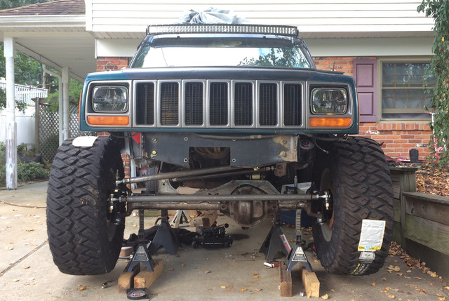

Its a 3 link. Lower mounts are even with the axle tubes, you can see the upper above the diff. I was checking clearances/flex before I fully burn everything else in.
Oh, ok I was just like “I don’t see no coils, coil overs, nada, whats up?”
