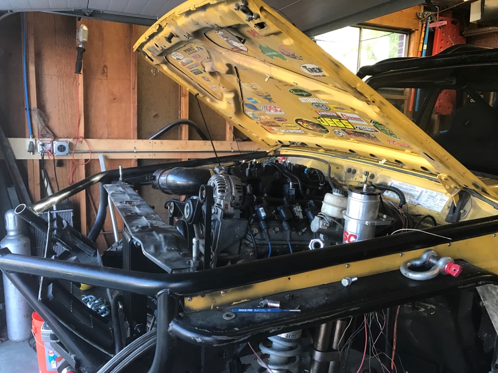

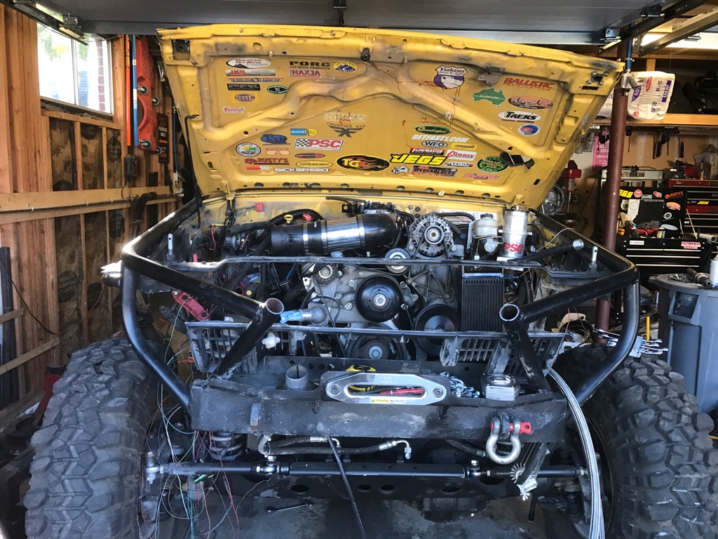

Real progress today!
I got the engine, trans and t-case in in one piece.
I only had 2 major pita setbacks.
1, one of the bolts holding the chain on the back of the head was hitting the firewall and making my life difficult to drop the motor in the brackets. It only took me an hour of struggling before I finally saw it!
2, those motor mounts are a bitch to get set. I'm not a fan of the Novak style of isolator. It's a major pain to get everything exactly lined up to get the shoulder of the bottom bushing to fit up into the bracket.
Here it is in its new home:
I put the hood back on to see if any of it would work out with the truck manifold. I'm trying to decide if I'll cut a hole, do a cowl, or skip it all together and add some new tube work around it for roll protection. Jeep is getting green stickered next year. No more screwing with air care Colorado!
How bout both? Hole in the hood with some cool looking cage over the intake? Kinda rock bouncer looking
I'm thinking that one. A cool engine cage over it maybe.
