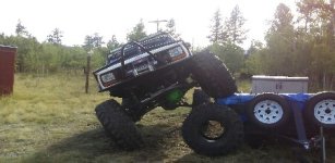

I put a 30 degree glass pack on my old zj 5.2 it was cool the for about one week I had 35s on the stock 3.73 ratio and to get moving you always were putting your foot in it and it was sounding like bandimere speedway and you were barely novibg and at cruise rpm the drone in cab sounded more like John Deere than Jeep Grand Cherokee. ..I need to quiet this one down some as I can not hear a spotter over the motor very easy .
Holy crap! Pics! Nice!
They are about a month old much metal work done since...lol...still have not finished the paddenger side door skin fit up or the stud assembly for the rear passenger door to bolt to everytime I do some crap happens fire ban...or setting my yard on fire...I need to drop the gas tank put in the cargo srea I already built that to drop the tank in then plate the rest of the inner rails add two subframe crossmem bers drop all internal cage pillars into that , and then finish that hydro mount the psc cylinder is an old one with no machine work for clamp detention just a smooth body , so at each end of the cylinder I'm going drop in a detent keep it from moving...I got to get better pics of a few things that size better for the naxja pic limits ...Hopefully this is on trail shortly ...lol...I frenched the rear frame rails for the coil buckets , but a set of ORI struts would look better in that notched out rail.
