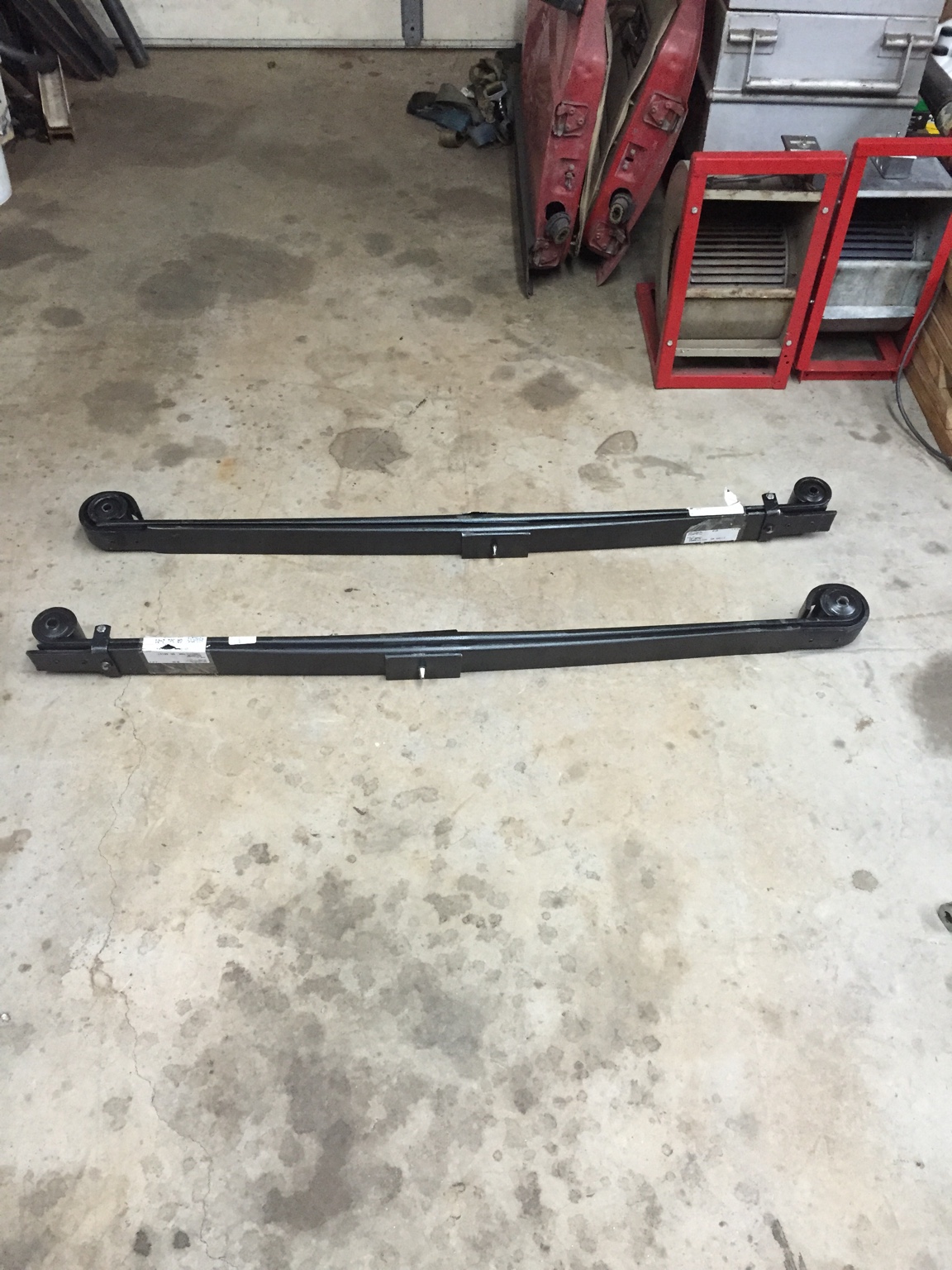

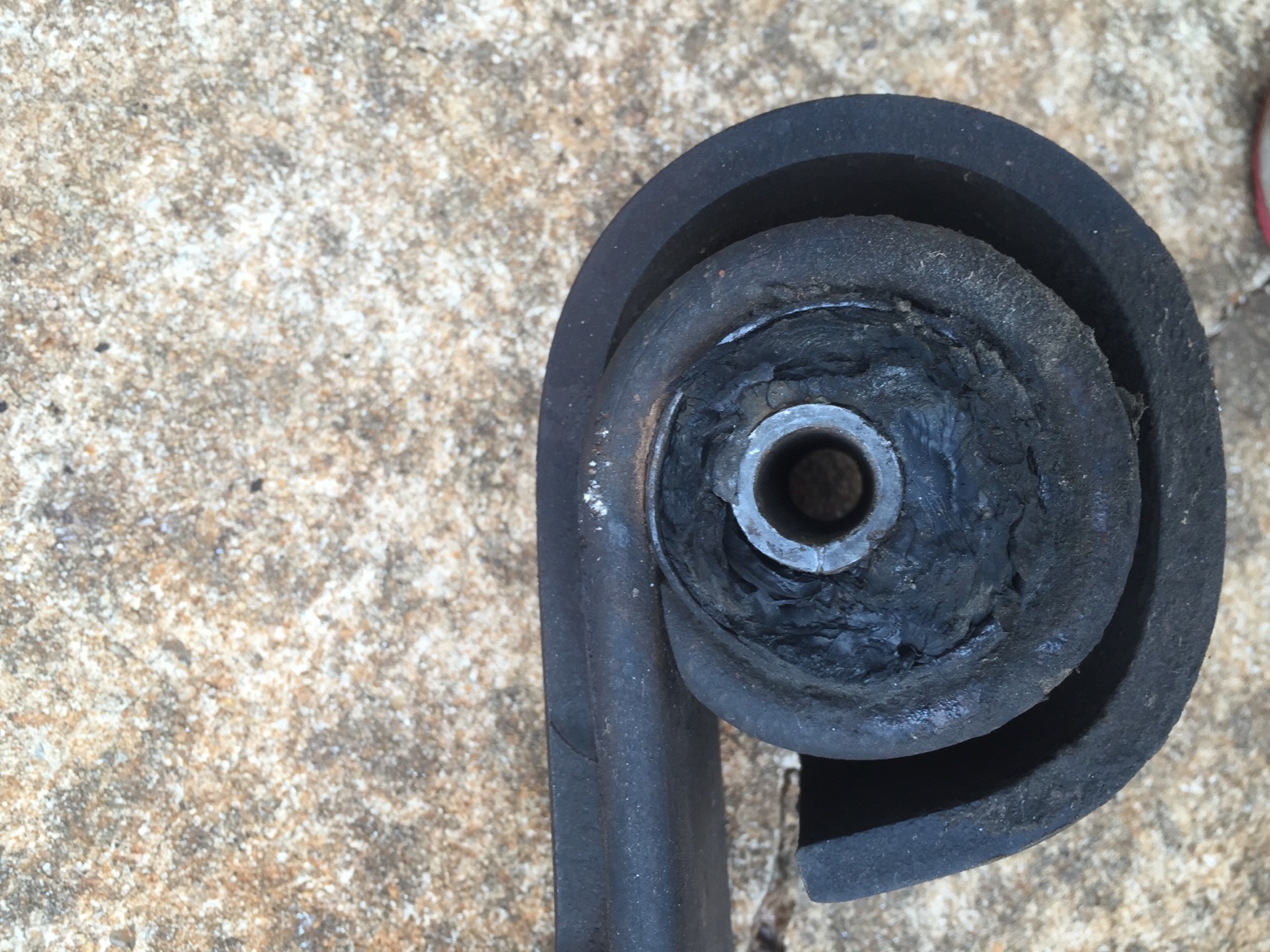

Mostly I threw up money at the internet this weekend. (Click the links for pictures because for some reason I can't attach them to this post)
Figured I should maybe fix this issue...
4618696
