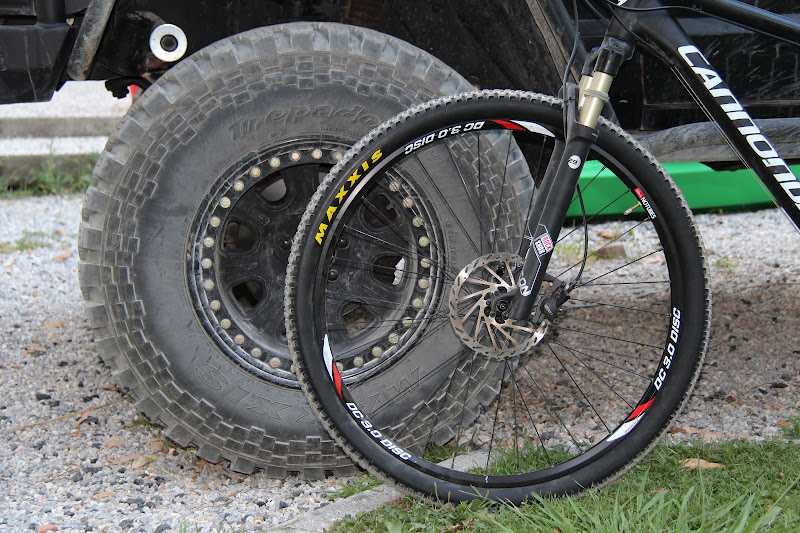

Installed some 29" Maxxis Ikon EXO's and Stan's NoTubes tubeless kit. Now both my mules run on Maxxis. One week until my race.
You already said that. You should have rotated the Jeeps tire so that both Maxxis names would have been lined up.

Made my XJ watch while I installed some new Maxxis Ikon EXO 29er tires and a Stan's NoTubes kit on my main whip.
My old tires were almost bald and had 5 inches of sidewall rips. The tubes had two patches a piece. Getting ready for my race in two weeks.
Its good you did the Stans on new tires. I ran it in old fireracer xcs with soft sidewalls and after the 4th or 5th time eating trail because I burped the front tire I went back to tubes. Man the low rolling resistance was so much fun though.
