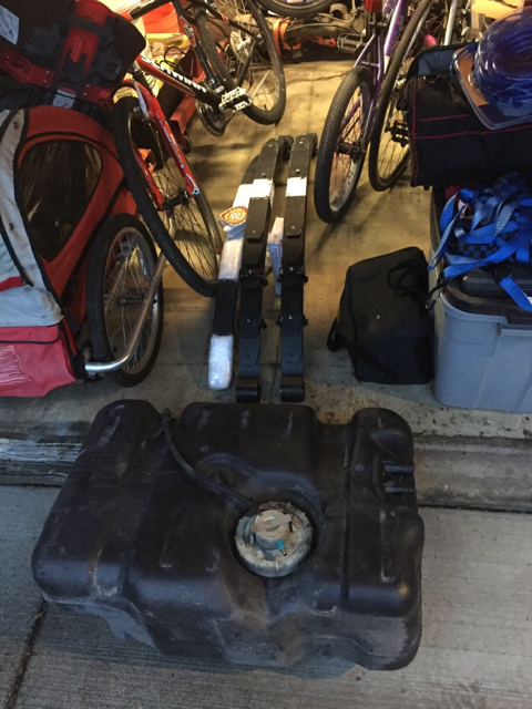

Been ordering a lot of stuff. Got new leafs from iro. The 3.5" with the aal for more capacity. New tcase linkage kit from boostwerks. New headliner. Three new boots for the shifter. One from hurst. One for the tunnel and one for the console. Installed my thumb throttle. Ive been sealing up the floor to fix some rust spots and adding heat/deadning material over the entire floor and doors. Ill be doin the ceiling when the headliner comes out. Bunch of new leds for rocklights. Picked up a zj gas tank. New carpet kit is on order. I got it with the extra mass backing. Ordering boostwerks shackles next week.

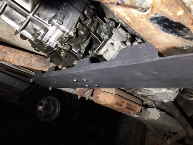

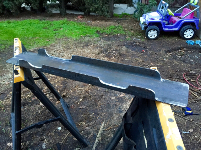

Finally have a new trans crossmember.
Made it out of 1/4" x 6" c channel
Took about 4 hours total. I love my plasma cutter
Fridge cameo
Tcase is not clocked and is like a 1/4" below the framerails.
This is not a perminant one. Ill be doing a full belly pan when i 3link the front and swap in the tons and d300. But it will be fine till then. The final belly pan will have recessed hardware.
Anyways. Back to work

I love that crossmember
Crossmember looks sick!
With the zj tank are there any mods that need to be done to the guage system or will it automatically compensate for the increased capacity? 20gal stock to 23gal zj yeah? I've been thinking about the same swap.

So i havent done it myself yet but i have been told and read its an easy plug and play swap. There are no mods needed to the sender. The height in the tank from the pump flange to the floor is the same as the xj tank. So you just get a bit more full than you would with the stock tank.
