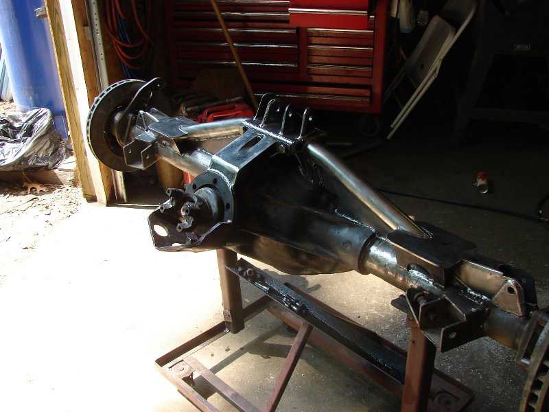

Bend tube over diff.
Fill inbetween tube/diff/axletubes with 3/16" plate.
Drill speed holes where desired.
Extend out to backing plates.
Burn it home.
Burn it home.

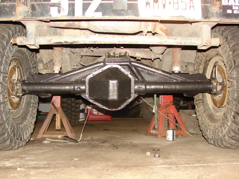

might just get a big strip of thick plate and bend it around, weld it to the tubes then fill it all in with like 3/16"
i only want speed holes if theres tube going in there. i dont want gay mud to get trapped in it.
I hate trusses full of mud and rust.
I don't think you understood what I was saying.
Similar to how Chris did his front axle.
If you're looking down the axletube, only one 3/16" plate, basically making a "T" where the top of the T is the tube, and the 3/16" plate is the | part of the T.

Just grab some box tubing and copy it then. Fill in speed holes with tube.
something like this
i would go all the way to the leaf perches and minus link mounts plus traction bar mounts
but taller like this, bot maybe like half the tallness. i dont need a gay ross-like truss

XXXX box tubing. didnt turn out so great last time. i think the way i described doing it would be easier with my gay hand tools
spun tubes are a pretty common occurence with these says the internets. and the housings do crack when linked or with traction bars.
so ima booger some metal all over this bitch
make it narrower and deal
id have to cut off that dumb truss though and melt a cool one to it

And honestly if you leave the main piece of 1.75" tube and just cut off the airbump/shock mounts there's probably enough space to put spring perches.
i already have a geared and locked 14 bolt the width i want it, with all the parts i need to get it functional and under my jeep. just wanted some insight on the truss.
Damnit Sam, I legit just threw out my 14b truss templates too. I even have some rect tubing perfect for it. Ill show you some cool pictures of what to do to it. Weld the tubes too, might as well shave it while you're at it. Hell, just drop it off at my house, I gots the 14b stuff needed to make it cool.

Whatever you end up doing, I'd tie it into the pinion support bolts...easy enough and it gives you a solid bolted connection to the diff housing instead of relying on something welded...they use a really shitty cast iron on these things. If you're into poopy welds it's right up your alley.
