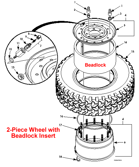

I am looking at getting some H1 hummer beadlocks and if I can find some with the stock military BFG 36" or 37" tires that would be great to start. This project is getting pricey despite the junkyard attitude. :)
what size wheel are those?
I'm running (well on jackstands that is) 12-bolt H1s. There are nice.
Just an FYI, the stock tires... pretty much junk, IMO.
Thanks for the heads up. Would they work ok for DD? because this is my daily driver and when I do the swap I will need bigger tires or else I'm gonna be winding out my motor:fuse: After my wallet contains more than dust I will get something new. Not sure what though. What do you run?
I guess I should have stated earlier I personally have not run them. I have however seem them in (some rather disappointing) action from others. There is a reason why they are cheap. For a DD that doesn't see much hard trail time. I'm sure they would be fine until cash permits something else if you could get them for free with the wheels or close to it. If that was the case for me I'd probably had gotten them just to have something to roll it around on until I found another tire, I just got my H1s NIB for a good deal, thus no tires.
What do I run? Jackstands... all the cool kids to that! :star:
I'm trying to find myself a set of bias Iroks, but then again mine won't see any road time.
