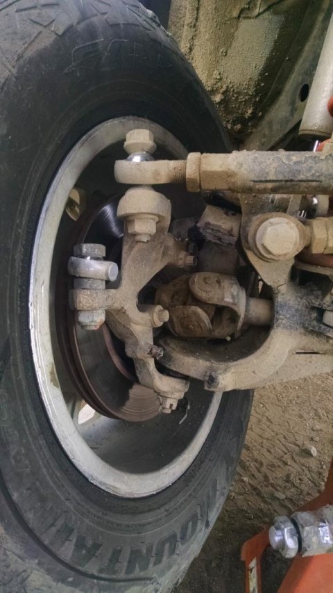

That sure looks like a crack near the spot where the upper half of the inner C and the trackbar mounting plate meet the axle tube, too. How deep did it go? Did you grind that out and reweld? Or am I seeing things?
Its a crack in the trackbar mount.
We welded over it to race on. The entire knuckle is getting replaced before the car goes out again.
Sounds good :thumbup:
Would have hated to see it break in half without warning.
Yeah us too. But its a lot of freaking work.
I have to take a bare housing to Currie, the cut the C off and then butt weld a new one on, then we get to write a big check, followed by rebuilding the axle.
Worst Christmas ever. ;)

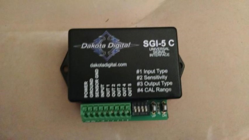

Now the real nerds will look at this photo and can figure out what I'm up to next...
I'm wondering if its actually gonna work.
