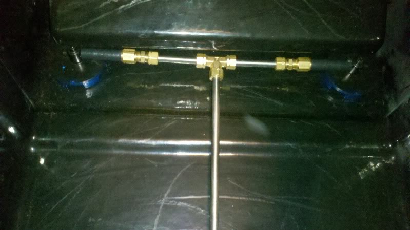

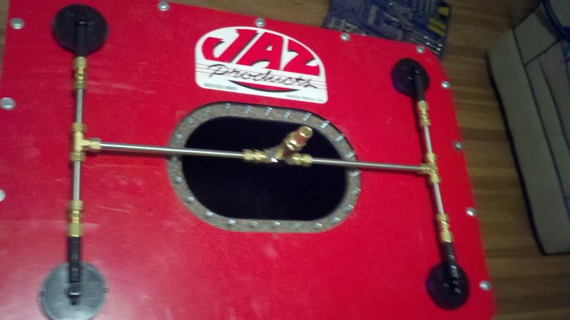

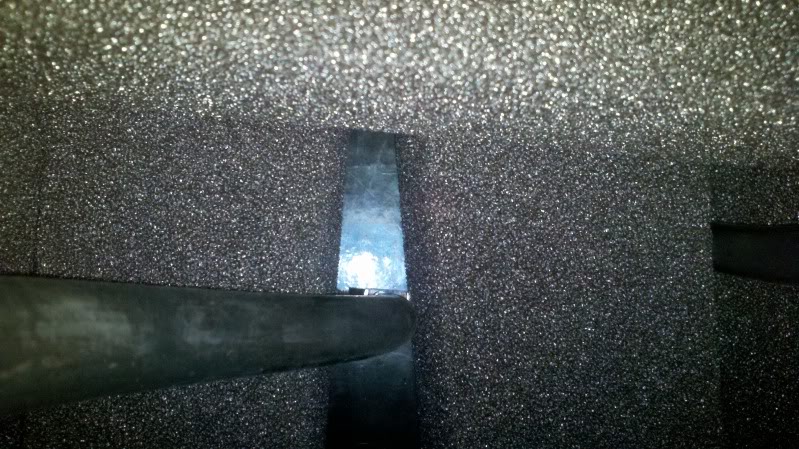

Last night I pulled the fuel cell apart to clean it, add fuel pickups and do a final assembly.

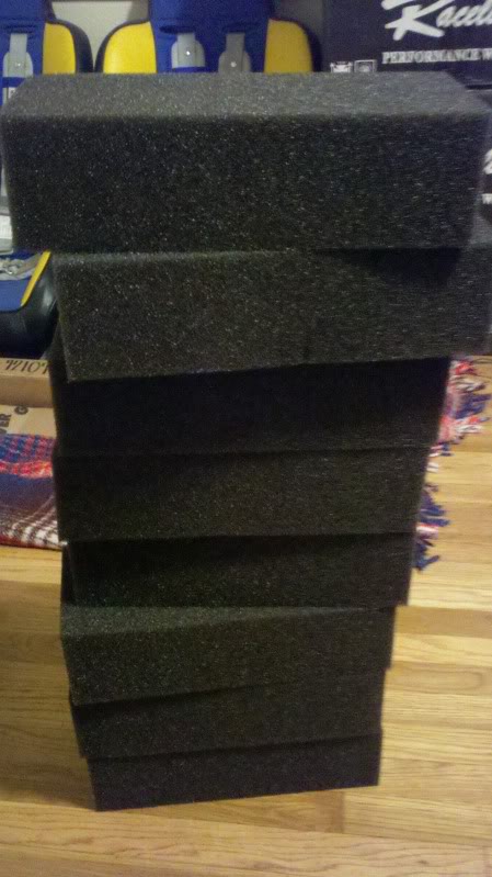

I knew there was safety foam inside, but for whatever reason i didnt expect it to be a bunch of free floating blocks of foam.
We're running four Walbro pickups. They are supposed to pick up fuel when submerged, but as soon as they come in contact with air, will close and allow other pickups that are still wet to do their job.
Stack the foam back in like lincoln logs so they don't flop around, and connect the fuel pickup line.

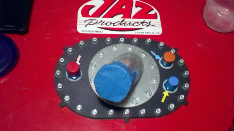

And re-assemble the fill neck assembly oriented correctly

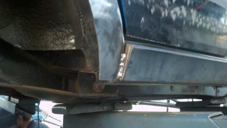

Rock rail being welded to rear quarter armour. We're welding stuff all over, keeping the car rigid.
I'll take some more pictures this weekend.

I've never seen those walbro pickups before. Pretty clever idea. Most of the roadrace setups utilize a "box" with trap doors.
How much travel are you looking for out of the rear?
The Walbro's work pretty well, I've been running them on the buggy for over 4 yrs with no issues.
