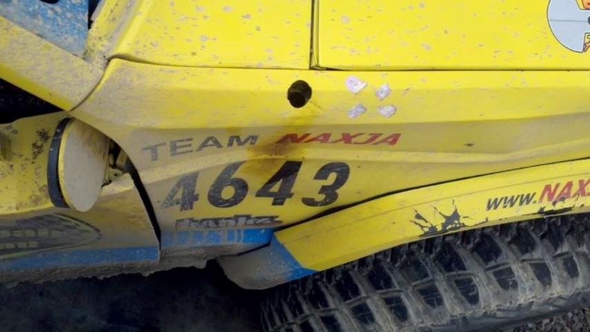

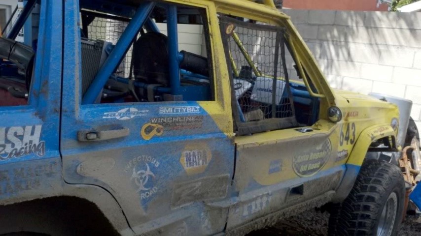

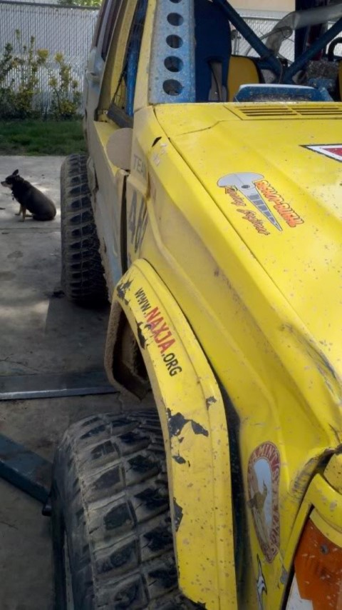

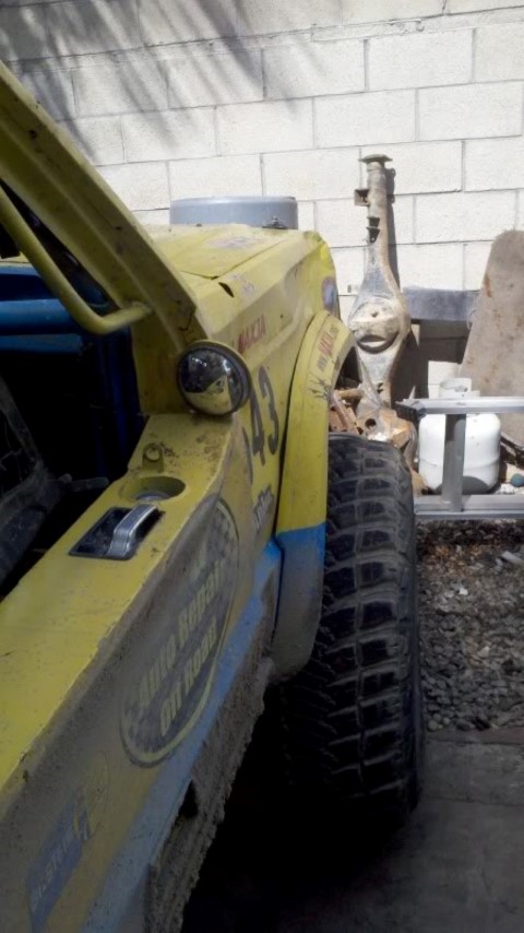

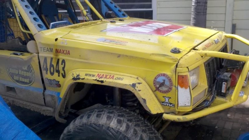

Now for the carnage!
We've got a couple of weeks to replace the fender and NSS, along with a few small things, and do a tech and prep on the car - and then off to Utah for the American Rocksports Challenge at Miller Motor Sports July 12-14.
