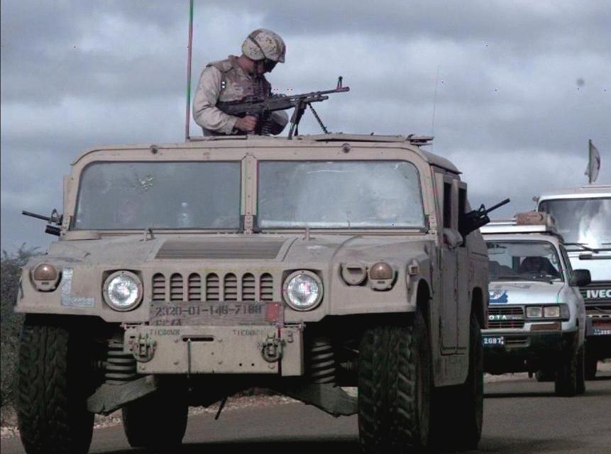

Hate to keep this thread going, but let me explain. The snorkel is to raise the intake above the level of the surrounding dust. I asked one of my motorpool guys about this a while back and he told me that almost every Army division was going through air filters left and right. So much so that the problem was referred to an engineering group stateside to see if they could come up with any solutions. The engineering group began a study using some pile of pentagon money and discovered that trucks used by the Marine Corps under similar conditions faired much better than their Army counterparts. The reason for this was the raised marine intake tubes, i.e. snorkels. Apparently they didn’t do anything to help filter dirt and sand past the filters, but they did make the filter last longer. In any case, all new Army hmmwvs were ordered with the marine snorkel kit. (And trust me, I don’t think the Army plans to get into the amphibious assault business.)
Early Hmmwv
Late Hmmwv

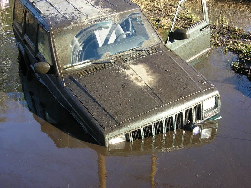

I have a snorkel, but I'm also up here where water and mud is most of our terrain. I know a lot of you westerners don't like mud that much, but its unavoidable here. I never thought I would have gotten a snorkel, until I got stuck in a water pit and sank down. Had my left side sank instead of my right, then I would have needed a new engine.
http://i49.photobucket.com/albums/f251/begster/CoyHill037.jpg
My next time out, after I had the snorkel, I was cruising in a pit of water that was no deeper than my bumper, then I went over a ridge and dipped my hood under. I'm glad I had it then.
People always laugh and ask me how many times I've used the snorkel, they are always surprised to hear that I actually have.
You can see the water line half way up the hood.
