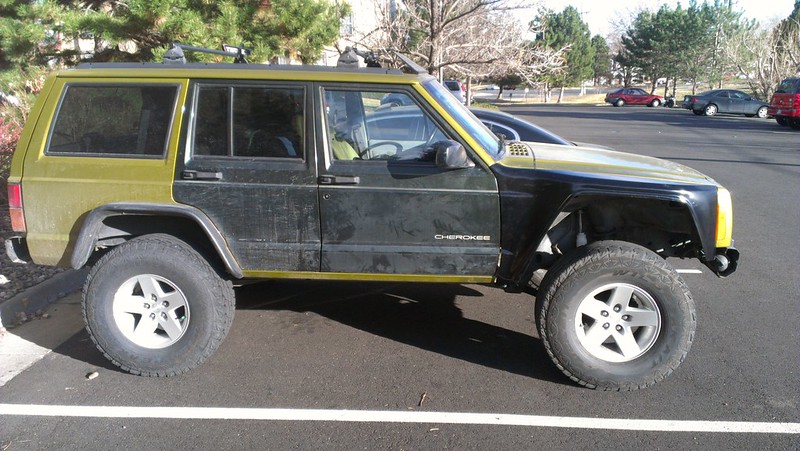

I grabbed a pic of me parked next to a rescue green jk rubicon at lunch the other day too. You can definately tell that the lower line of ppg basecoat i used has more of the gold pearl in it then the factory chrysler color...but its pretty close and i still really love the color.
your header panel and fender dont line up :)
i bet you never noticed that :laugh:

are you kidding me...i do body work for a living, of course i noticed that ha ha. The pass fender is the same way, they are cheapo aftermarket fenders and thats as good as they are gonna fit :P

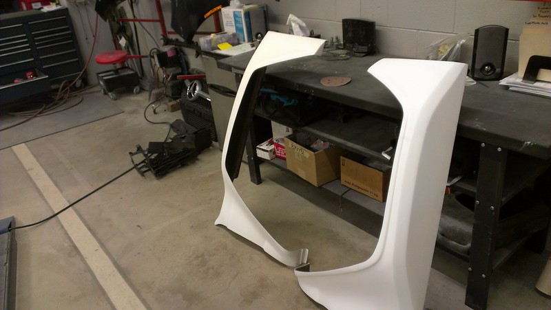

Santa came an little early!!
IMAG0019
I ordered these from hannemann in california on thursday night after work and they showed up this afternoon! I was super happy with how fast they processed my order and shipped my fenders. The quality is better then i was expecting too, they are super thick fiberglass with really nice woven fiberglass. There are some small imperfections in the gel coat but nothing major, nothing a little glaze and primer/blocking wont fix. As for the fit we'll have to wait and see!

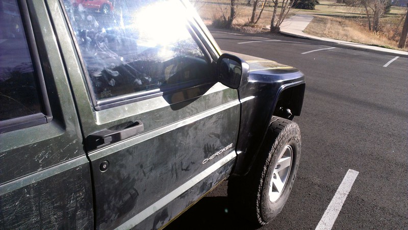

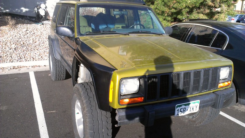

I took home a bunch of my tools last night and went to my buddies house to mount my fenders this morning. Over the last couple weeks/months i have been swapping out my doors for a set of 97+ doors. Ive been doing one at a time as it is very time consuming. The strikers have to be swapped so i pulled the interior and drilled out the captive nut inside the quarters and b-pillars and made backing plates so the new strikes bolt on and still have adjustability just like factory. The wiring is also very tedious as nobody has any good writeups on the wiring part of the door swap. As of right now i have both rear doors bolted on, adjusted, wired up, and everything is working great with them. The front passenger door is also on the jeep and mostly wired up but because of the way they ran the door lock switch wiring in 97 compared to 96 (8 wires vs 3 wires) I dont have the lock switch working yet. So thats why the doors are a different color...now on to the fenders!
I decided to do the pass. side first since the second time you do something it usually turns out better then the first so in that theory the driver side should go faster and be easier to fit better. Once i unbolted the fender and sat the hannemann in place i felt like crying ha ha ha.
The initial fit was HORRIBLE! The fender actually wouldnt even sit on the jeep without me spending a good half hour grinding away a ton of material on the back of the fender where it meets the a-pillar. Next the front of the fender wouldnt sit right without being cut/ground to fit over and around the front of the inner fender and radiator support. Once i got the fender to sit remotely in the right place i began fine tuning the fit by grinding spots on the fender that interfered with the body of the jeep preventing it from fitting properly.
Drilling the holes was the easy part, i drilled one hole at a time and started at the a-pillar area and worked down making it fit the door first then worked forward making the hood gap decent. I went one hole at a time and used rubber washers i got from ace above and below the fender to prevent cracking around the bolts over time.
When i got to the header panel area there was nowhere to bolt the fender to because when you swap to 97+ fenders you have to get rid of the bracket that goes between the fender and inner fender on the 96- fenders. So as a temporary solution i made a little 90* bracket to attach the front of the fender to the inner fender. I need to get the correct brackets from the junkyard and attach the fender to that then figure out a way to attach the header panel.
I had planned on tackling both fenders today but had no idea the fit was going to be this bad, so after spending 3 hours on the first fender i abandoned the idea of getting them both on. In the end after a ton of work i got the pass. fender to fit decent but im still not happy with the gap/line up at the bottom of the fender to the door. Ill let the pics do the rest of the talking.
