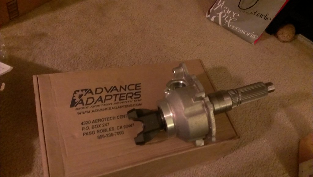

I picked myself up a christmas present this weekend...Got a brand new advanced adapters slip yoke eliminator for my 231 this weekend. I scored it from a kid on craigslist for $175 bucks, i wouldnt call it a steal, but definitely got a decent deal on it!

im gonna try and find a spare transfer case to rebuild then just swap mine out the same time i swap axles out. After i figure out what tires/gears ill be running ill buy the correct speedo gear....what else do you guys think i should replace when im going through the t-case? I was also wondering if anybody had any firsthand experience with hd/wide chain kits, are these worth doing?
I haven't looked into the cost, but I've also never felt a need to upgrade the chain. I never hurt the factory chain on my Tera low converted 231, and neither did David as far as I know.
Re: where have all the good cherokees fs gone
I tend to agree -- I'm running a stock chain in the 231 behind the v8 in the WJ, although I did upgrade to a 6-planetary...
I just helped rckymtnguy install a sye on his 231. He sourced it from a used 231 he found on CL, so, he currently has a 231 pulled apart he wants to sell. The tag says 96 i believe, but it has a 21 spline input gear, so we think someone swapped gears in this case in the past as 21 spl wasnt an option in '96. Anyways, you could get yourself most of what you need for your sye install, Proracedriver, if you are interested.
Thanks for the offer squirrel, but ill have to pass, if i have to swap input shafts then i may as well just pull my case and use that. Im gonna just keep my eyes out for a complete 23 spline 231.
