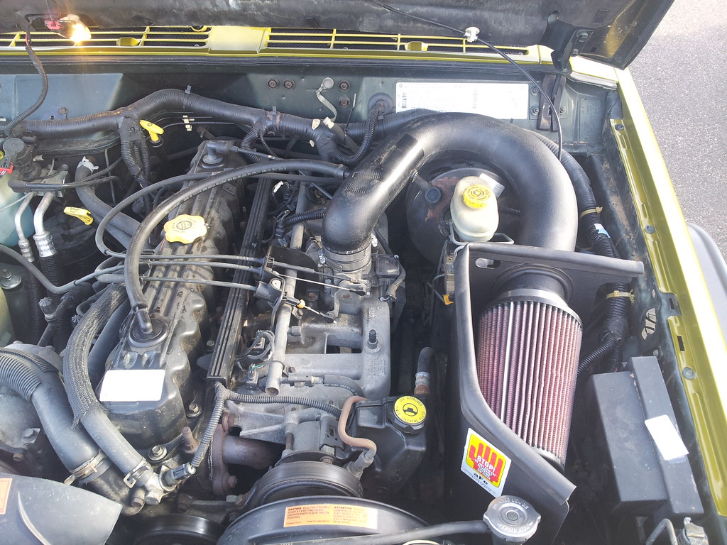

oh god....your didn't paint your bolt heads.....oh god, why....

You need a 99+ intake on there now.......I got an extra laying around here......

I heard that this is a good upgrade. Have you ever done it? What kind of improvement would I see on lil'dirtys 98? We need to take off the intake soon to replace the gasket.

My Jeep came with one one of those, but it doesn't have the extra CATS on the exhaust manifold. I guess that means its supposed to be fast, but I'm not seeing (or feeling) it.

10HP, IIRC. Air moves much easier in the 99+ mainifold. Worth the effort? YMMV. :D

I just put a '99 + manifold on my dads '97 TJ...I can tell the difference on the highway going up hills, seems to pull them a tad easier now.

I just drove to denver this afternoon and did noticed a difference going up the hills on the highway...my jeep usually downshifts to maintain speed going up the big hill before castle rock but today it stayed in overdrive all the way up the hill. Im not a big believer in bolt on items providing much if any perormance, but in the altitude the intake seems to actually make a difference(im from michigan originally) After today i think i wanna try to get a 99 manifold and see if it makes a little difference like the intake tube/filter did...the two together might be pretty sweet.

After comparing the two intakes side by side, I can definitely see how the newer one flows better. If you can find one cheap enough, and don't mind a little time out of your day, I'd say it's worth the effort. I think it took me maybe an hour to swap them out.
Just be prepared to bend your arm and wrist into configurations only Stretch Armstrong would have ever thought to do! :laugh:
