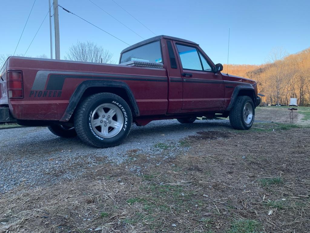

Well, I probably should start a build thread on my new MJ. Well obviously not “new” but new to me. It’s an ‘89 Pioneer 2wd. It has a 4.0/AW4 with an 8.8 rear axle with 4.10 gears. It has a little pep off the line but it does run some r’s around 70. I posted a couple pictures already but to keep everything together, here they are again.
Starting point:
I’ve been making small modifications to it ever since I got it. The first thing I did was to swap the ranger wheels for some Jeep Ravines. I’m running 295/50/15’s on the rear and 255/60/15’s on the front. The rear has 1-1/2” spacers and the front has 1/4” spacers. With the two piece knuckle and hub assembly I needed the 1/4” to make the wheel fit the hub without grinding anything down. Once I get a late model front beam I can do away with those.

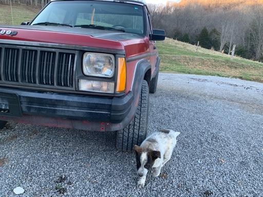

I put in the Hella E-code headlight housings with a set of Osram night breaker H4 bulbs. I also added a new headlight harness with relays and man the headlights are light years ahead of stock. I am super impressed.

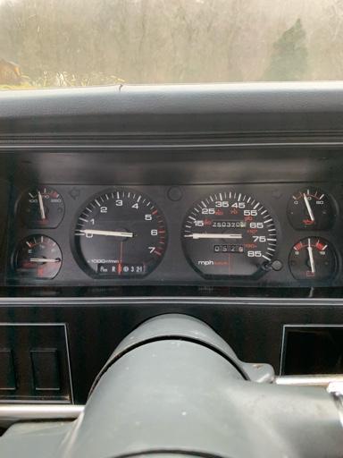

Since my truck is a column shift and I wanted a full gauge cluster, I was out of luck as far as finding a factory cluster, so I made one. I took the old idiot light cluster that came in the truck and took the gear selector out of it and then took a full cluster from a Cherokee and cut a hole in the tach gauge so the selector could be seen. It works great and looks pretty good. I got the idea on Comanche Club.
All the gauges but fuel work and I think it may be the sending unit. Still have to figure that out but with a working trip meter, I know when to fill up. It’s getting about 18.5 MPG. Not the best but with the gearing it’s good enough for now.

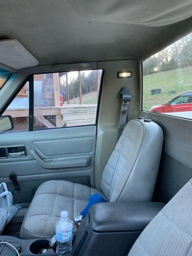

I got a set of B-pillar lights and got them installed along with new door jamb switches. Now when you open the doors, yep, I have light. I replaced the bulbs with LED bulbs and I must say I like them.

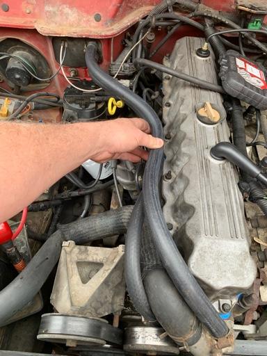

One more thing I did was to replace the heater hoses because the ones on it were cruddy looking from the PO swapping to a closed cooling system.

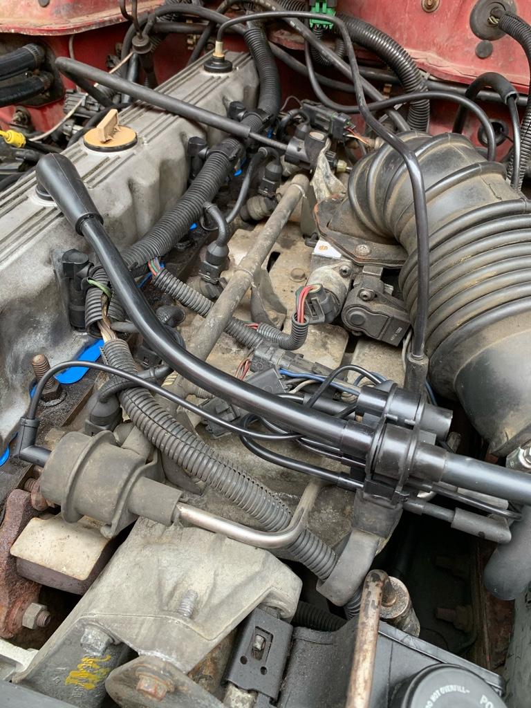

I forgot. I also put in a new valve cover gasket and 1/2 of the vacuum harness on the front on the manifold. I bought the better gasket instead of the old cork ones, they seem to always leak.

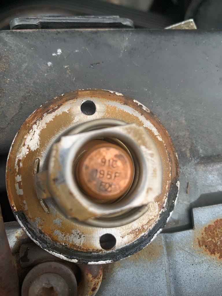

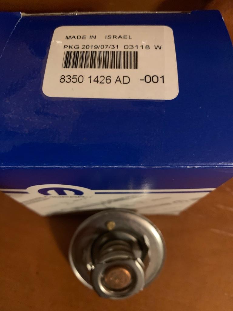

This morning I put a new lower radiator hose on and a new thermostat in it. The lower hose blew out the first of the week because I think the thermal stuck closed. The old thermostat had two holes drilled it. I guess to get the air out of the system.
I bought a Mopar OEM thermostat to go back in it. It had the bleed hole already drilled in it but it had a “thingy” in it so it wasn’t an open hole all the time.

Are the E-code housings glass? What did it cost to do the headlight upgrade? I'm guessing these items are from Amazon?
Yes, they are glass, let’s them handle a higher wattage bulb without issues. First thing I got was a wiring harness, $20.00 from EBay. The housings I got from..... I’ll have to check cause I can’t remember but it wasn’t EBay. They came with a set of H4 bulbs and were right at $100.00 shipped. Pricey, maybe but I don’t have to worry about seeing at night. These are the best lights I’ve had on any Jeep I’ve owned.

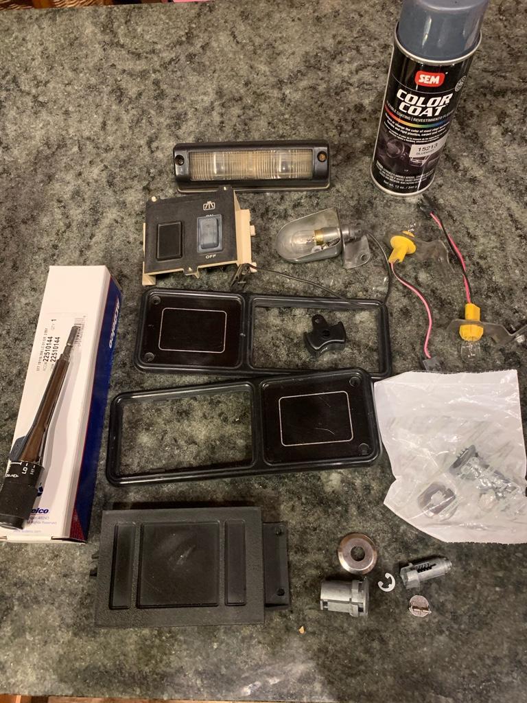

I got some new parts for the truck. I hope to be able to get some of them put in this weekend.
I’m also gonna try and get my new radio in but it’s all for nothing right now. My alternator took a dive on me so it’s sitting till the new one comes in which will hopefully be tomorrow or Monday.
