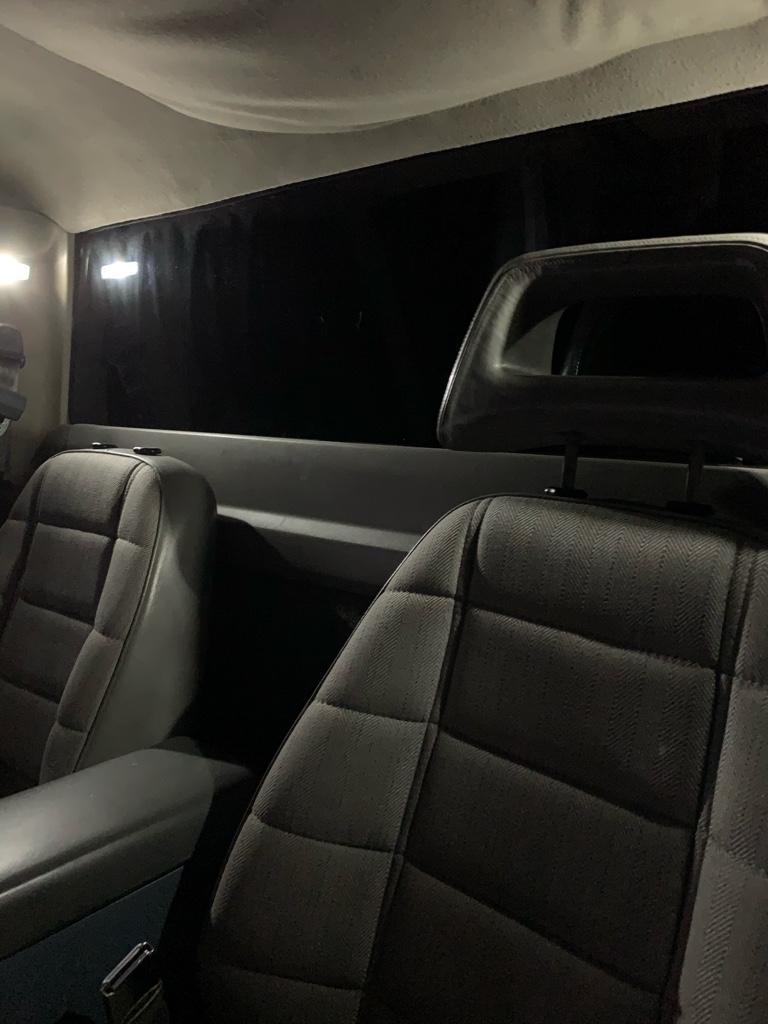

I got all my interior lights working with LED bulbs.

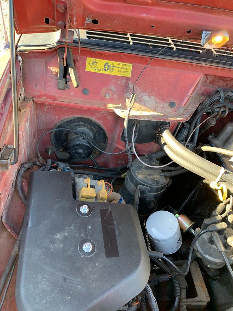

I installed an under the hood light too.

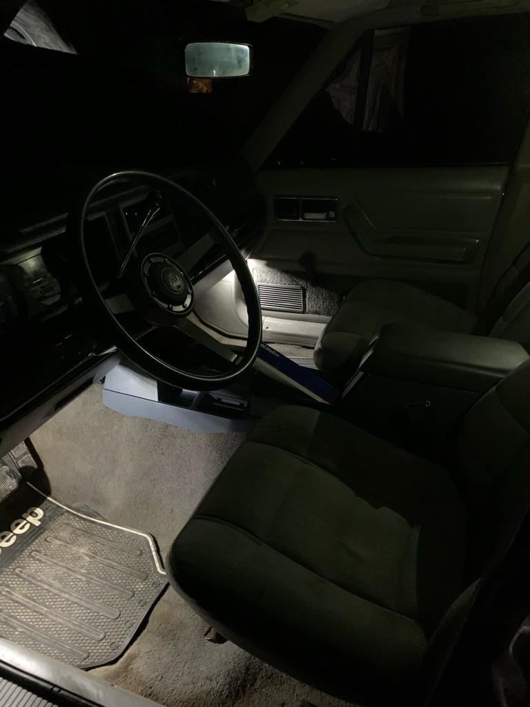

I painted and mounted my center console too but it’s the wrong color. I’ll have to get the right color and repaint it but that’s the easy part.

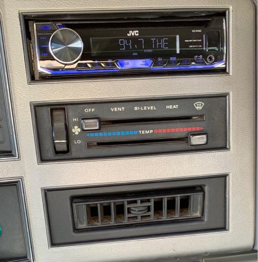

Got a new radio put in too.
I need to do a little adjusting to it to make it center the opening though.

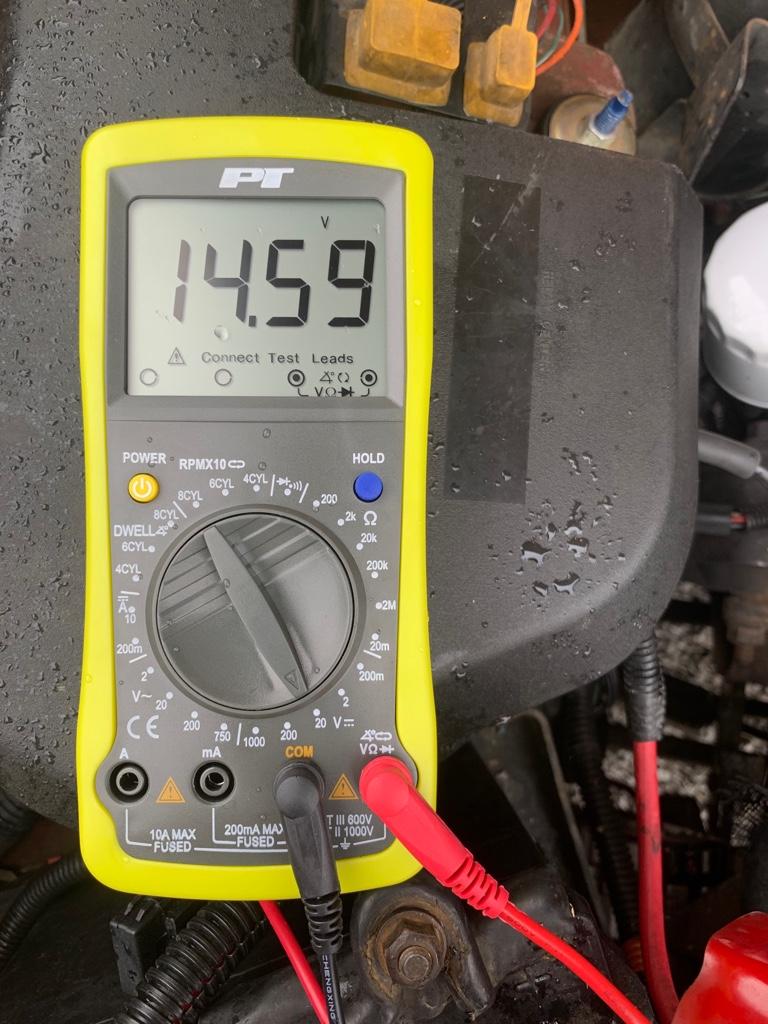

Well. Got the new alternator on it. It was pretty straightforward: 2 mounting bolts, plug in connector, single wire connected and belt routing. Started it up and nothing on the gauge.
Went and got a multi tester and got this.
I know the alternator is working but the stupid gauge shows.....

How about the regulator? I think it’s external on that gen XJ.
Didn't you put a different cluster in? I assume it died when the alt died and is not the cluster. I would check wiring and the gauge.
I was thinking the regulator is internal but the alternator is charging the battery so wether it’s internal or not it appears to be working. I had both the leads on the battery cables at the battery. If the regulator was bad I wouldn’t show a charging reading, right?
I did swap clusters out but the gauge was working after I swapped them. I’m guessing the actual gauge itself went bad. My plan is to pull it out and put 12 volts directly to it and see what it reads. If it reads 12 volts then I have a wiring issue.
You know, I’m not sure that’s the case. I say that because after I did my motor swap, got it all back together, I didn’t tighten the belt enough. It started fine and ran a few times and all was normal (gauges read as they should). Then, on Th e 3rd or 4th time starting it the belt popped off. The truck stayed running, just not cooling or alternator. The volt gauge read ZERO. Battery was at 12.36, gauge ready ZERO. Only after replacing the belt did the volt gauge come back. My gen has an internal regulator, so it made sense to me. It might be the case for you.
