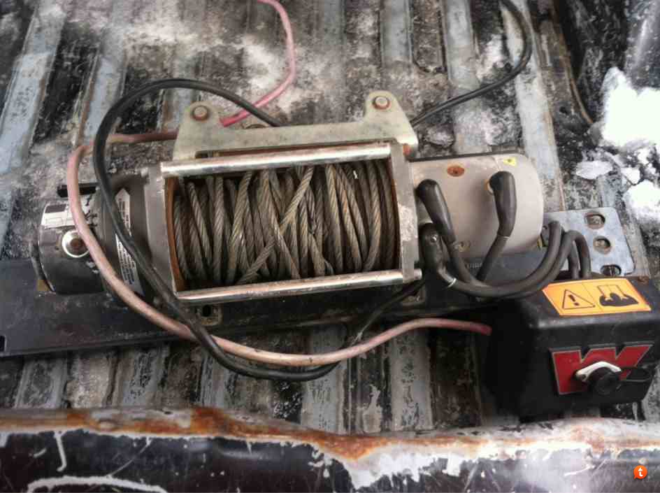

I spied this at the Jeep junkyard Friday when I picked up a hitch; they said it was being held till the end of the day. Went back this morning, it was still there. Scored it for $150.
Needs a clutch lever and remote plug-in repaired, but otherwise works fine. As far as I can tell it's a M8000, haven't ran the serial # yet. It may be installed before WF if I get the rest of my list completed.
Warn is closed for President's Day, I'll have to confirm the model tomorrow.
I might bring it Saturday, but it would be a bumper ornament only unless I can track down a new 5 pin remote plug ASAP. The clutch lever would be easier to replace off the jeep anyway.

How about a 5 pin or 6 pin RV plug? Sticking to factory parts may be nice but I bet a small T-handle style RV plug would be great.
Identify a warn service center from their page. They always pawn there service to their network from what I remember.
WARN Service Linky

Anybody know if a motor swap would make it a M8000? May be cheaper in the long run to rebuild it as a 8k winch.
Researched this a bit... the M6000 and M8000 are identical with the exception of the gear ratio. M6000 is 156:1 while the M8000 is 210:1. Line speed will be faster with the M6000, otherwise they run the same motor and whatnot. I am going to run it for now, maybe upgrade in the future. For the wheeling I do and the way the Jeep is built it will be just fine. Probably won't be used more than a handful of times a year. I already have a ZJ alternator to swap in, will need to upgrade battery down the road.
Being a Warn and not a Chinese winch it should be plenty stout and reliable. Plan is to fix the wiring issue and mount it up for WF. I can swap the clutch lever later on, just have to power it in and out for now.

That's interesting, funny that the M6000 is more expensive than the M8000, and it's just a different gear set. Worst case if you are in deep then you will stall it out, but in that situation an 8000# might do the same thing.
You might already know this, but powering out a winch goes against the automatic brake and they get very hot, so you only want to do that for short periods of time if you can. That's the official word, maybe in reality it's less of a big deal than they make it.
