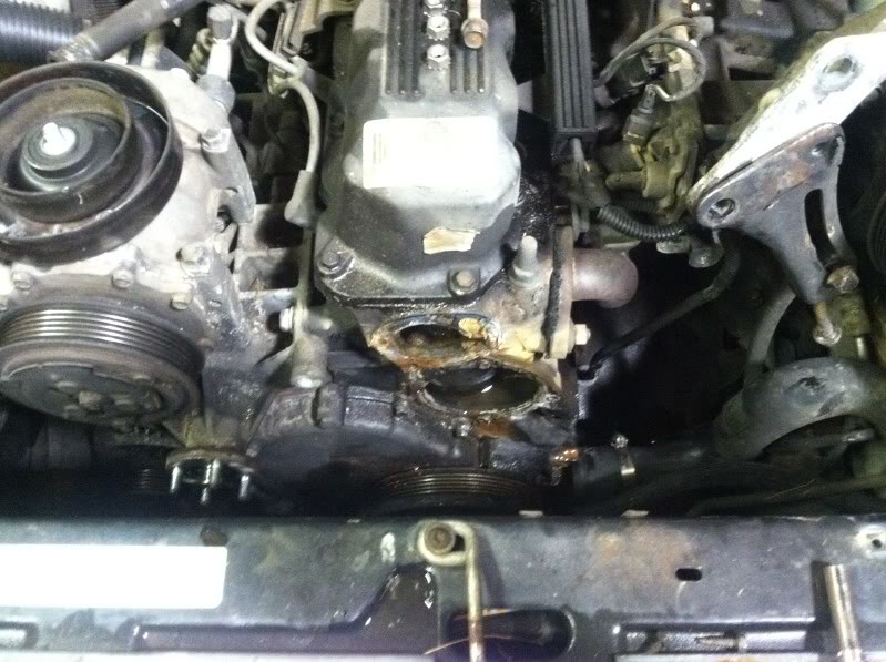

Leak problem removed (and finally fixed). Thanks Chrysler for making the PS pump bracket bolt to the water pump :rolleyes:

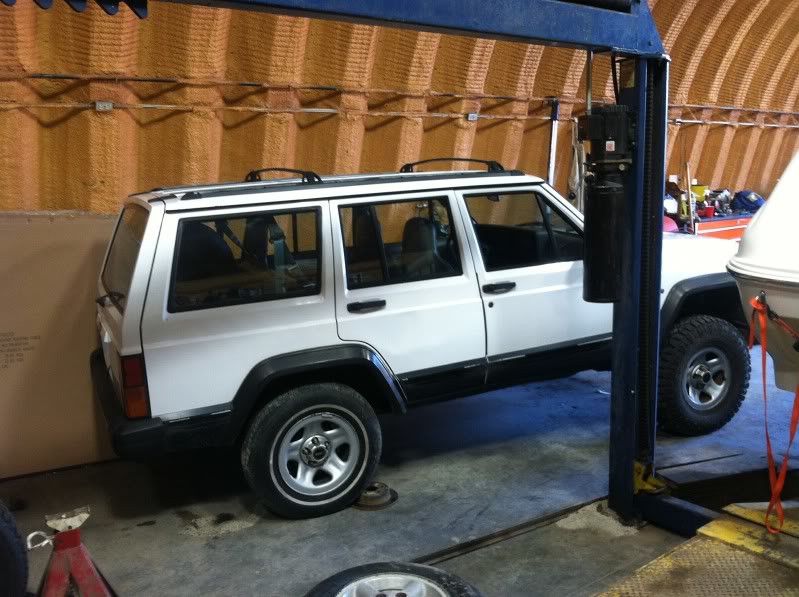

Backed it in the shop and got it set up to pull the front axle tomorrow.
Roundabout plan is to swap the front axle, drive it onto the lift, swap trans/t'case, drive it off the lift with the front driveshaft and then swap the rear axle. Thanks JIM for the idea, I was going to do it the hard way and use the wrecker to move it around :D
Poor little guy has no idea what is in store for it :D :D

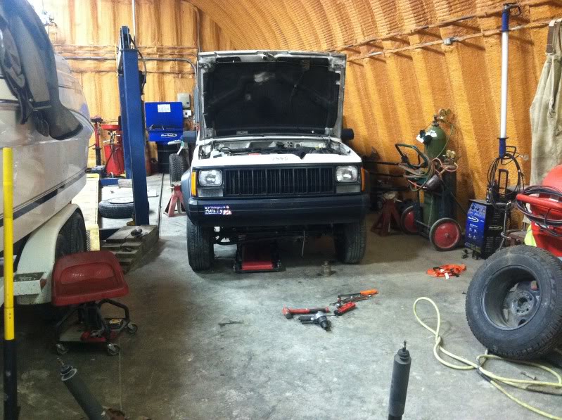

Made progress today.
Out with the old;
And back on it's feet, 3" higher and with a diff.

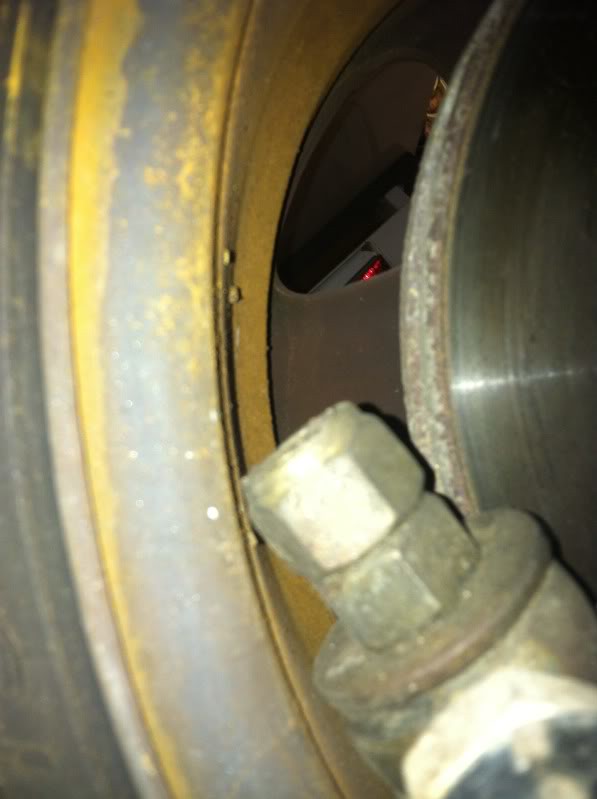

This is why IRO says you have to run wheel spacers with the 5/8" steering:
It's not touching, but about 2 playing cards away. It will work for now, wheel spacers will be added later.
