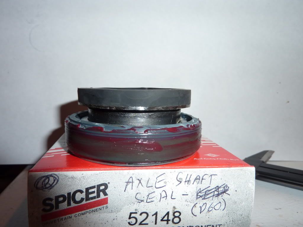

The part of the seal that interferes can be seen below. The seal on the left, the smaller diameter rubber coated part that faces the middle of the picture. It hits the tube tube and either bends it out of wack (yes, going in straight) or binds.

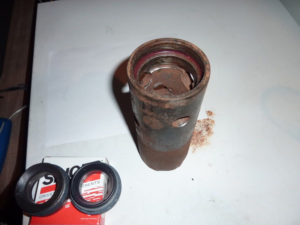

So it looks like I'll have to run the less desired seal and hope that I don't have gear oil coming out my tubes. This seal pictured below.

So, I decided to try grinding the metal lip off and then took a little off the rubber axle guide as well.

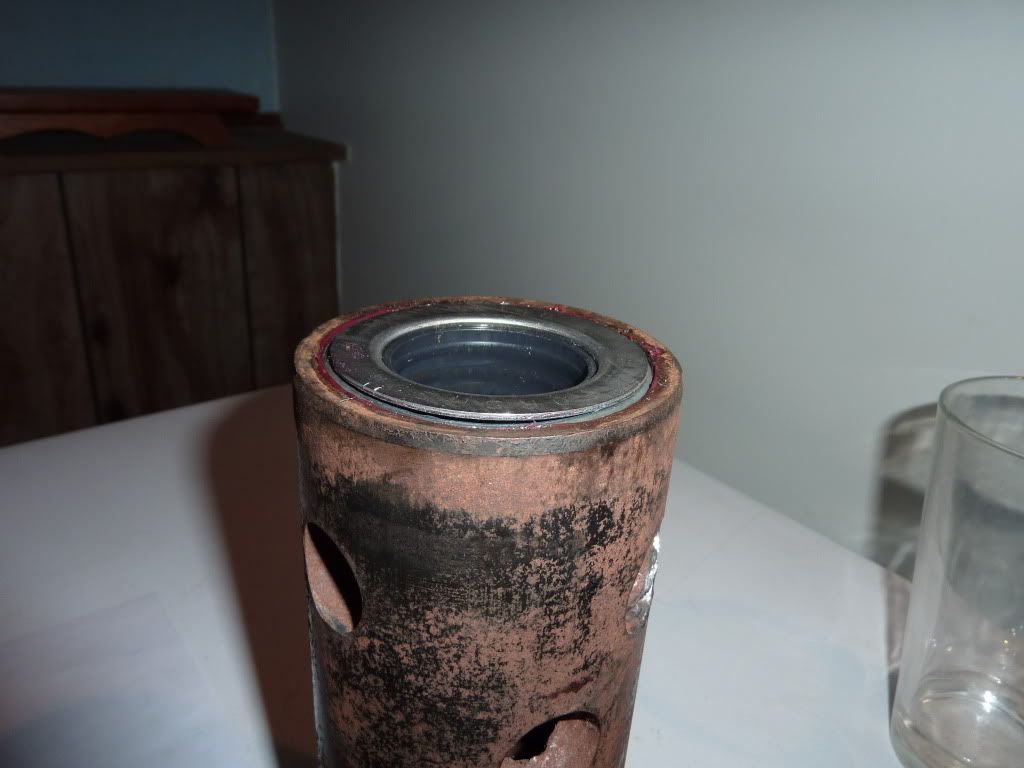

After this, the seal installed in the tube bore while allowing the inner portion to be free from interference.

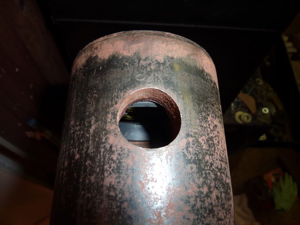

Here is a shot through one of the holes where one can see the rubber of the seal just clearing the relief cut in the end of the tube.

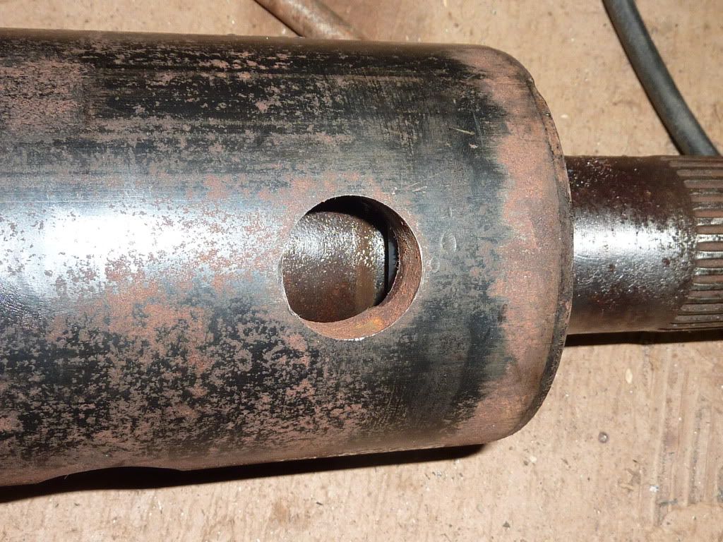

Here an axle shaft is installed through the installed seal. I found the inner portion of the seal wanted to push through the portion pressed in though. Previously, the lip I ground off would have prevented that.

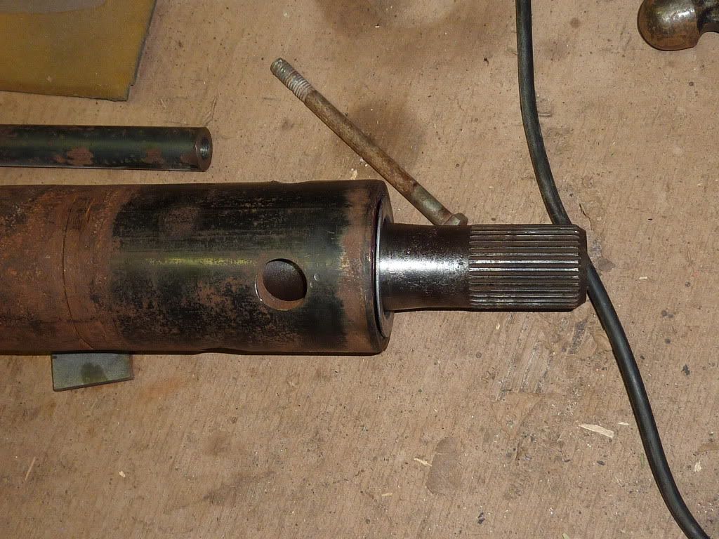

Here is the seal and axle shaft through one of the plug weld holes.
So, this modified seal should work as long as the inner portion is not pushed far enough beyond the outer portion to damage the seal during axle shaft installation. Perhaps the shaft could be pushed in beyond normal and then pulled back out a touch to align it in the steering knuckle? This would tend to center the inner portion on the outer portion better.
