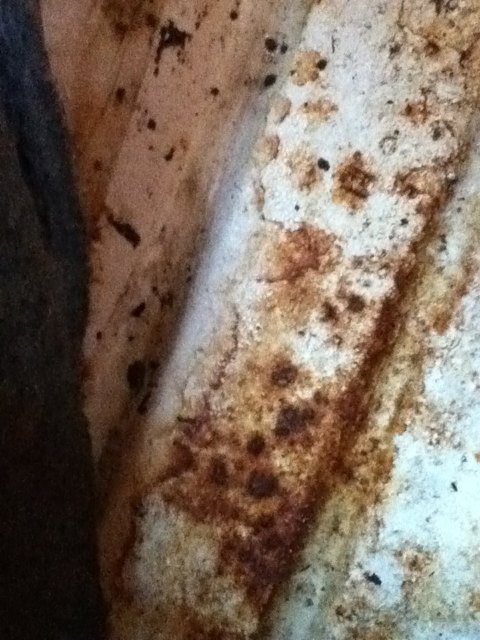

Well I'm trying to fix the leak in my passenger side and its worse than I thought, not major but worse than what I was hoping for
It's pretty soaked, trying to dry it the best before I seal the plug. Since there is surface rust what should I do? Just grind or sand down to bare and then hit it with a rust protector or something else? Trying to stop it before it gets worse
I just patched mine a few weeks ago. The worst section was right over the muffler about 14" x 14". I gut all the rust out, primer, paint. 18G galvanized sheet metal patch with sealer. Next will be a heat shield between the muffler & floor board.
Good news is that's surface rust as I can tell so ill sand it then spray it. Just curious if I should use rust blocker or rubber over spray?
Bad news, still after sealing up the hole, there is water still getting in some how? And it's bad. I can't figure out where it's coming from?!?!? The only explanation I have is that I notice when I have the defroster on I can hear water trickling on that side? Now I've been trying to find the source but I'm freakin clueless????
Anyone have a suggestion?
Ok both my 89 & 93 leaked. 89 was from the heater core. I figured it out by blocking the heater hoses so water didn't get into the core, no more leak. My 93 was leaking somewhere from the windshield. So I sealed it with urethane. Sealed it between the trim & body, then trim & glass. So far so good.
heater core is that black roundish thing on the passenger side right? because on the inside I noticed water was coming from some black thing sticking out underneath the glove compartment
Heater core is inside it, it looks kinda like a mini radiator. The engine hot water flows through it, a fan on the back side pushes the hot air through the ducting keep you nice & tostie. Mine leaked where the copper hose fitting went into the body of the core. But like I said easy to figure out. You just have to go with out a heater for a day or 2.
Ya it's the heater core or seal, didnt run the heater and there hasn't been a drop of water :/ eh I guess I'll just wear extra clothes till I get time to fix it lol
