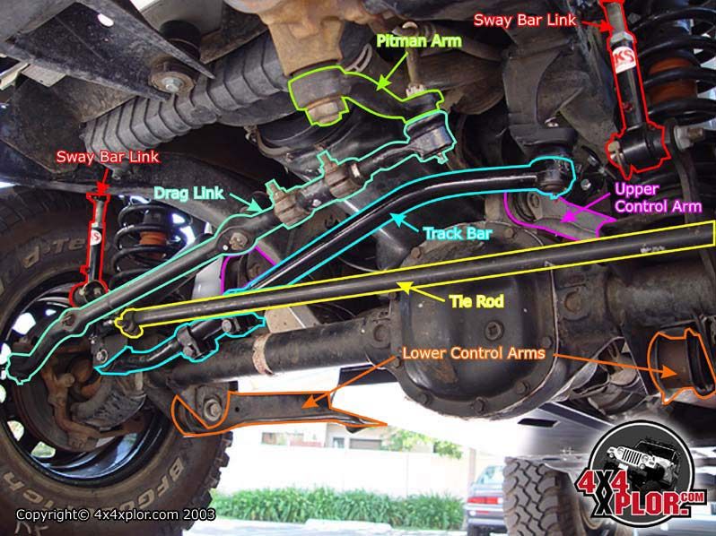

The problem could a cheap lift kit, improper installation, incorrect alignment, previous owner Bubba style engineering, lack of required parts for a 4" lift, or perhaps worn suspension or steering parts.
You need to provide a complete inventory of the parts used for the lift and their apparent condition. You can't fix what you have not diagnosed. Lots of well lighted and well focused pictures of the front suspension and steering are good.
A front sway bar is very necessary and typically a steering stabilizer is beneficial. If the lift suspension is good qualty parts, a rear sway bar is typically not necessary.

Tim's advice about pictures is spot on. Get us as much detail as possible. Odds are good that the pictures will lead to more questions and the need for more specific pictures.
35" tires are pushing the upper limit of what should be on an XJ without major modifications. 35s still require some important upgrades to be feasible.
in addition to pics, you need to physically grab everything pictured above in color and give a good push/pull. a lot of these parts can wear out and leave you with shady steering and control of the vehicle.
also a video of suspension when cycling steering left and right with tires on the ground would help. upload it to youtube.

Link didn't work for me. I do wonder if this had stock upper and lower control arms, and what the condition of the steering gear box is?

Tires that big put a lot of stress on the steering box, which is factory mounted onto sheet metal. If that mounting surface hasn’t been substantially reinforced, there could very easily be significant cracking and flex going on around the box, which will make the steering wonky. So that’s something to look at, and also to post photos of.
