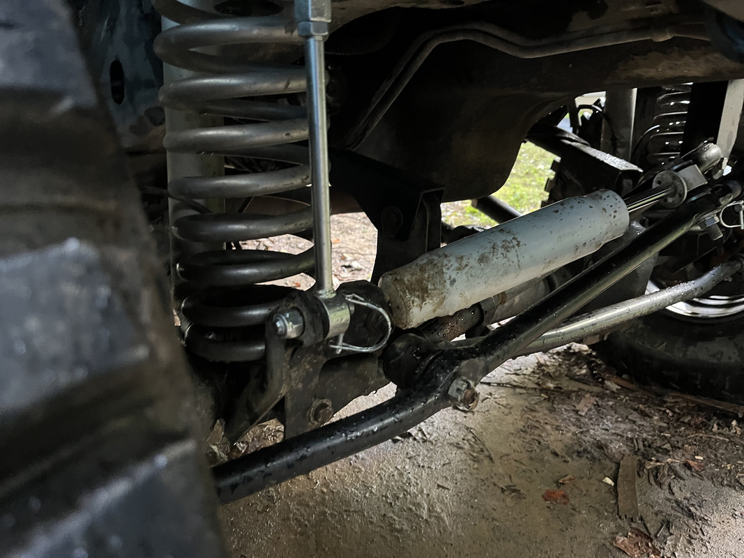

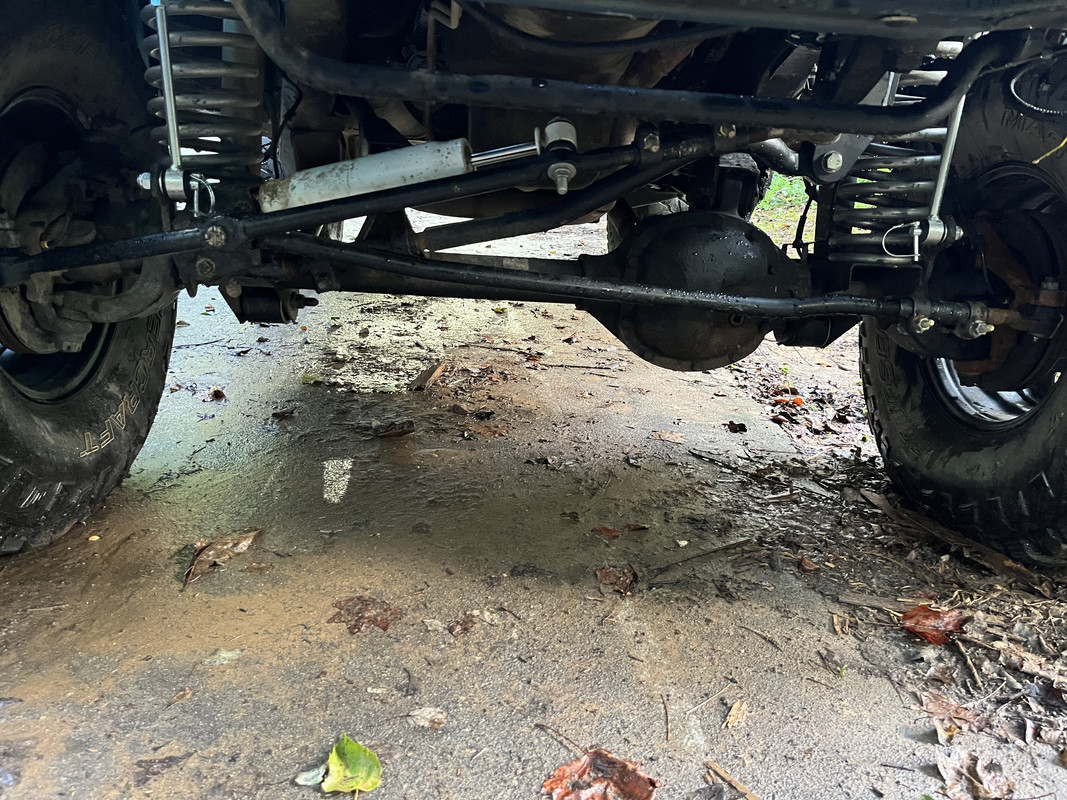

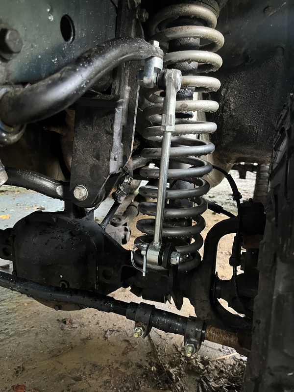

You do not have drop brackets and that is a lot of the stiffness in front, get db's or la's to fix that.Take a pic of the rear shackle angle, you can get a extended shackle and lose the add-a-leaf that will soften the rear. Your trackbar/draglink angles look a little questionable.
I have 4” rough country leaf springs for the rear. Just haven’t installed them yet. Do I still need any kind of drop shackle?
For the front, isn’t that lower arm adjustable? Isn’t that what I want? And I’m not sure about the actual lift height. I guessed it 4.5” based on components and height.
