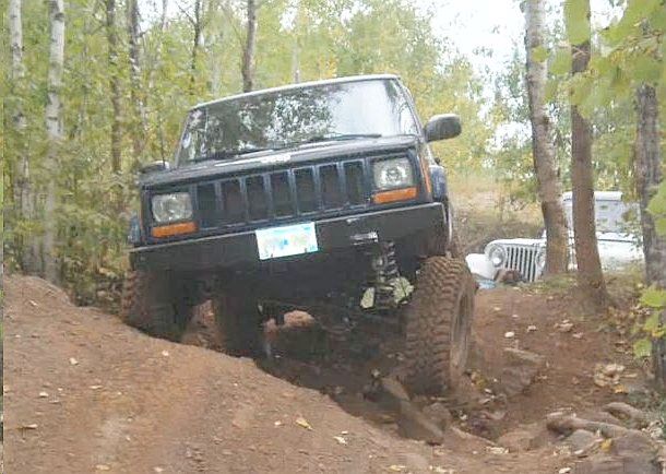

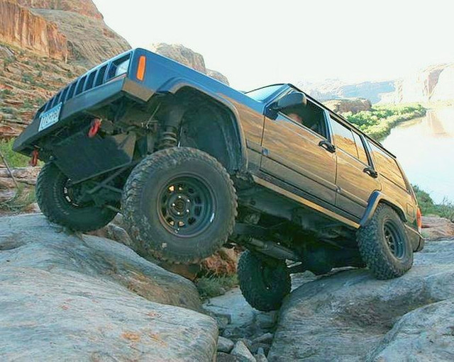

I have done the single locker pick an axle thing on both my CJ-7 and my XJ.
IMO, a rear locker has the best trail performance. The reason why is weight transfer.
My CJ-7 was first to get a locker. Off-road capability is improved. The CJ front axle with locker will get to the top of almost any obstacle, but often the front tires just scratch at the dirt while most the weight is on the open differential rear axle. The XJ was next, and got a rear axle locker. It never has had huge issues with the open front climbing a log or rock wall with the rear axle locked, although now with both axles locked it can walk up just about anything.
Your off-road mileage may vary, statistical sample of only two vehicles.
