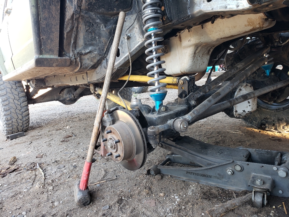

You may want to Also look at steering. When I started going fast my frame started coming apart just as fast.
Its now plated outside and inside with a crossmember supporting steering box.
Wj steering with decent angles is very nice while busting badger holes at 50. Also works extremly well running down the freeway.

Most important when all is said and done a sledge hammer is still the best tunning tool there is
