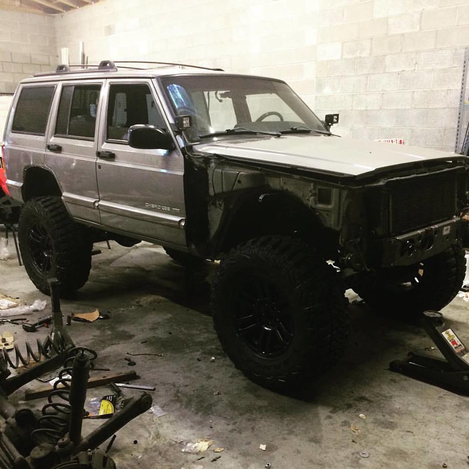

Had a decently productive day today - had a buddy who is a welder for work come by and help me with the rear fender chop - he did a really good job. Just need to flapper down, hit it with some top secret and bolt the Hooligan fenders on!
Kittrell and I reamed the knuckles and mocked everything in, then we tacked the sway bar links, final welded the links and the driver side Artec truss. Axle is headed for sandblast tomorrow, ARB and R&P being installed on Thursday after a couple coats of Top Secret paint.
Hoping to get the Hooligan front stiffeners installed and painted tomorrow...it will be a chore but I've already removed 95% of the LCA brackets which IMO is the hard part...lol

Had really a productive day today - rear fenders all trimmed up - just need paint then the Hooligan fenders. Front end is about half put together. Lots of little odds and ends to put together. I forgot how much work these Jeeps are. :laugh:

Yep - flickr - now that photobucket brings the suck. Those rear wheel well welds were done by a body of mine - I didn't feel comfortable doing it and having it turn out even moderately decent so I turned it over to him. He spend a full day on each side :eek: . The driver side looks even better than the passenger side for what it's worth.
Got the fenders on today - need to work the front right a bit as it's not fitting 100%. Next up is to finish the front end suspension and steering.
