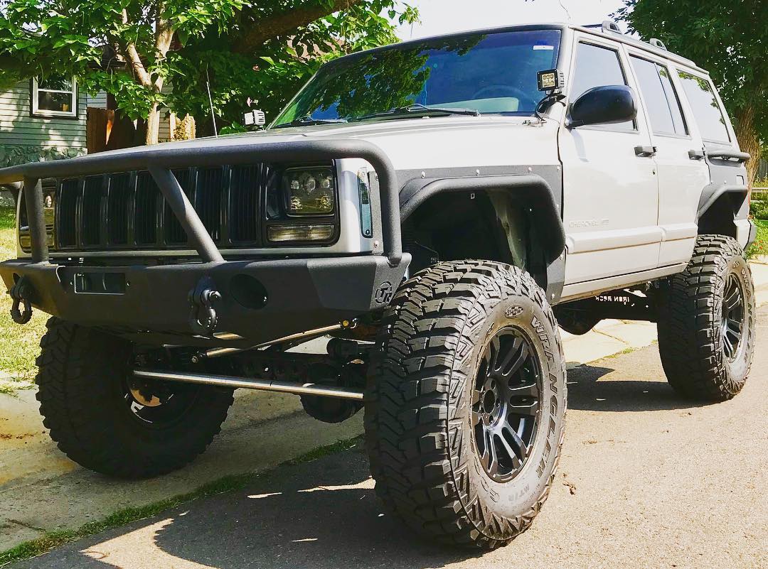

UPDATE: I had to turn it over to Hooligan Offroad to resolve the issue with the sway bar links interfering. I will get pics of it tomorrow, hopefully but basically on the passenger side, Josh @ Hooligan made a custom mount far enough up to clear all of the steering then braced it. He then was forced to modify my JKS quick disco (shortened it A LOT).
If that's the only SNAFU I have on what I did last summer, I'm satisfied.
Hopefully tomorrow I can paint the work that was done at Hooligan, install my JCR battery tray, and reassemble some of the interior so it's a little more driveable. I also feel like I need to add some washers to my steering box bolts as for some reason when I was putting it back together I neglected to put some in.
Attempting to get some wheeling done this season.
Updated pic, got it mostly drivable, need to re-affix the sway bar and add some washers to the steering box.
I also need to install my Ron Davis radiator and Hesco water pump.
Up next after that: AJ's rock sliders and TNT Tcase skid.
Jeep is coming along nicely, hopefully I'll catch you on the trail sometime soon.
