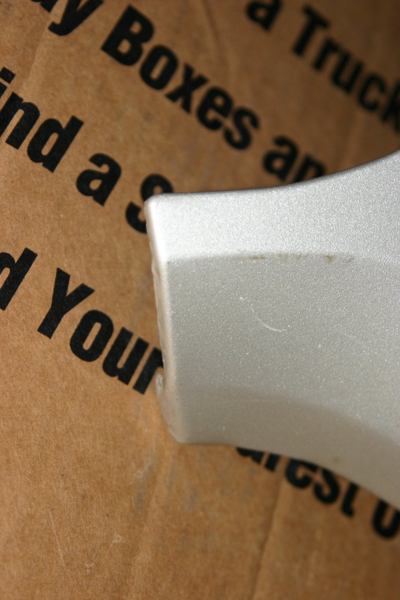

I've got the broken grill and it along with the tail lights leads me to believe that Alex parts is primarily exporting factory seconds, blems and pieces that fail quality assurance which might explain why the fenders were in various states of finish. I doubt even the Chinese accept this poor quality level in production vehicles.
Tail lights have area's that are hand touched up with epoxy where the plastic resin didn't penetrate the mold fully, the tail lights I got are not 100% identical. They look like two different suppliers they are close enough that you have to put them next to each other and really look to notice differences, one has clouded lenses. When I test fitted the tails I instantly broke the tab that slides into the lower anchor, super brittle didn't even take effort so be careful.

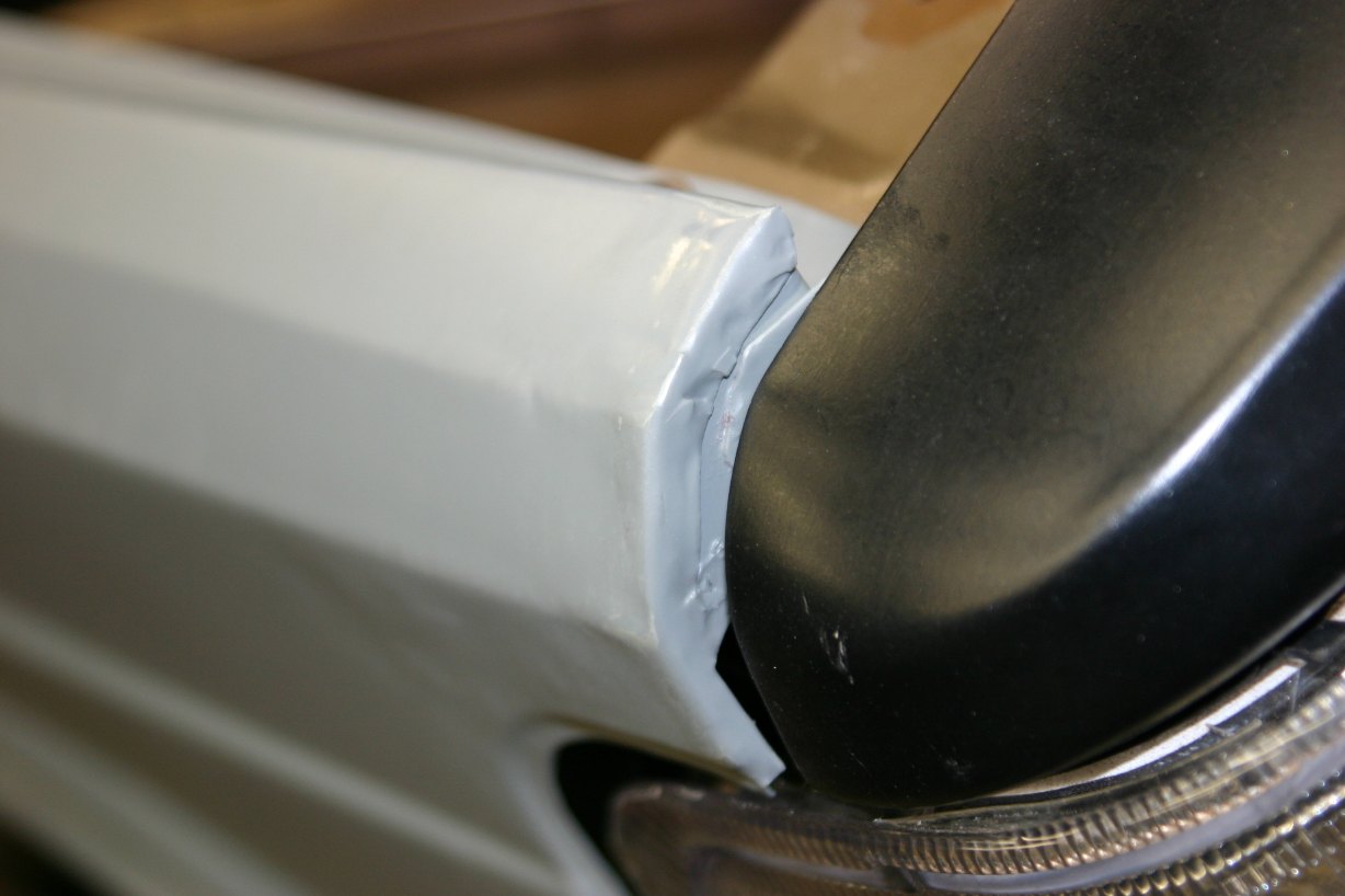

The header has some awful fiberlgass work. I think any future orders should take the old saying you get what you pay for to heart. I am almost scared to order a set of the composite headlights :)

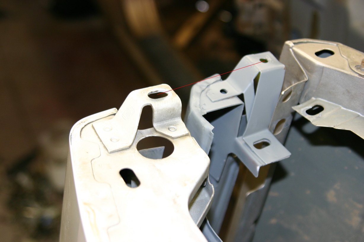

the header panel bolts differently on the 97+ fenders, but its not like its a deal breaker, I'm going to take a small piece of strap give it two little bends, drill one hole, and then spot weld it onto the US 96 fender. Problem solved.

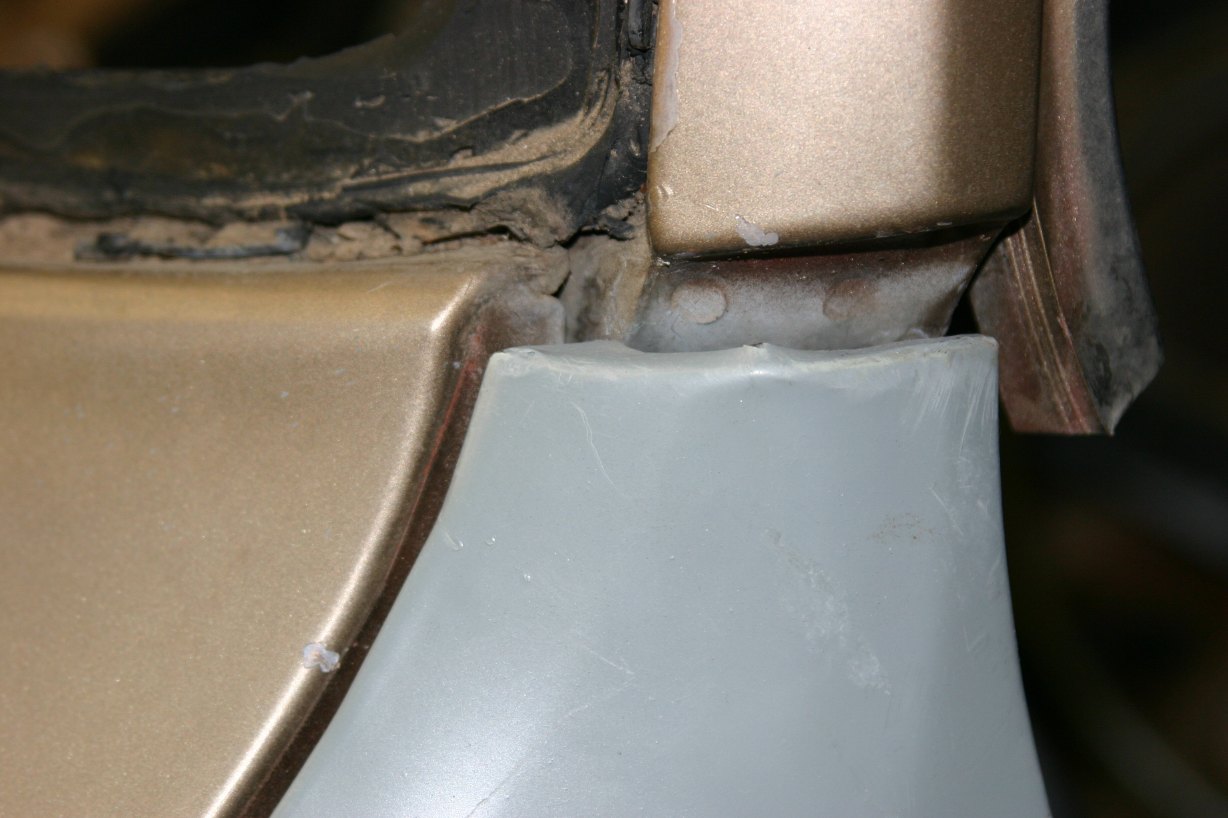

this gap gets better, but its going to take a lot of work to sit flush.
But then look at a US OEM fender, you can see that its many times better quality in the stamping.
All sorts of rippled and nasty looking:

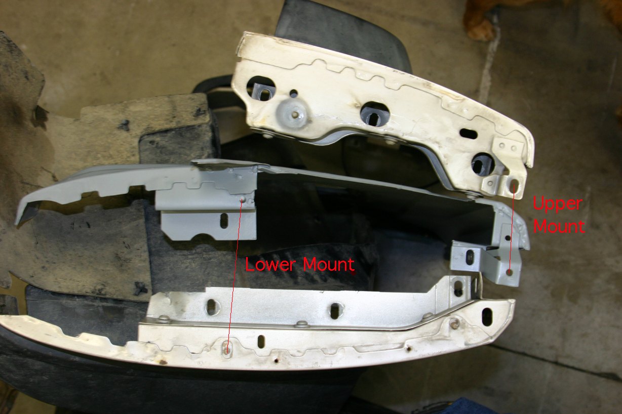

this is the upper header bolt that you want to duplicate:

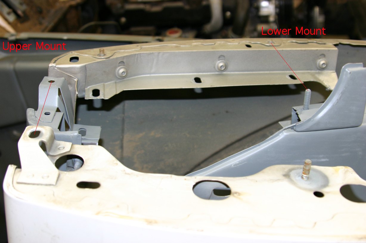

Once again you want to make a 97+ upper mount for the 96 fender, and then you want the lower 96 mount.
Also, this is what your bent over support looks like after modifying it to clear the 2500 header.

Just going to replicate the front mount on the Alex Parts fenders. The 2500 header uses the same metal 'L' bracket that mounts the US header to the core support. There are bolt studs located on the upper front of the 2500 fenders that tie in the outer part of the header panel.... they were just removed from it because I was doing some cutting and grinding. I'm also going to remove, cut and weld the inner brace (visible in the front-on picture behind the opening) when I go and slip in the header panel.
The 2500 header panel lines are not as crisp as they should be either so the area above the headlamp is going to need some work to get it to flow into the fender lines.
