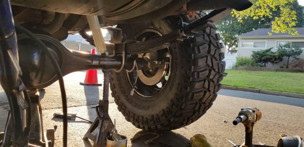

Had to drill a 9/16" hole through the frame which I did not have a carbide bit for so that was a pain.

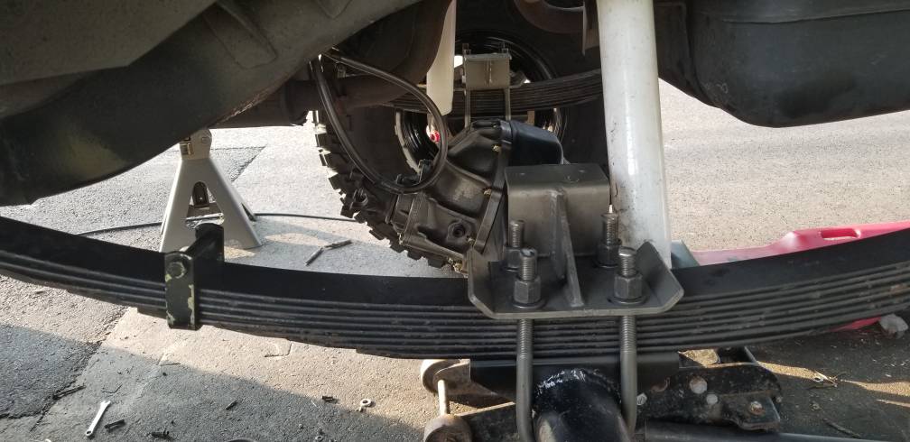

The rear was simply a leaf and shackle swap.
I'm still not positive I'm going to keep the FT leaf spring plates. It depends on where I end up mounting my rear shocks.

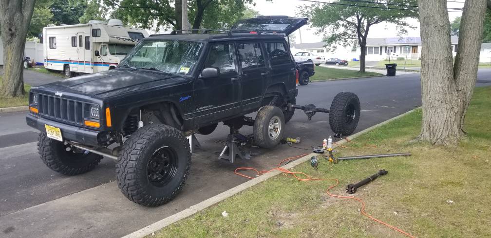

At this point I put it on the stock wheels just to see what it looks like.
Then went back and reamed the knuckles to 5/8" to fit the DBO steering kit. This is with the stock pitman arm but I ended up swapping to the 1" drop FT pitman arm.
and then realized this isn't going to work
So I grabbed some 2" spacers to match my new rear axle and let the stock wheels clear the OTK steering.

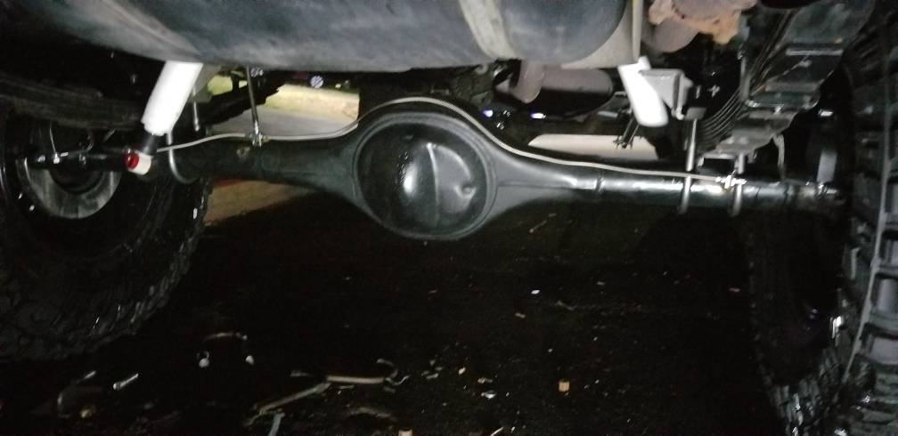

I tossed on some regular shocks that I picked up for $150 from IRO just to be able to drive around until I get my bypass shocks/cage done.
I also bolted up the stock front shaft for now after doing a JB Conversions 1310 SYE kit. I decided on the JB Conversions kit over the Advanced Adapters kit because their yoke has larger cut outs for more shaft flex and it's a 2" kneck all the way down.

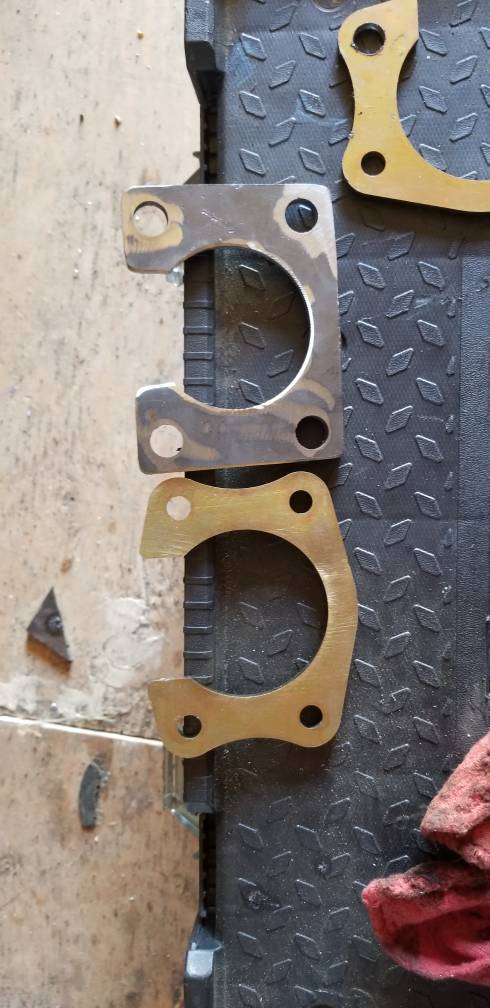

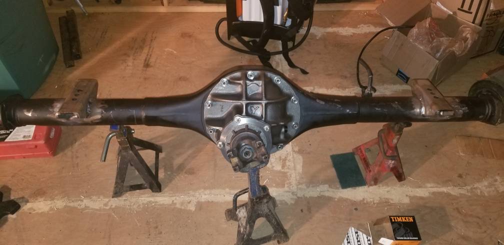

I also found a 79' Bronco Ford 9" big bearing rear axle. I pulled it apart, cleaned it up a bit and tossed a coat of paint on it to prevent it from rusting. I know I'll have to grind a lot of it off when I weld on the spring perches, shock mounts, and truss.
Not sure if I was suppose to get paint on the gasket surface. I also picked up perches from Barnes4WD. Going to make the shock mounts myself.
Going to bring the 9" over to my buddies garage and find out where they need to be for the pinion angle. If my math is correct and XJ spring perches are 44" center to center then I need to come in 7" from the end of the 9" (measured without axles) for the perches.

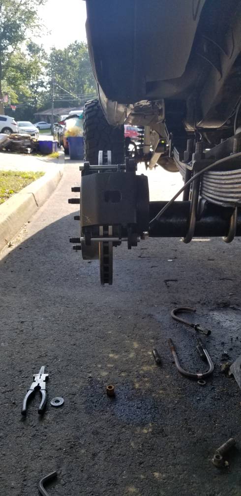

I also picked up 25' of nickle/copper 3/16" brake line and fittings so going to redo the brake lines. The front are fine but I snapped the rear removing the stock soft line.
Also going to be ordering a 9" disc brake kit. I haven't settled on a kit yet but leaning towards this one or a similar one.
https://www.jegs.com/i/Right-Stuff/965/ZDCDS05/10002/-1
This kit says it will fit with 15" wheels so hopefully that is true and I can keep my stock wheels. I'll just need to take my stock 31 spline axles and have them redrilled or pick up a new set already drilled for 5 on 4.5. If I have to replace them I will most likely make the jump up to 35 spline shafts. For lockers I will be keeping the front open for now and doing a detroit in the rear. I can get a used detroit of ebay for $200-ish but I have not seen a 35 spline detroit except new for around $600.

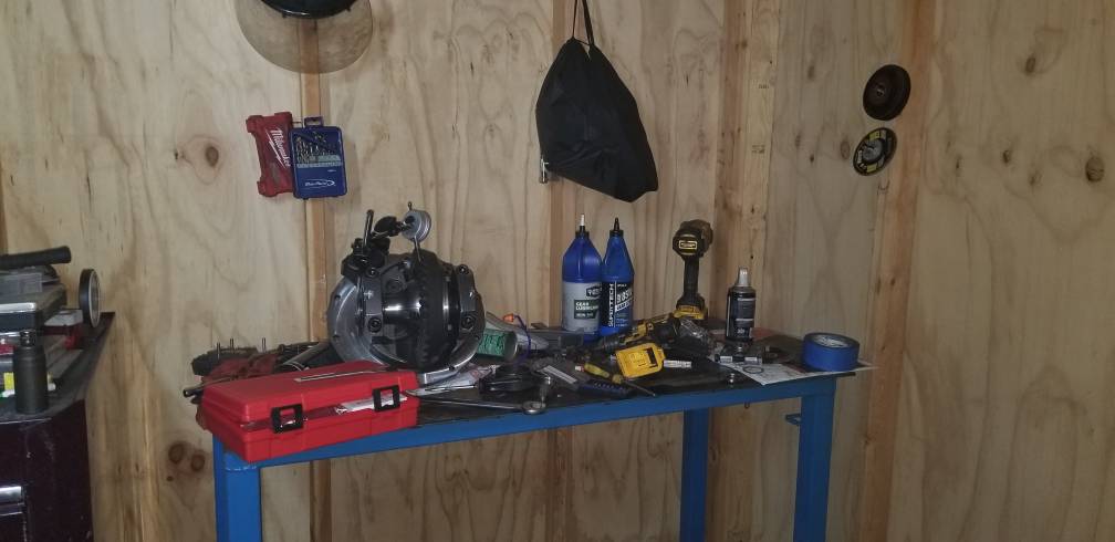

Got the detroit in the 9". Only took me about 18 hours working in the corner of my shed with a small led light (electricity not run to the shed).
I've never done gears before so invested in a magnetic dial indicator, inch lb dial gauge, home made spanner wrench, and rented bearing/race press cups, bearing race puller and accompanying slide hammer from autozone.
I original was going to run a crush sleeve eliminator but the one that came in my kit was too thin and didn't have enough shims to even contact the bearings on the pinion. I went through 2 crush sleeves before find out a trick to make it easier to crush them.
I assembled the pinion and bearings into the Daytona pinion carrier and push the whole assembly in my press. Then pressed out all the slop until the bearings were seated in the support. Then put the yoke in my vise and used a 3ft breaker bar to tighten the pinion nut until I had resistance turning the pinion support.
I would tighten a little and then check the preload on my dial indicator.
Then adjusted backlash and verified on multiple sections. Spec is 0.006-0.010" and I'm at 0.008.
Then I ran a pattern with the marking compound and was able to get a good pattern. I started off with a 0.020 shim, went up to 0.045 then 0.027, then 0.035, and ended up at 0.039 asy final pinion shim pack.
I then ran a die over the housing Studs and cleaned up the threads. I still need to pull the 3rd member and put on a lube locker gasket and pinion support o-ring. I just stuck it on the housing so once I press on new axle bearings, axle retainer plates, axle bearing seal, and axle bearing retainers I can put the axles in and get my brake caliper positioning to weld on the caliper brackets.

Ordered the wrong axle retainer plates so I made my own out of 1/4" instead of the 3/16" these came in.
Then cut off the old bearings and seals. Pressed new Timken bearings and seals. Installed the 3rd member with a lube locker gasket. Torqued everything down.
Got the 9" swapped in.
Stops much better now with disc's in the back.
Was 95° out and welding on the blacktop was so much fun and fun fact sometimes if you touch something you just welded you can hear your skin sizzle before you feel it lol.
I started at 2 and finished at 9. Only had to run to autozone twice (caliper guide pins, brake hard-line fittings). Although I do need to go back and return the fittings I didn't use. Wasn't sure on the thread size so I bought them all. Toss in a pizza break, and having to explain what I'm doing when my neighbors come to chat. The more I do to the Jeeps more and more people keep stopping to see what I'm doing now. I'm almost dead center of my development but my road is one of the main roads through the development so I'm collecting some fans
I may end up switching the caliper pins over to another set they had at autozone that has a cotter pin in the end so if the pin backs out of the caliper mount it cant completely seperate and will prevent you from losing a caliper.
Now it's a 98 Jeep Cherokee with a 79 Ford Bronco read end and 78-88 GM big bore calipers which can be found on the front of an S10 up to 2002 . The calipers I got from Speedway motors because they are affordable, came with pads, and have a larger metal piston at 2.75". These combined with the Dodge Dakota master cylinder upgrade the brakes work fantastic.
I ended up cutting the stock shock mounts off the c8.25 and used them on the 9" until I get bypass shocks and pull them up through the floor. I already have barnes4wd mounts to go on top of the axle .
