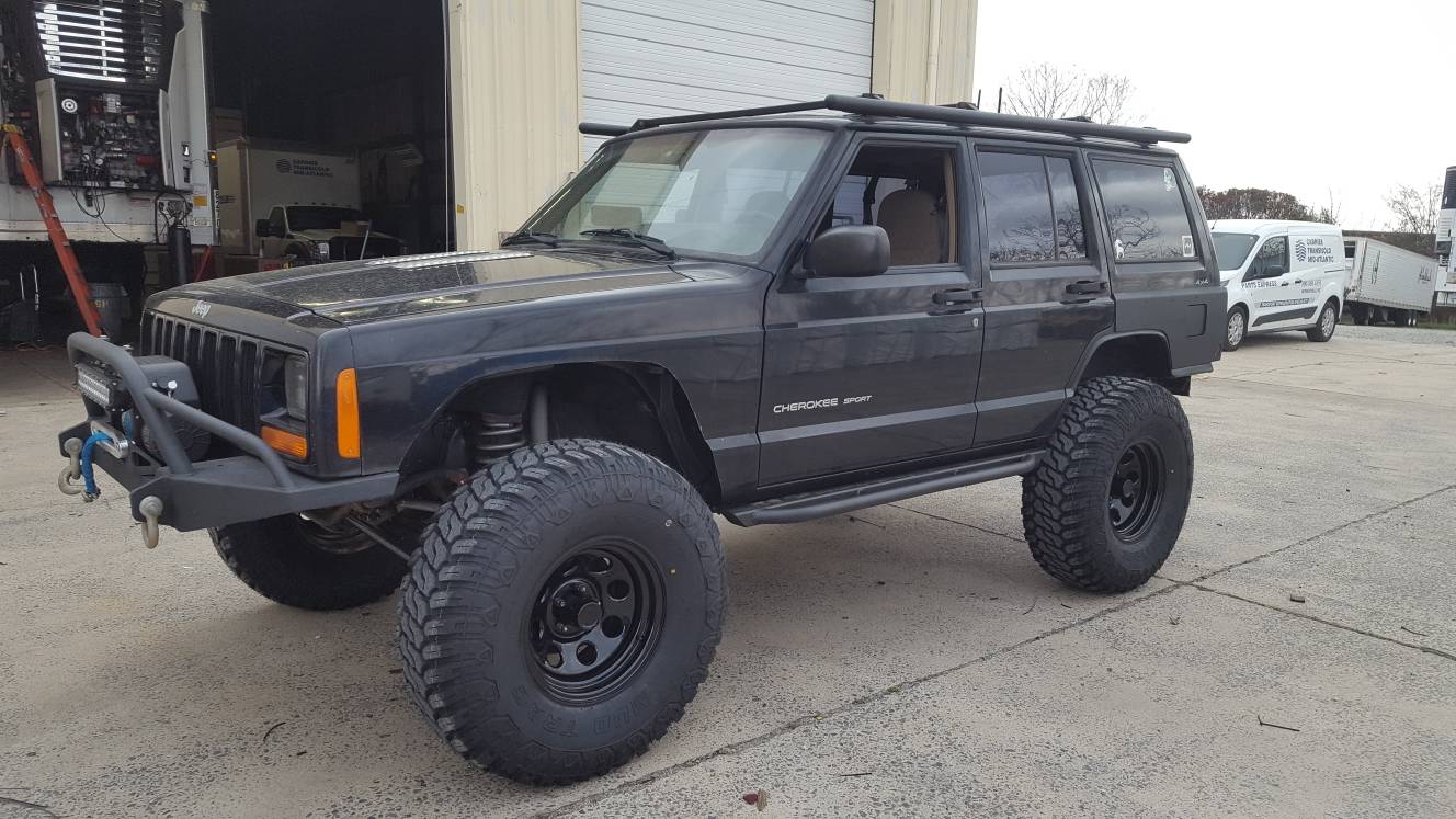

Hello all! Been creeping on here for a few years, but haven't posted yet. I'm about to start building my 00 XJ. It'll be primarily a rock crawler, but I will have to drive it to the trails(Atleast for a few more years). Right now it sits on 4.5" RE front coils, 3.5" RE rear springs, 2" lift shackles, HD offroad no lift shackle relocation brackets, Chrysler 8.25 3.55 gears and a lockright solid diff cover, relocated axle shock mounts flush with axle tube, HP D30 3.55 gears and a lockright ruffstuf diff cover, RE fixed LCA's, Currie LCA skids, RE adjustable track bar, HD tie rod, RE sway bar discos(red ones), 35 12.5 15's, NP231 with SYE (don't know the brand), transfer case skid, JCR quarter panel and taillight armor, roof sliders (not sure of brand) JCR rock sliders, had a old style JCR winch bumper(selling it today, switching to a stubby bumper haven't settled on a brand yet), 8K Traveller synthetic rope winch, 98 Xj 4.0 with adapter plate for intake, coil packs just sit there with no hold down bracket, e fan switch in cab, AW4.
When I bought it it was sitting in 31's, shackle relocation and shock relocation were not done, and the front coils were 3.5, so it sat raked in the front. Took it to Uwharrie a few times and was pretty impressed. Went to 35's over the winter ( wanted to be able to get up the first ledge on Daniel) relocated the shackles and shock mounts and swapped the 3.5 coils to 4.5, and trimmed the fenders a little more. Got to take it one more time before My wife had to dd it for a few weeks while her Tahoe was in the shop and the radiator blew, and blew the head gasket.
So that's when I decided that it was time to build it the way I want it. I'm on a limited budget due to have 2 young kids, but times not a factor since it's not a DD. Plans are to keep the axles, and stay on 35's. Going to re-gear to 4.88's maybe 5.13's, keep the lockrights. Bump stops front and rear. Rear shocks through the floor. Frame stiffeners. Pull the motor trans and t-case, address all leaks and minor issues. Those are the things that are set in stone(for now).

Some pics of when I bought it last winter and after I leveled it out and put 35's on it
Howdy, personally I'd swap axles if you want to go to a 5.13's. 4.88's would be the max I'd go on a D30 and 8.25. As for your lift and steering ?'s If you want a 1 ton set up the Currie system is awesome but $$$. I'd look at doing a WJ swap as it will address a lot of issues and improve steering geometry and bigger brakes is a plus. Stinky fab has a kit that allows you to piece together your own parts for a decent price. I'd avoid control arms and just go with a long arm setup. The IRO isn't a true 3 link, it's a neat concept but the pinon caster thing is an issue. If you want to 3 link Clayton hands down, but again $$. You could also fab your own links if your feeling frisky. I'm not a fan of radius arm set up's but some are. Serious Offroad has a great setup if that is a route you want to take. Good luck!
