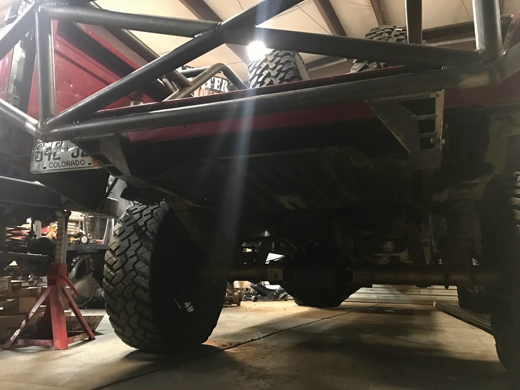

I had a few free hours this week so i worked on my bedcage a little bit. I havent tig welded in almost 10 years but i thought it would be fun to give it a try so i tig welded the caps on the tube at the back of my bedcage and surprisingly they didnt turn out too bad! Not alot of progress but ill throw up a couple pictures anyways...

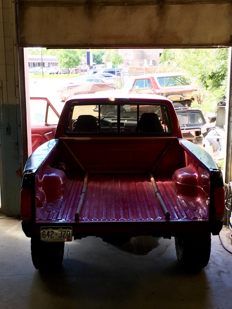

A little surprise showed up at work today
They took a little longer then expected to get and i had a few small issues with Roadrunner, the shipping company fiberwerx used, but they are finally here and in one piece and im happy!

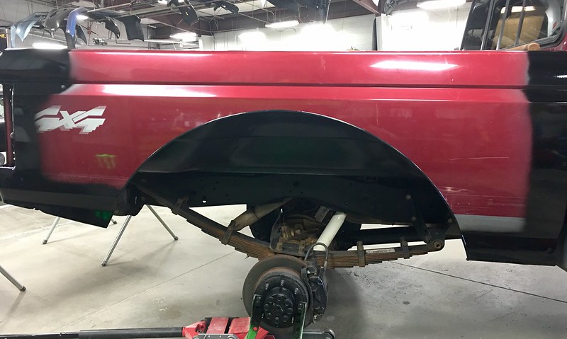

Everything looks pretty good and the fiberglass is nice and thick. You really notice how ripply the fiberglass is when you see it in person since everything is gloss black, but thats the norm for offroad fiberglass. The only issue i have is that one of the fenders is covered in superficial spider cracks in the gelcoat.
It looks like the gelcoat was not allowed proper flash time in between coats or was put on too thick. This wouldnt have been a big deal if i hadnt paid $140 extra to have them gelcoated black instead of the standard white. I wasnt planning on doing anything to these fenders other then bolting the onto the truck, but now ill be priming both of them before mounting so the black gelcoat was a big waste of money.
I blocked the whole fender in 120 and everything came right out and 99% of the ripples and waves blocked out too, so now my fenders will look really smooth and straight once theyre primed and painted. Tomorrow ill re-block the fender in 180 then prep it for primer and start on the other fender, working on the glass a little here and there after work. Once the bedsides are mounted I will most likely block the gelcoat and then prime and block them as well.

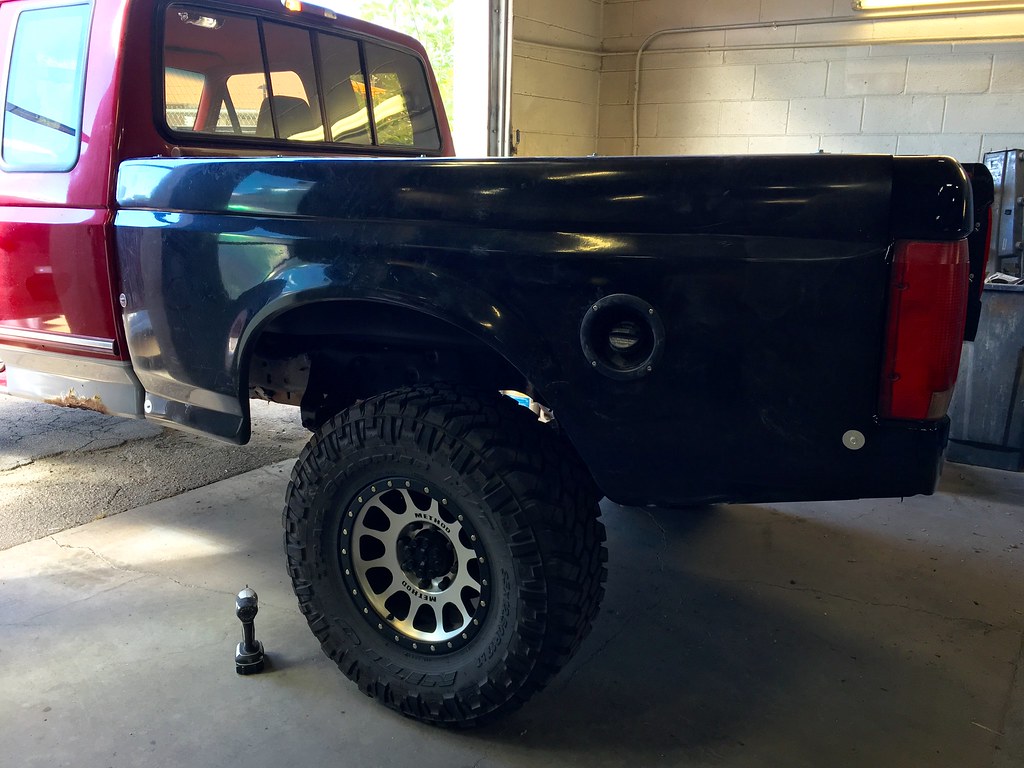

finally got around to mounting these POS Fiberwerx bedsides....well i got one side 99% done. I paid extra to have the tail lights left blank. Fiberwerx took a normal pair of bedsides that already had the tail light pockets cut out and fiberglassed over the holes, then put about 1/2" thick bondo on top to smooth it all out.
The back of these bedsides were so f***ed up i had to end up cutting the back of the bedside off. I was extremely disappointed in how i ended up fitting these, definately not as clean as i was hoping, but now that everything is painted it doesnt look too bad.

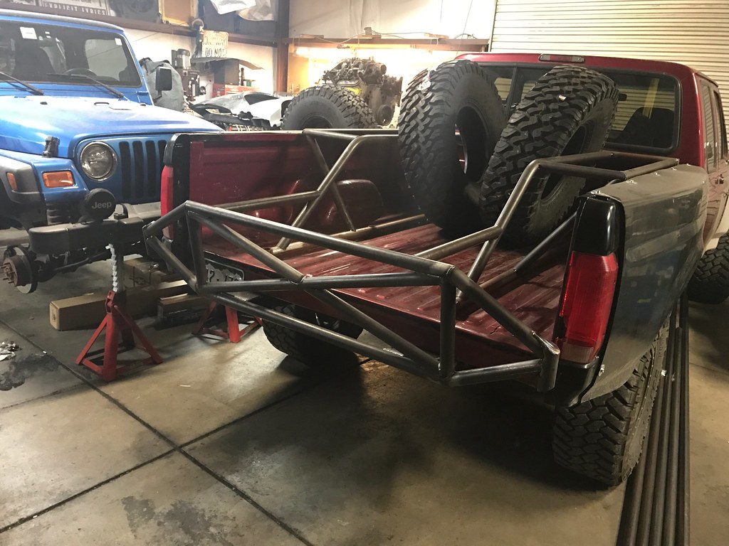

I have been working on the truck a bunch in my free time over the last week. Along with some help from Jon down at the flop shop, we have been making some good progress on the back of the truck. Lots left to do still but heres a couple teaser pics, enjoy!
