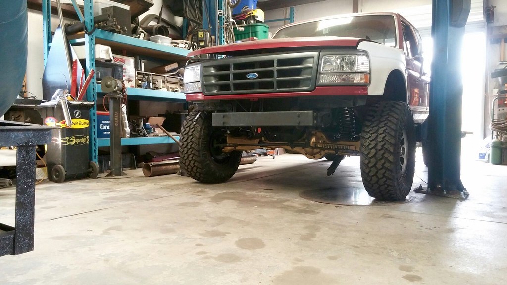

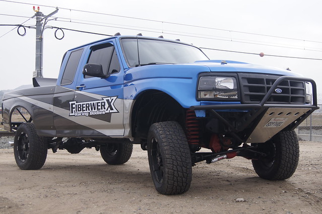

Can't stand those bug-eye projector lights. Half the time I see a vehicle running those kinds of lights, one or more of the damn things is burned out/not functioning.
I thought these looked good.
These appear to be clear lenses with black bezels?

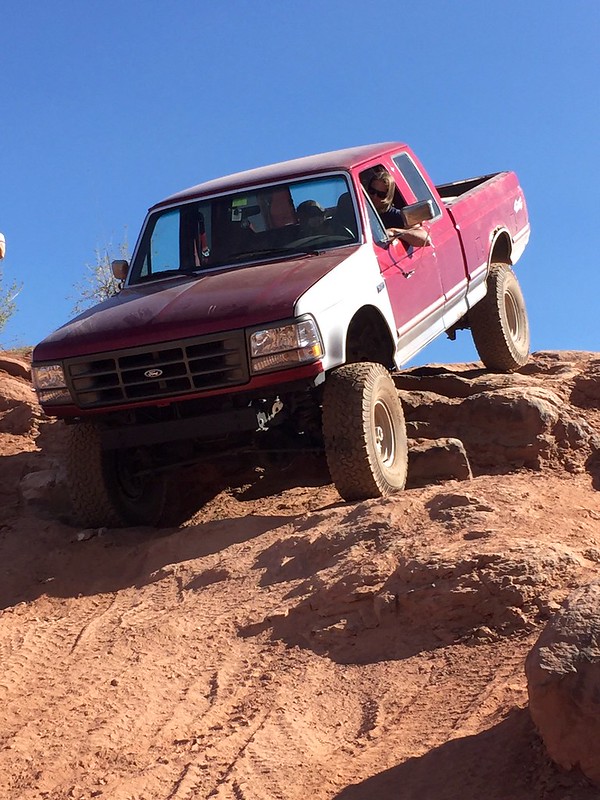

We ended up running Seven Mile Rim trail and man did we have a great day! Apart from a few snowy drives to work this winter ive never even had the truck in 4wd or in the dirt so i wasnt sure what to expect out of it. I babied the truck most of the day since it had to get us home and its my only vehicle right now. But as the day went on and i became more confident in the truck i started trying more and more obstacles, other then wipeout hill id say i did about 90% of the big ledges/climbs/drops/obstacles we came to.
Ive never had something with such a long wheelbase (138"ish) and i know it wouldnt make a good rock crawler, but man was it fun to take it up and down waterfalls and ledges...it walked through them like nothing. There were even a couple where the cherokee and jk would spin the tires a little and my truck would go right up.

p.s. I went with the all clear lights!

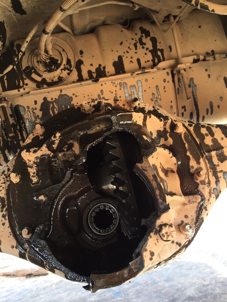

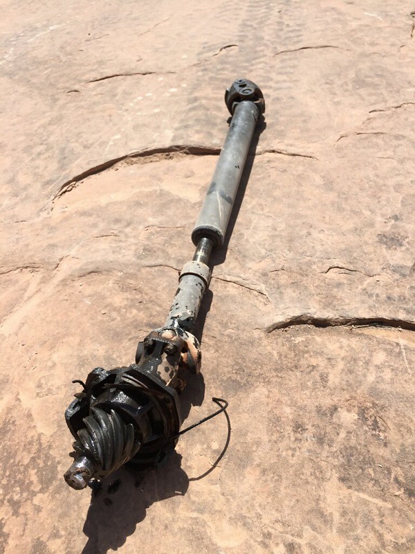

So we were sitting around the campfire saturday night talking about 14 bolts and 9" rear ends, Aaron (the new owner of my old xj) was talking about building a couple fabricated 9" housings for the xj that he picked up last year off of craigslist. A friend of mine buys the factory brake 14 bolt rear ends by the pallet full and sells them for $100 so we were telling him to stop wasting money on shitty 9" axles and just build a 14b and be done with it. He texted me this picture before we even got home on sunday....
He is staying out in moab all week so he went and ran rusty nail after we left, I guess he did the whole trail and was playing around on a small ledge at the end of the trail waiting for a buddy of his when he heard a loud pop about halfway up the ledge.
First a factory shaft broke going over a small rock @ ram when i owned the jeep and destroyed the dropout and ring/pinion all at the same time. Aaron bought the jeep and put chromoly shafts in the back and picked up another factory dropout to get the jeep going again. I know it was just a factory center section but damn....what a catastrophic failure failure for such a small obstacle he was going up.
If you are planning on running a 9" in your jeep I would highly recommend just sticking to an 8.8 a 44 or stepping up to a 14. Even if you are planning on buying a good pinion support, good center section, chromoly shafts, and disc brakes...you will still be stuck with an axle with a weak housing, ridiculously small pinion, small carrier bearings, and worst of all it will be a semifloat! 9"....never again
holy catastrophic failure batman. That must have left a nasty 90-wt oil-slick-rock patch...

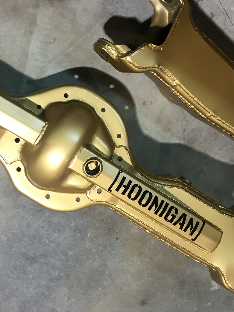

Ive been having a painting party all week lol, the housing is just spray painted with gold high temp engine enamel. The hubs, knuckles, calipers, dust shields, third member, and all the misc. parts are all flat black. I thought about powdercoating the housing and radius arms but they will both at some point have welding done on them and they will get rock chips and scrapes and ill be able to easily and quickly touch everything up with rattle cans.
After spending a small fortune over the years having motorcycle frames and wheels powdercoated ive learned that paint is better in almost ever way in m opinion. Its waay cheaper, i can do it myself, its easier to touch up, and depending on what you put down under the paint and what clear you use it can be just as strong as a lot of powdercoat jobs.
