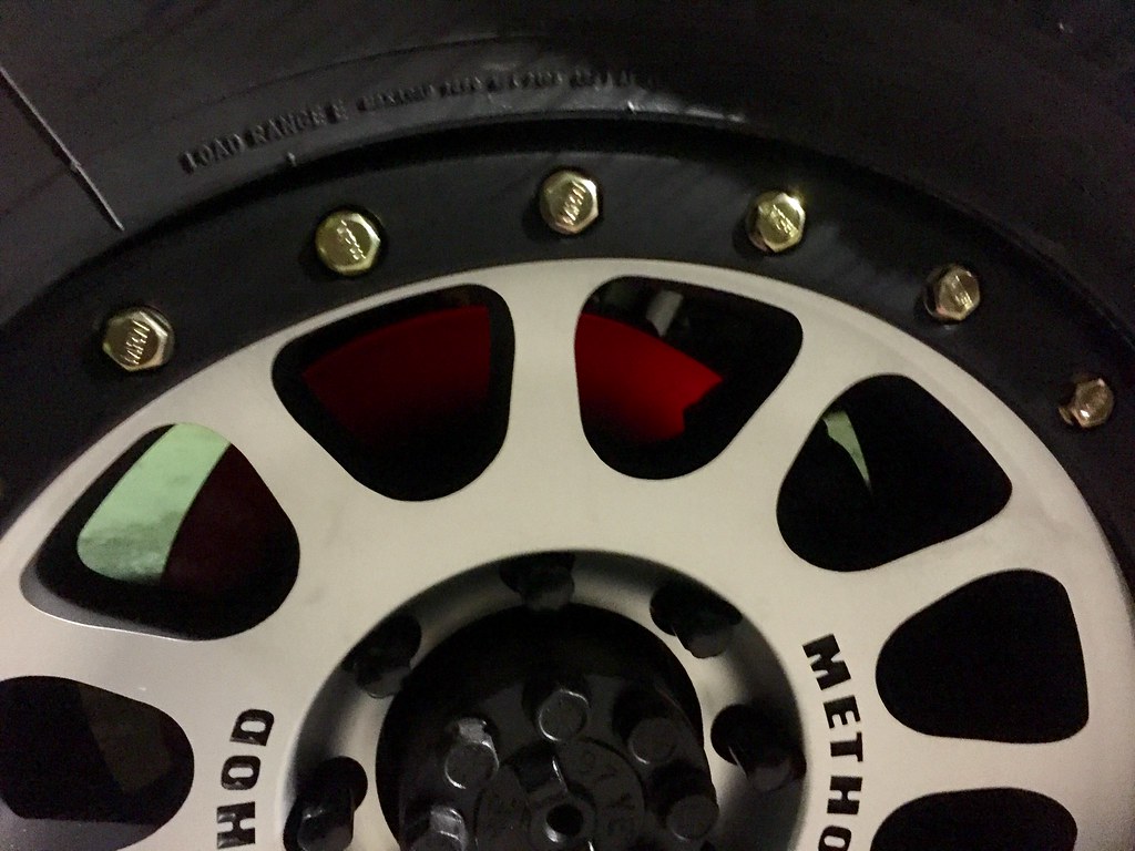

Finishing up the front brakelines today and hopefully get it aligned on Monday. I just measured and the front track width is 90" from outside of tire to outside of tire 😁
Just cheapies for now, getting the 14 bolt and new tcase under the truck are next up on the to-do list. Once the axles are both under the truck I'll decide if I'm gonna step up to coilovers or just make mounts and run king shocks.

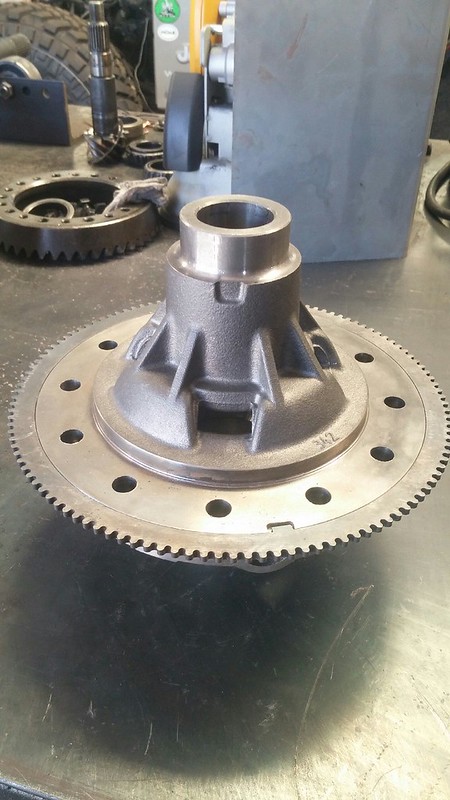

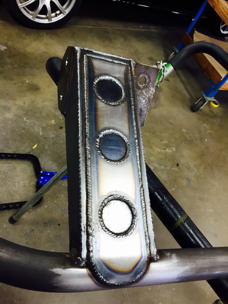

Theres about to finally be some more progress getting done on the truck, Jon cuervo welded up the tubes on my 14 bolt and got the 13 bolt shave done using a crane cover. We have also been trying to figure out the best way to get a tone ring in/on the rear end. I think we came up with a really good solution...with a little turning done on the lathe and a keyway milled into the carrier i now have a tone ring ready to run inside the 14bolt.

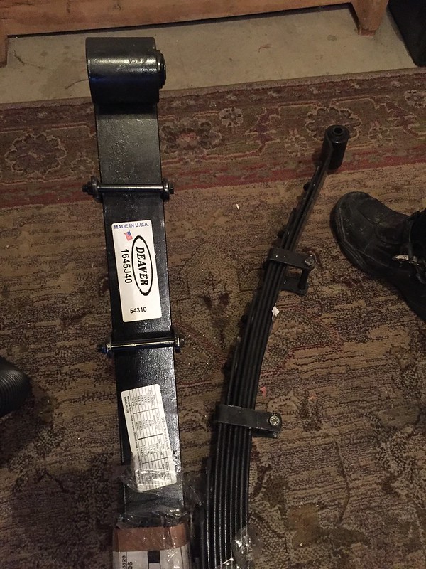

And along with new front and rear leaf spring frame hangers from ford and new lower rear shock mounts, this stuff showed up...

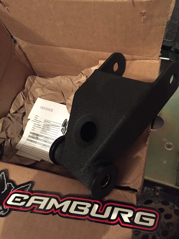

Longer shackles from camburg and a pair of j40 packs from deaver to get a little bit of wheel travel out of the rear!
Mmmmm camburg.

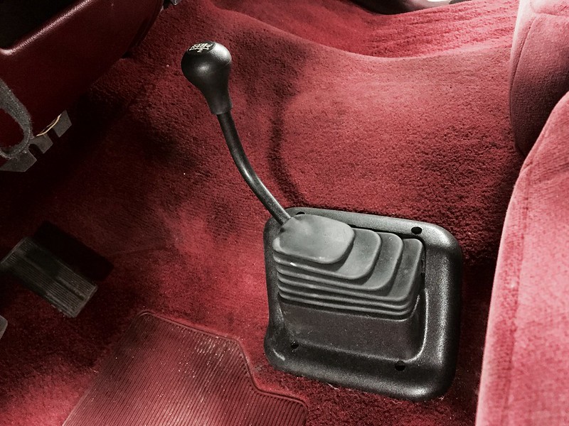

My truck didnt make it into the shop this last weekend so i made a trip to the upull and pay. I found a floor mounted tcase shifter with a good boot and knob and i also found a good hood!

I havent gotten much done letely, but I found a little time to work on the truck today. The original Tcase had a slip yoke and an electric solenoid to shift into 4wd, i opted to swap to a manual shift tcase with a fixed yoke when i put in the 14 bolt. I finally got around to installing the shifter bracket, shifter, and linkage today. First off i cut the hole in the floor, then moved onto the linkage...which didnt fit.
The tcase came out of a diesel truck so im guessing thats why the linkage i got ended up being 2" too short. I had to cut the linkage and add a piece of strap steel to lengthen it....but the length of the shift arm on the tcase must have also been a different length then the truck i snagged the shifter/linkage off of.
Becasue of the arm/throw on the tcase most of the dentents/shift gate positions on the shifter bracket ended up being slightly off so i filed them off. Got everything back together and it all works perfectly and as a bonus(?) i dont have to push the mechanism on the shifter down to shift into 4-low.
