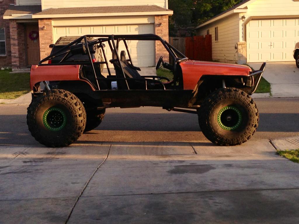

finally been getting to work on this thing... got rid of the coils up front in favor of some radflo 2.5 14" travel air shocks...
started the cage work today... this is where we stopped today, we're getting a fresh start in the morning so i'll have more progress and pics tomorrow...
I'm no structural gynecologist either, but that cage looks safe enough for me.
Not sure where the unecessary tubes are in that pic. If we are discussing the door area then I imagine the rig is running doorless and those tubes are for passenger protection, not structural integrity? Everything looks like it needs to be there to this untrained eye.

man its been a while, this thing is almost done
since the update it has gotten a lot of loving. 4.7 stroker, detroits front and rear, full hydro, 5.38s, 2.5" 14" travel radflo airshocks up front, ford 57" springs out back with FOA reservoir shocks, tmr shave kit and artec truss on the 14 bolt, chromo 35 spline inner and outer shafts up front with drive flanges, tons of other stuff that would take me forever to list... what do ya'll think?
It lives!!! Looks great. Love the simple looking suspension up front with the airshocks, but I bet they're not valved well for normal street driving?

they are tuned by downsouth motorsports specific to my application, and tuned for crawling. also rocking radflo nitrogen charged bumpstops up front for the go fast
