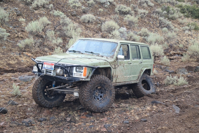

I did get stuck in a Flash flood in mine water coming in the doors dodgeing trees and root balls moving down the stream. was a creek that normaly was 10ft wide. During the flood it was 80-100 feet and ripping one of the scariest off road moments ive had. Somehow it turned out.
The trail through there is now gone and the creek has changed alot tree and root ball damns.
Picture all 3 of us in my jeep dead silent bobbing down the creek. Wed had just abanded a utv deciding the jeep was our best option.
The next day we went back for the utv winched in and winched out the creek was small again but the trail gone. I broke a front axle, driver knuckle and ruined a tire.
This kicked off steering and axle Upgrades
In this photo its still drivable but only one front and one rear is putting power down shortly after this photo I somehow broke a knuckle winching
