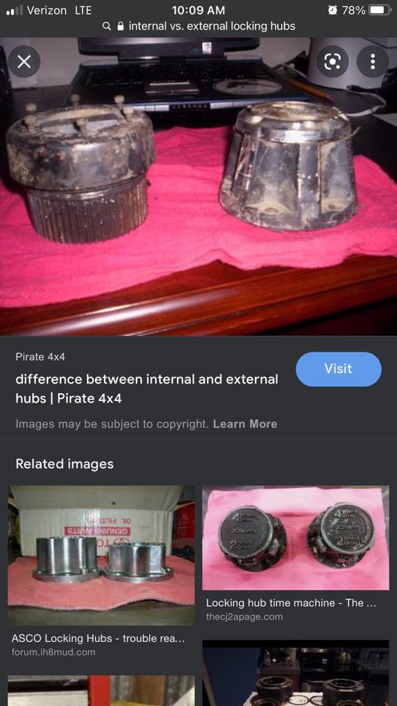

I don't think mine are "internal" locking hubs, which is why I question it. Mine has the manual lockouts which require you to get out and physically turn the lock, to lock the hubs in.

Internal vs external refer to the style of hubs and how they interact with the stub axle.

Thanks a lot. I've got a better understanding of internal vs external now. Mine is indeed internal.

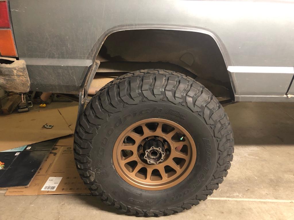

I really like those method wheels, they look good. What size are your tires?
I'm currently leaning towards the BDS long arm lift, they say the 6.5" will clear 33's and the 8.5" will clear 35's (both state *trimming may be required*). I'm debating which to go with. I'm leaning towards the 6.5" for the low center of gravity. At the same time, I don't want to be rubbing every time I flex a little bit. I'm planning on some aggressive trimming, but Im trying to stay away from a full comp cut for now. I'm hoping I can get away with it using full width axles.
