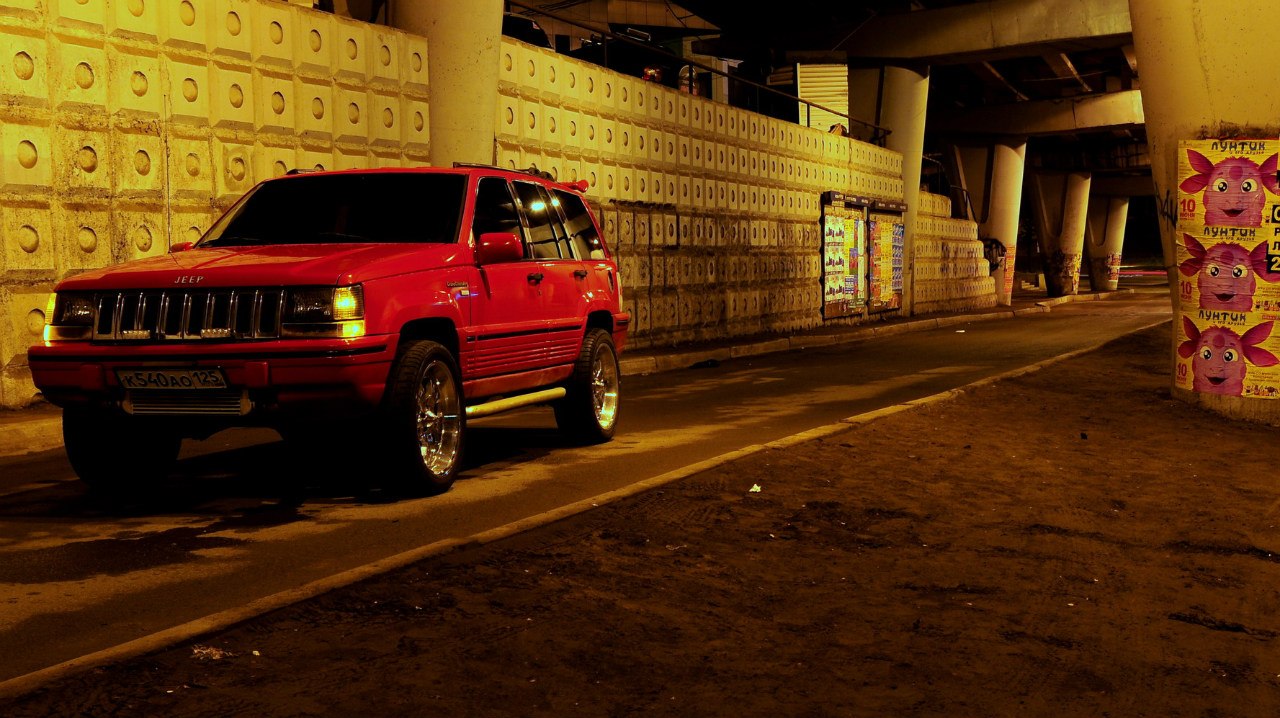

Love love love. I gotta say I feel your Jeep is clean and crisp and those things are important to people like me. GOOD JOB MAN. How's the idle situation Burik?
